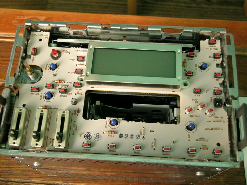

In case some of you haven't figured out how to remove the circuit board from the radio...

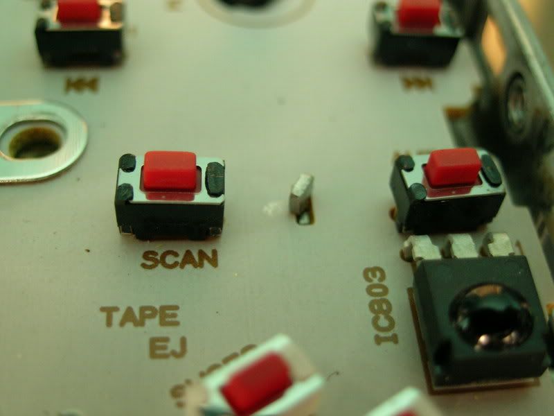

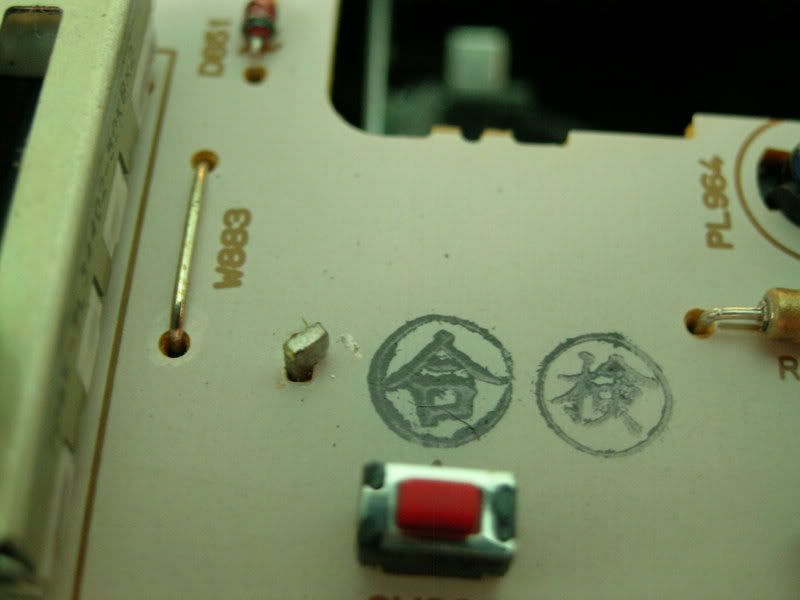

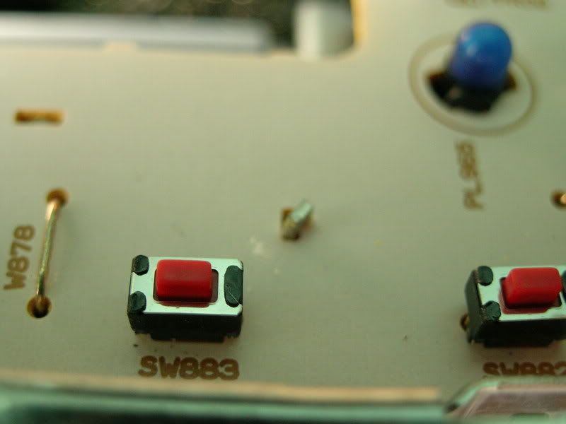

There are metal tabs that lock it in place. Use a small plier to bend them straight so they come out. Also remove the two screws on the sides of the LCD screen.
There are four metal tabs:
Also I did confirm that the lamps from Mouser Electronics do work. They are exactly the same and is a direct replacement.
The part number is 560-CNW123 and its less than a dollar (like $0.75 each if I remember).
Also if you lose the blue bulb gels, its also sold at Mouser (mouser.com), the part number is 560-39025A and you will have to trim it slightly to make it fit (too long).
If you're also making a order for these lamps, the indicator lamps for the instrument clusters are part number 560-WWT1EW10 , this part does require some small modification to the pins (just need to press them more 'square' with a plier prior to insertion). Again, its also very cheap here.
