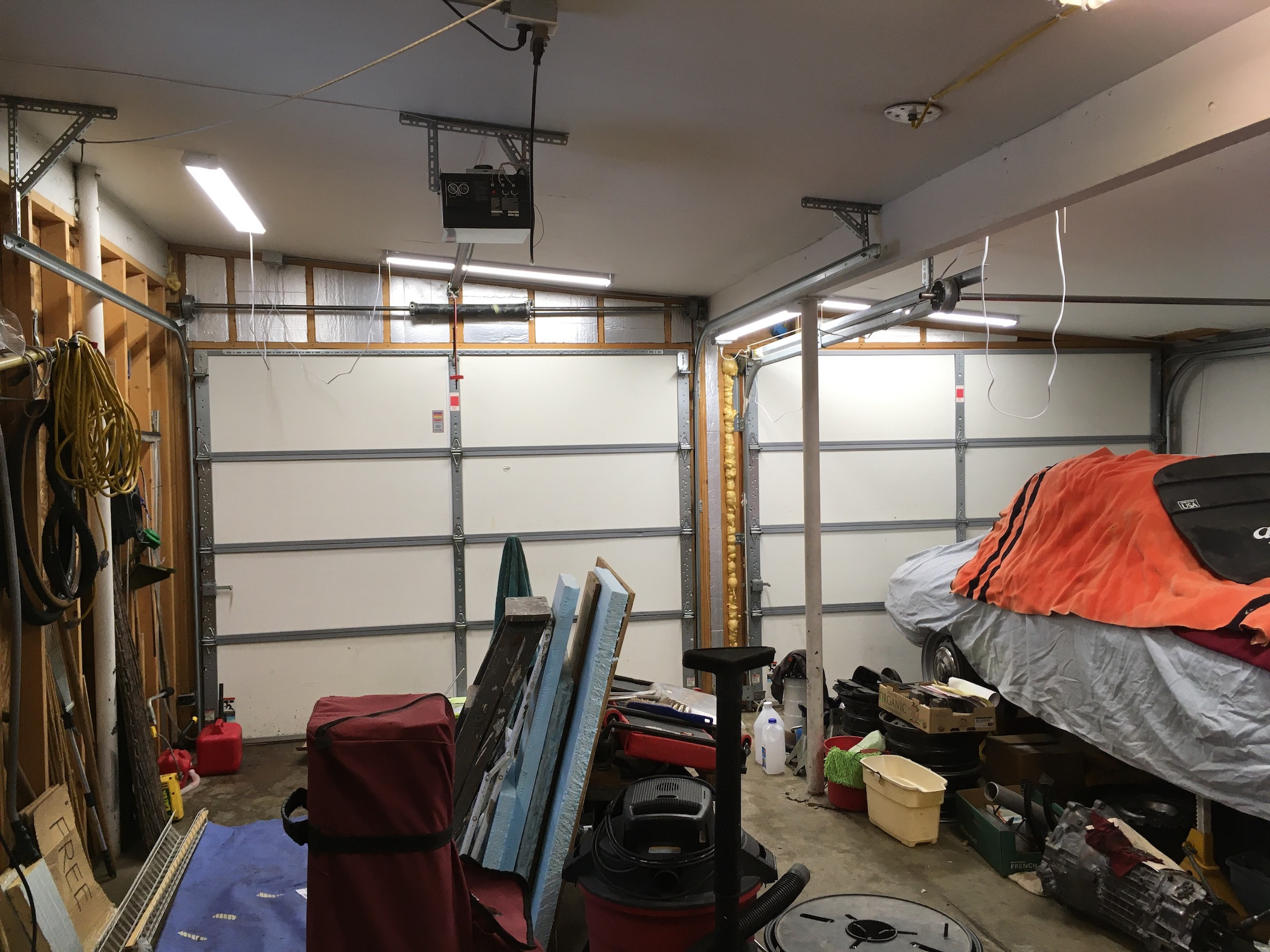

"... the $28 Costco 42W LED with good color and many good reviews"
Color temp control by any chance? Color temperature is something I'd want. It's in many LED applications today, not just photographic. It can affect mood, vision...

Yep, exactly. I hunted and hunted. VERY few "shop" lights with warm color temperature. No adjustability. These are 4000º, which is as high as I was willing to go. But they seem to be a bright and neutral white. I hate 5000º and up lamps, cold lighting, nasty fluorescents, blue headlights, etc... This is bright task lighting, and I'm ok with it. It actually looks good next to the warmer fluorescents already in there. When those bulbs quit I'll get the conversion kit, which snips the ballast and replaces the lamp holders at the ends.

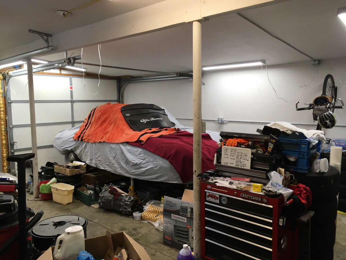

We decided not to cut the cords and hard-wire the lights. We put outlet boxes near them and plugged them in. You can change lights, you can move lights. I'll tie up the cords and staple to the ceiling (plywood). It's so bright in here, it's like night and day (ha!).

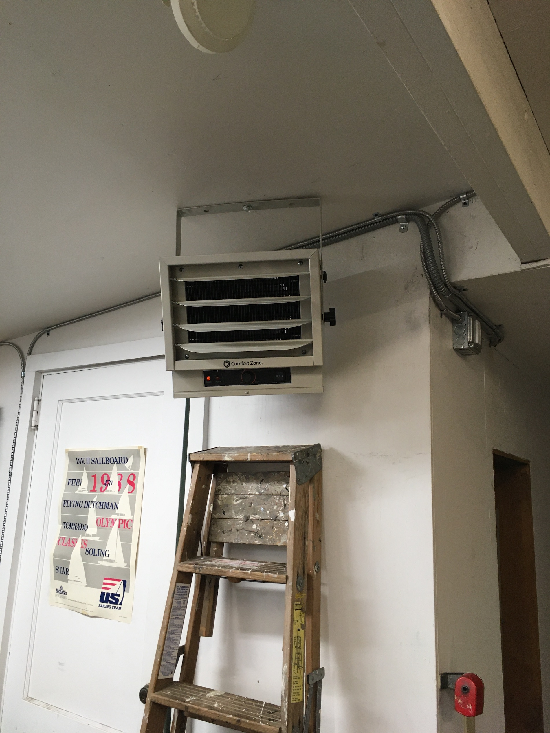

5000 watts of Blazing Heat! Actually, the Very Good Electrician was bundled up for cold and turned it way down. Only ran a few minutes. I didn't feel like it was that hot coming out the front. I put it on 5000w, turned up the thermostat, and let it run a while and the air coming out got much hotter. With insulation, I think it'll be fine. Interesting how long the slab stays cold, which is where you're laying most of the time.

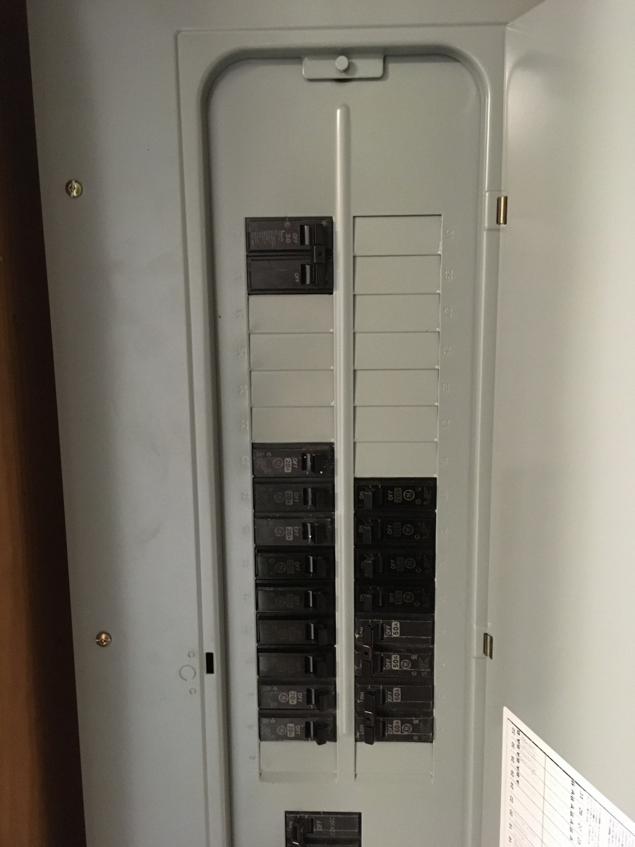

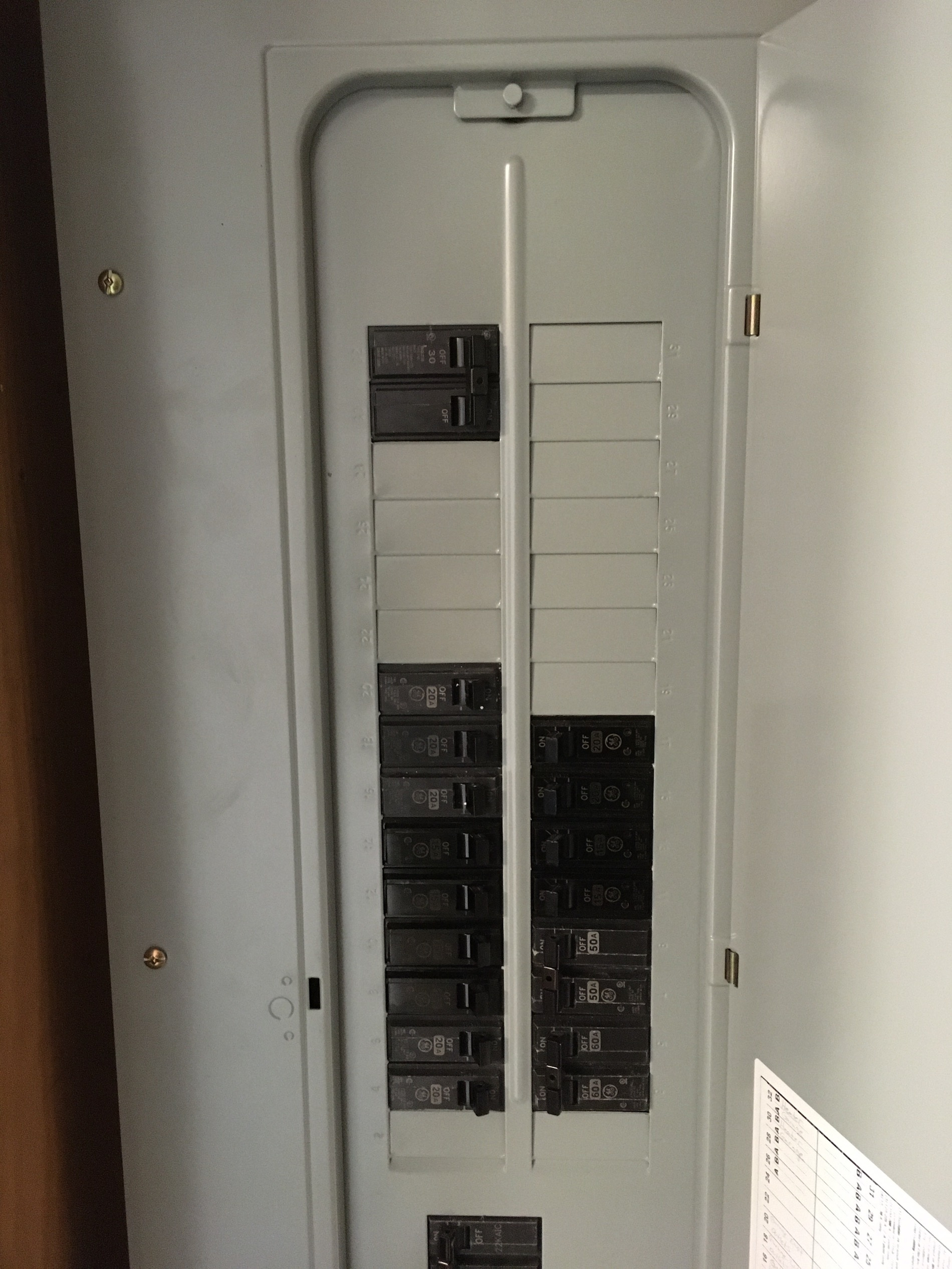

Nice 30A double breaker at the top left. Easy to find so you can shut the whole system off. Below that two 20A outlet circuits for left and right sides, and a lighting circuit. Armored flex cable everywhere. We tore out some sketchy-looking wiring from the 50s in my tool closet, relocated some outlets, replaced any old ones. Inspector comes tomorrow.

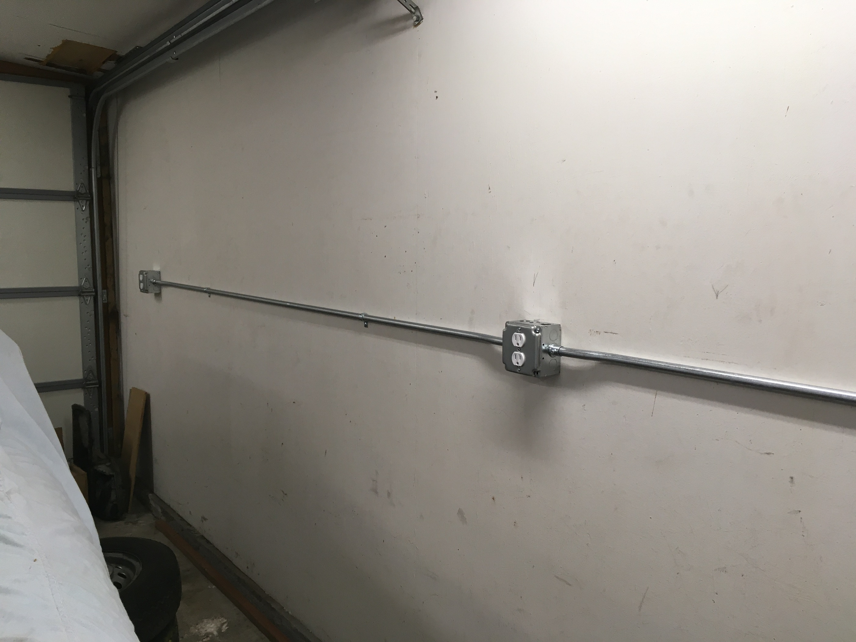

Power where I want it! No more extension cords all over the floor and under the car! I put them up at 48" so I can see them and they're out of the clutter and wet. Shelves and lumber racks will go above. Now it needs insulation, badly!
