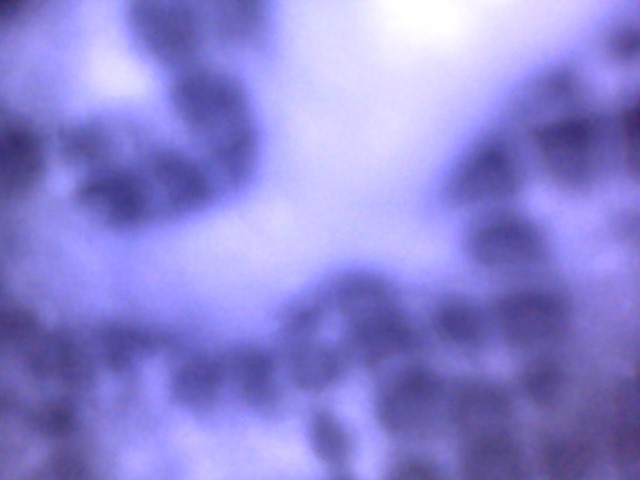

Took the Exhaust manifolds to to a local muffler shop to have the broken flange studs removed. The shop owner told me he was concerned with the back side converter because small pieces of debris fell out as he was working on it.
Took a look with a Endoscope. Can see some damage the question is how much.
Debating whether to roll the dice or work out a plan B.
