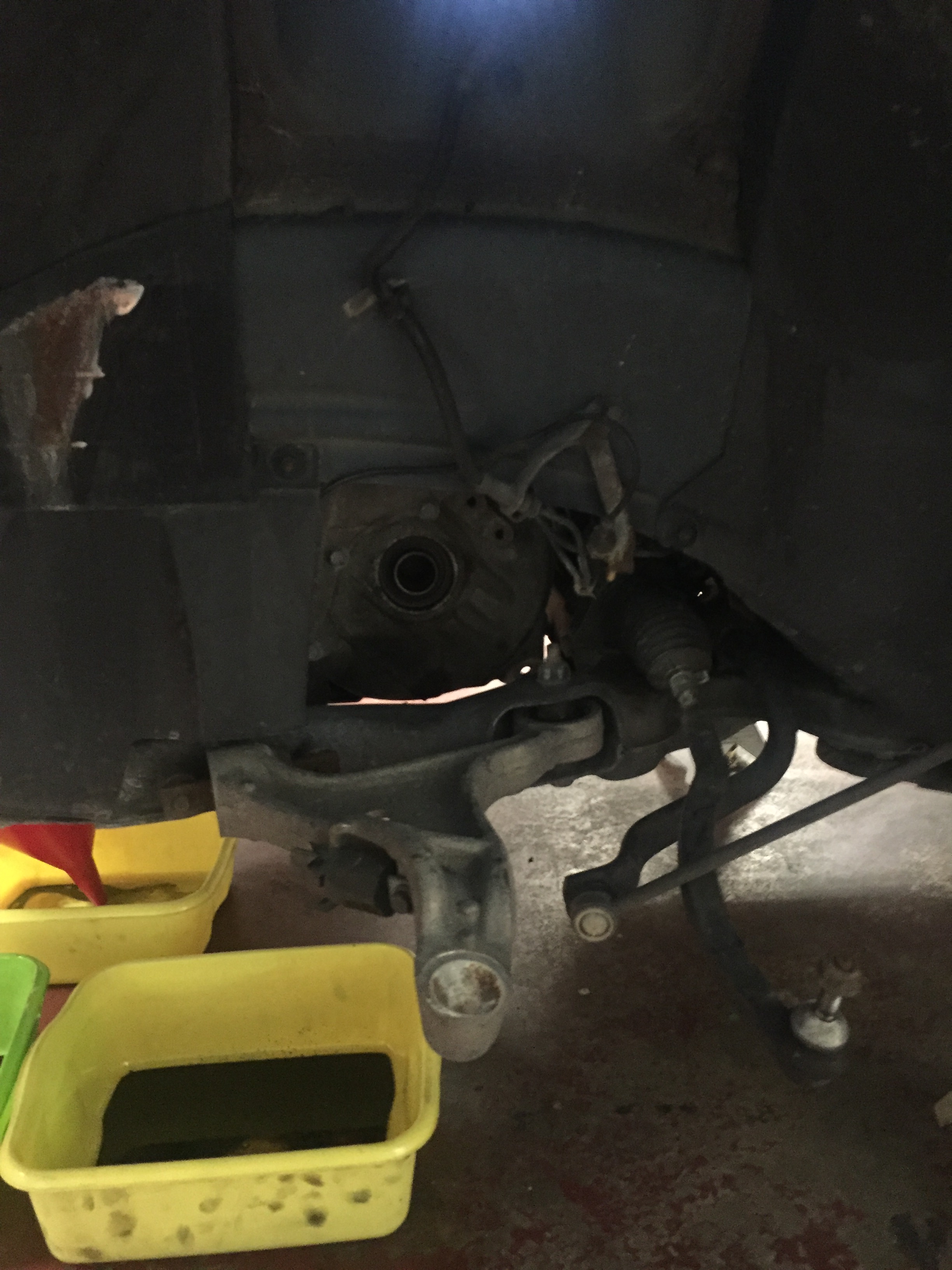

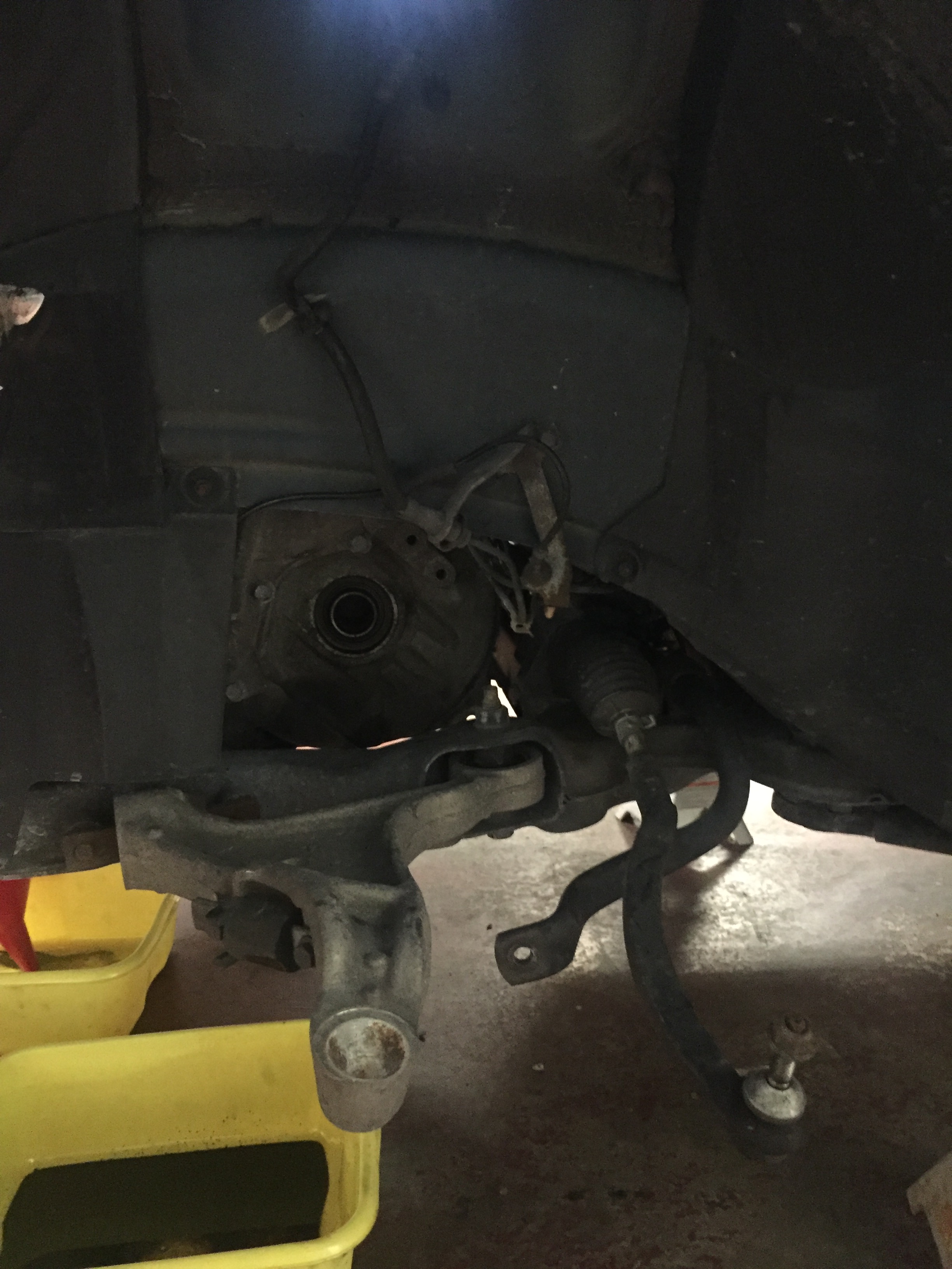

Step 36: Remove spindle
Step 36 Remove spindle
Step 36 Remove spindle.JPG (1.38 MiB) Viewed 2604 times

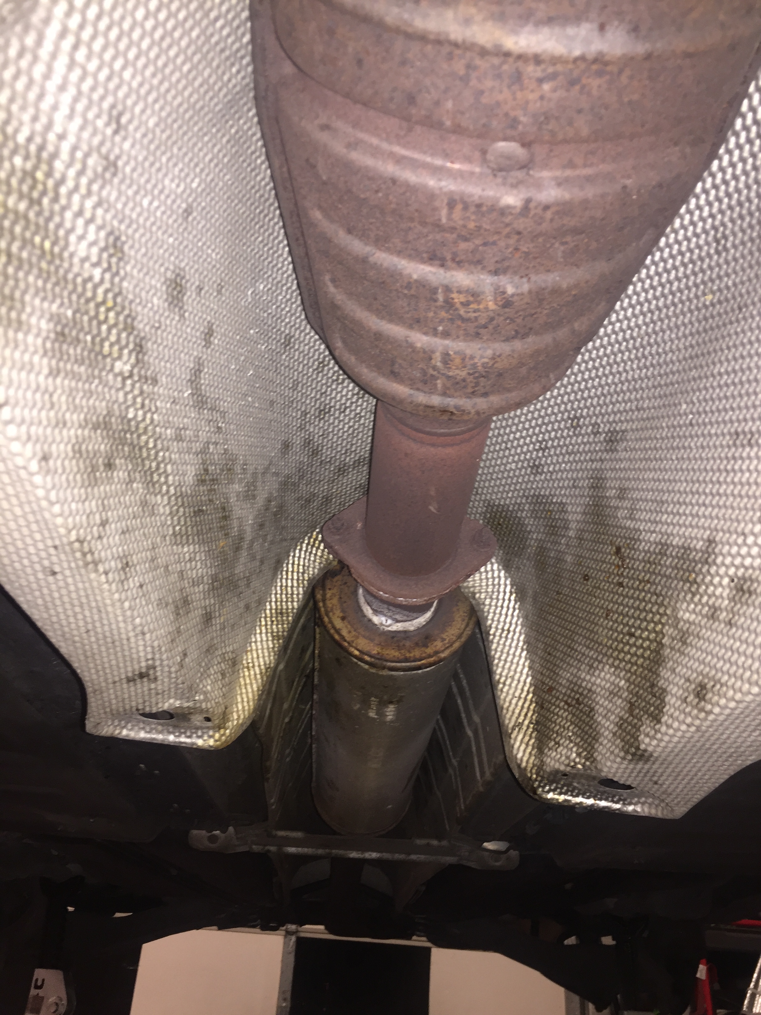

Post by 01_Nautic_V70 »

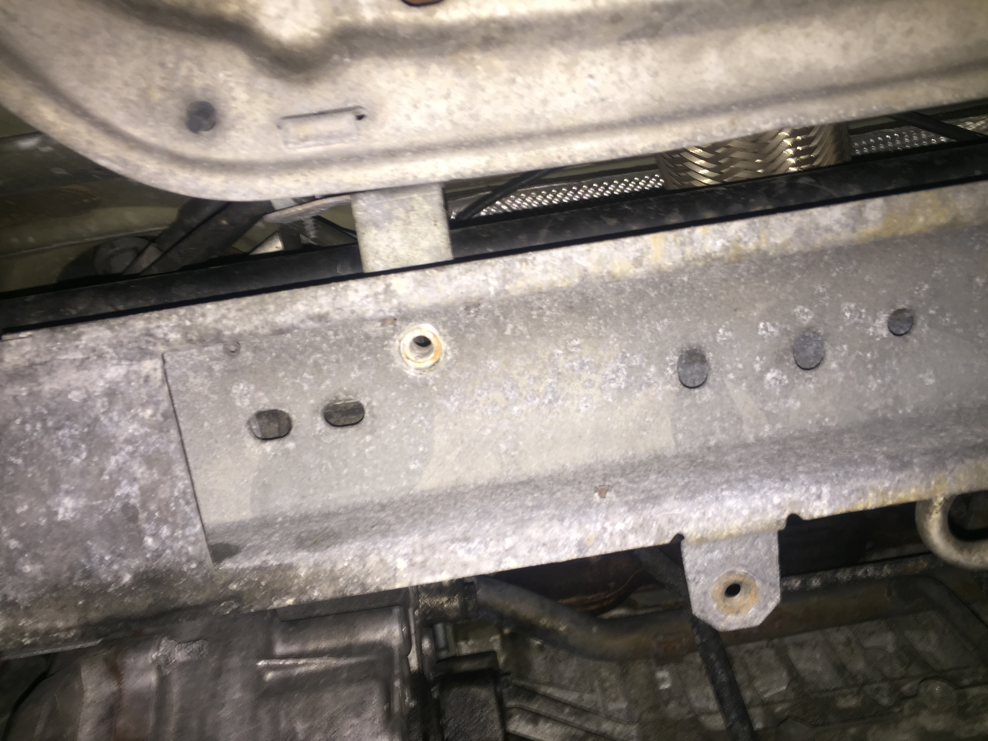

Step 41: Remove intermediate exhaust plate
Step 41 Remove intermediate exhaust plate
Step 41 Remove intermediate exhaust cover.JPG (2.16 MiB) Viewed 2598 times

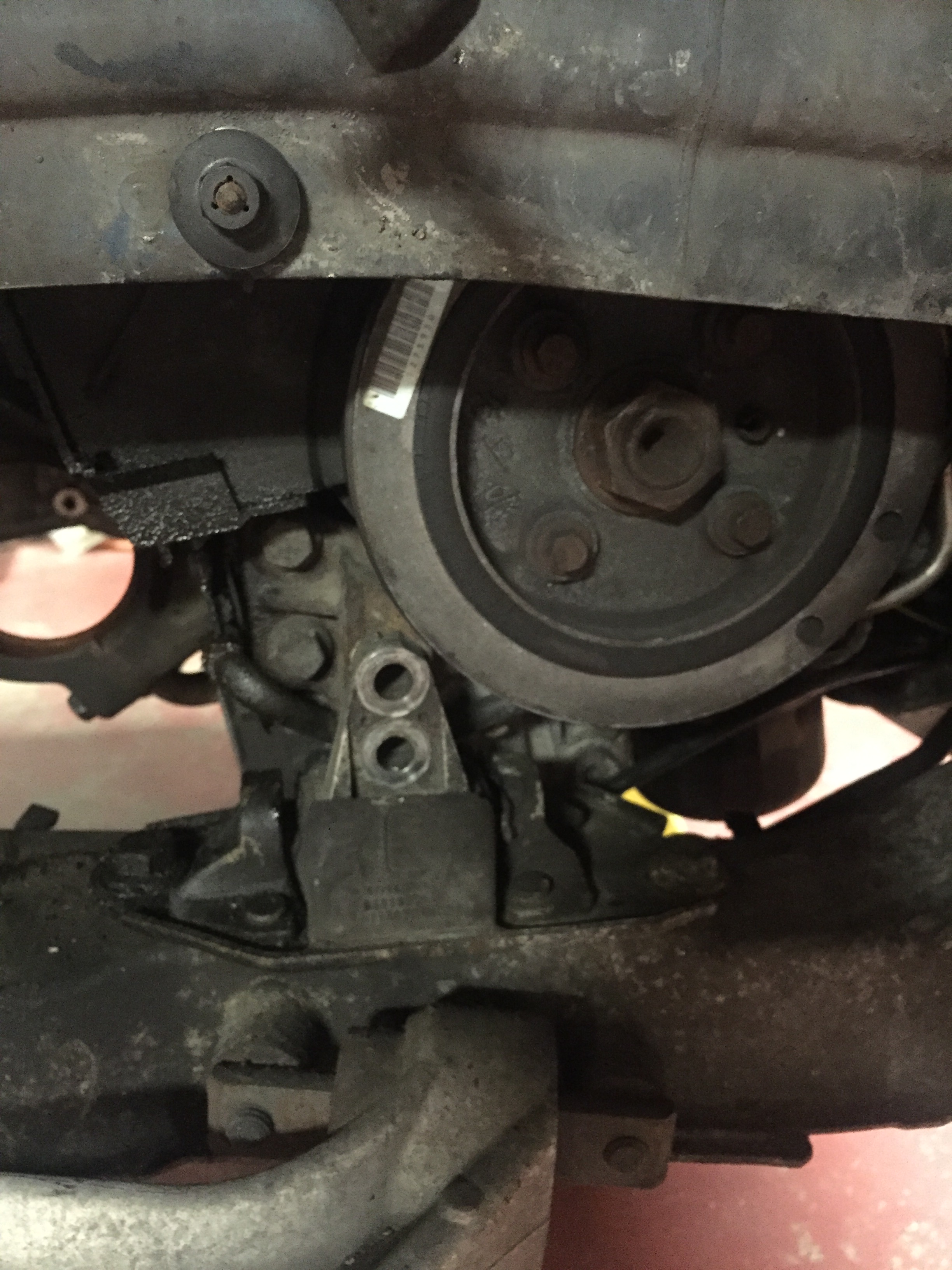

01_Nautic_V70
Posts: 218
Joined: 27 October 2015
Year and Model: 2008 XC90 V8
Location: Illinois
Been thanked: 8 times

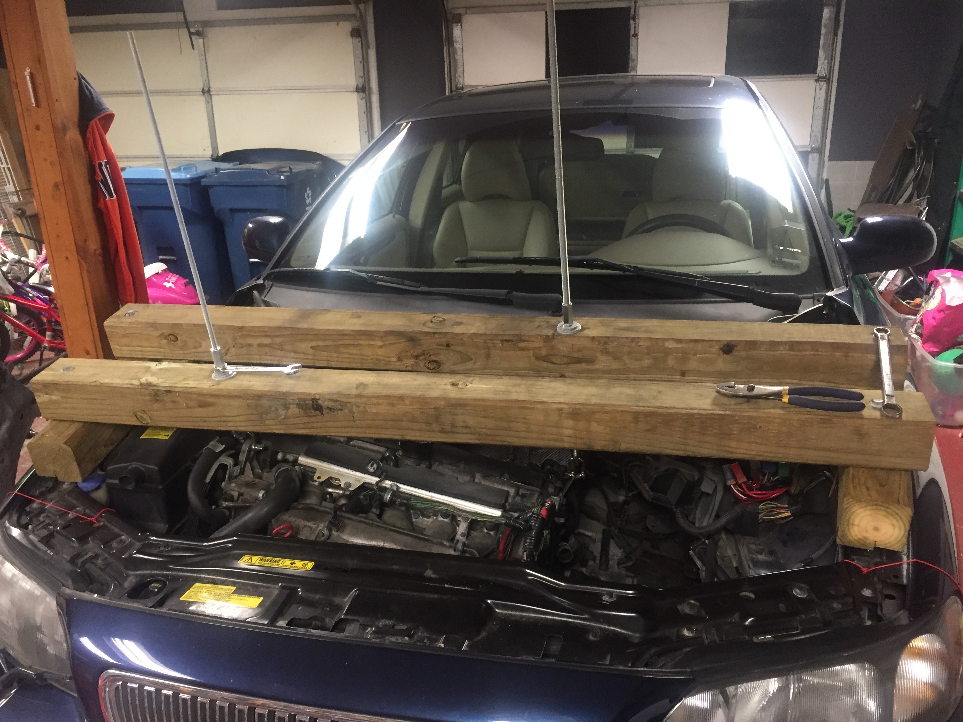

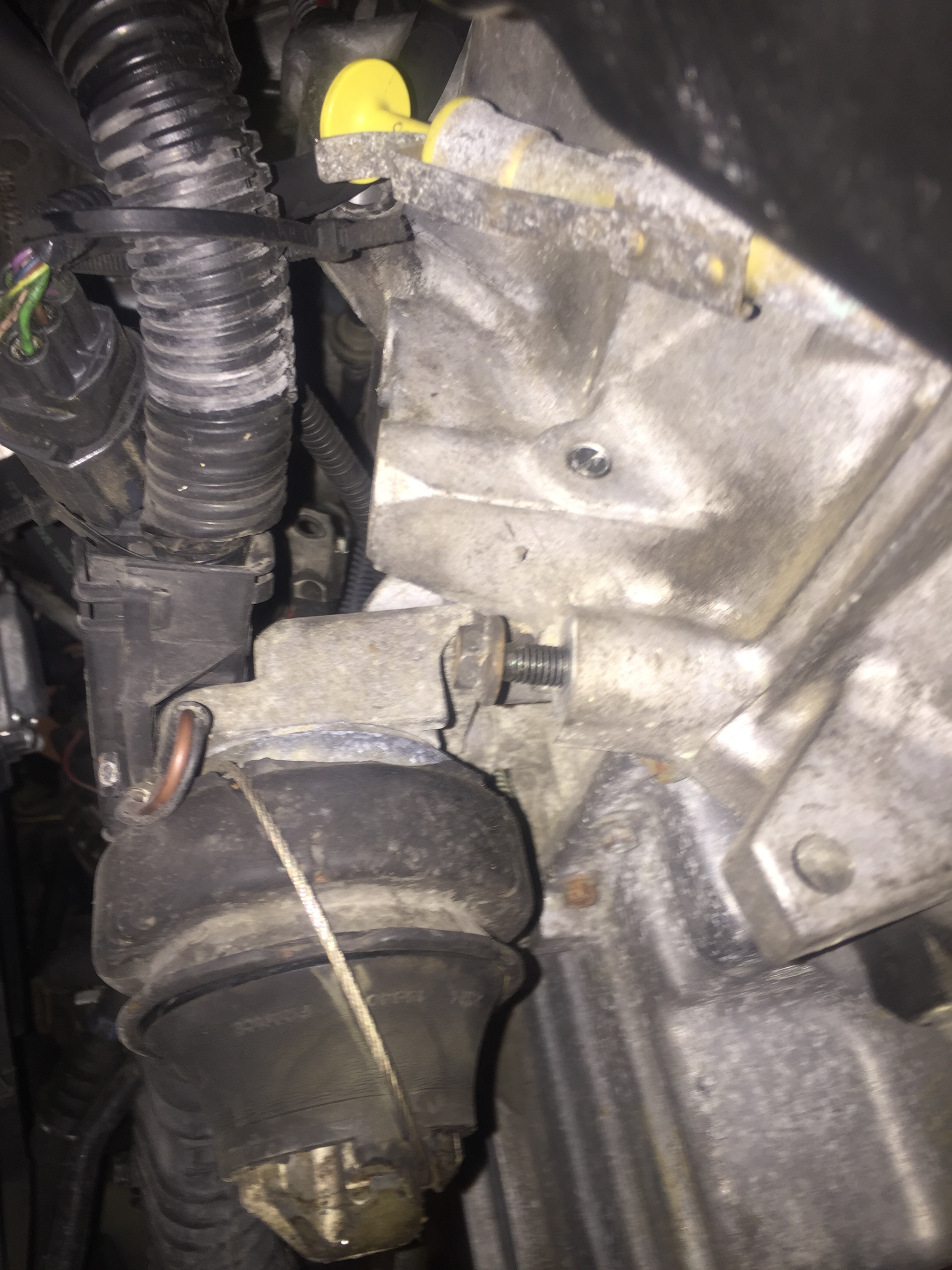

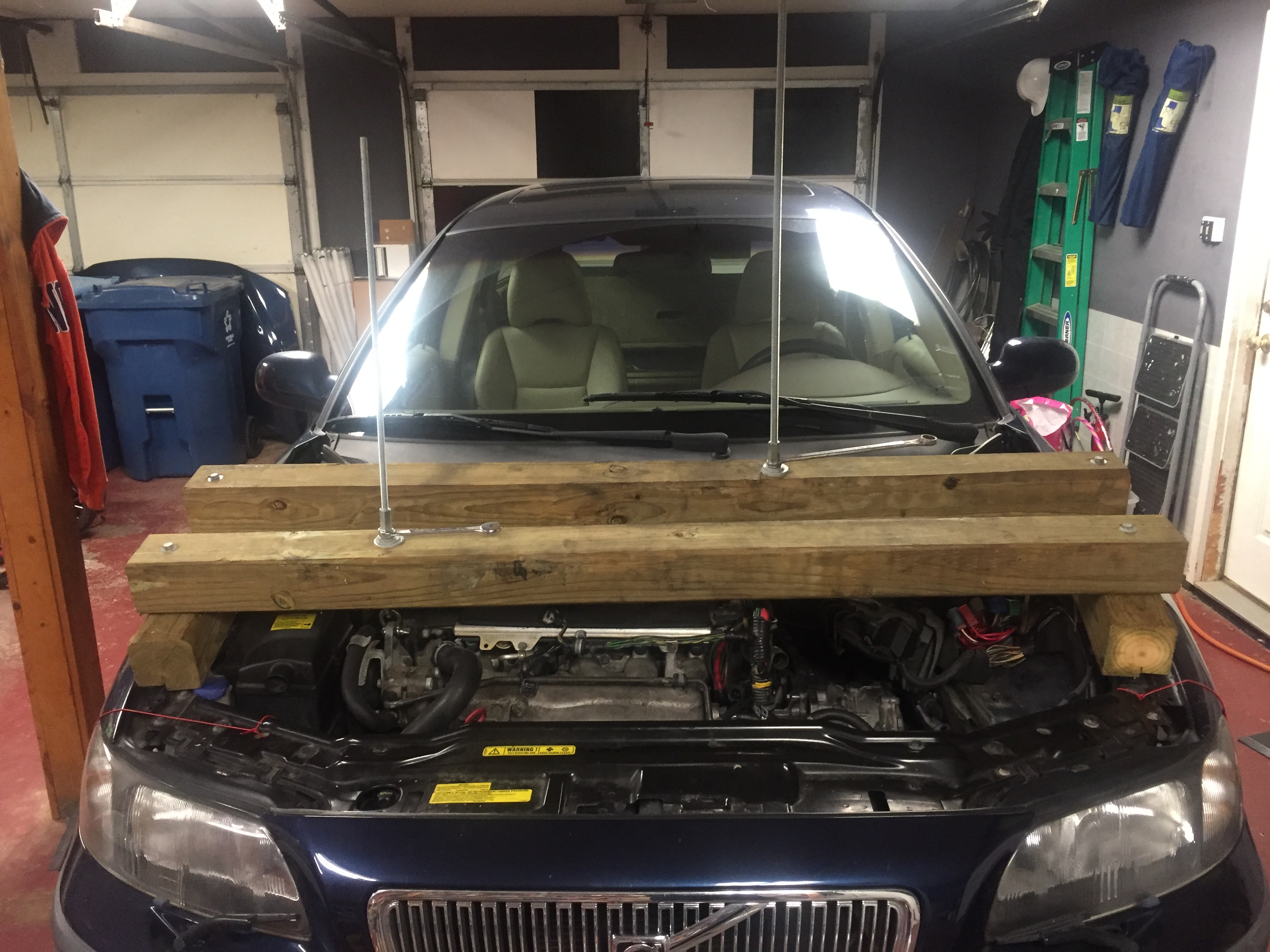

Step 45: Install a bridge or lifting device to tilt the engine out of the way
Step 45 Install bridge
Step 45 Install bridge.JPG (1.36 MiB) Viewed 2439 times

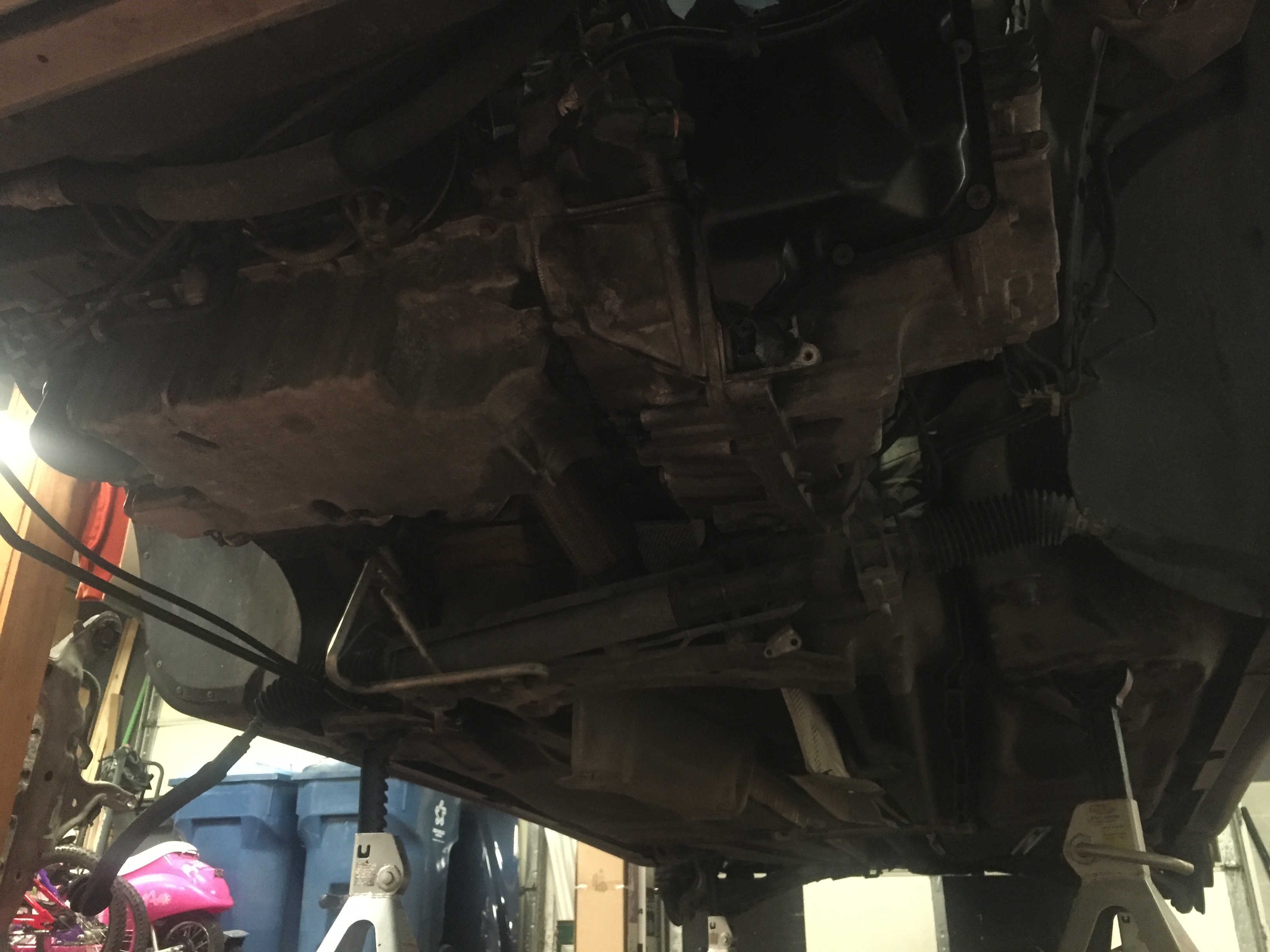

Step 46: Remove subframe from under car
Step 46 Remove subframe
Step 46 Remove subframe.JPG (1.04 MiB) Viewed 2439 times

Step 48: Remove rear engine mount from transmission
Step 48 Remove rear engine mount
Step 48 Remove rear engine mount.JPG (2.33 MiB) Viewed 2439 times

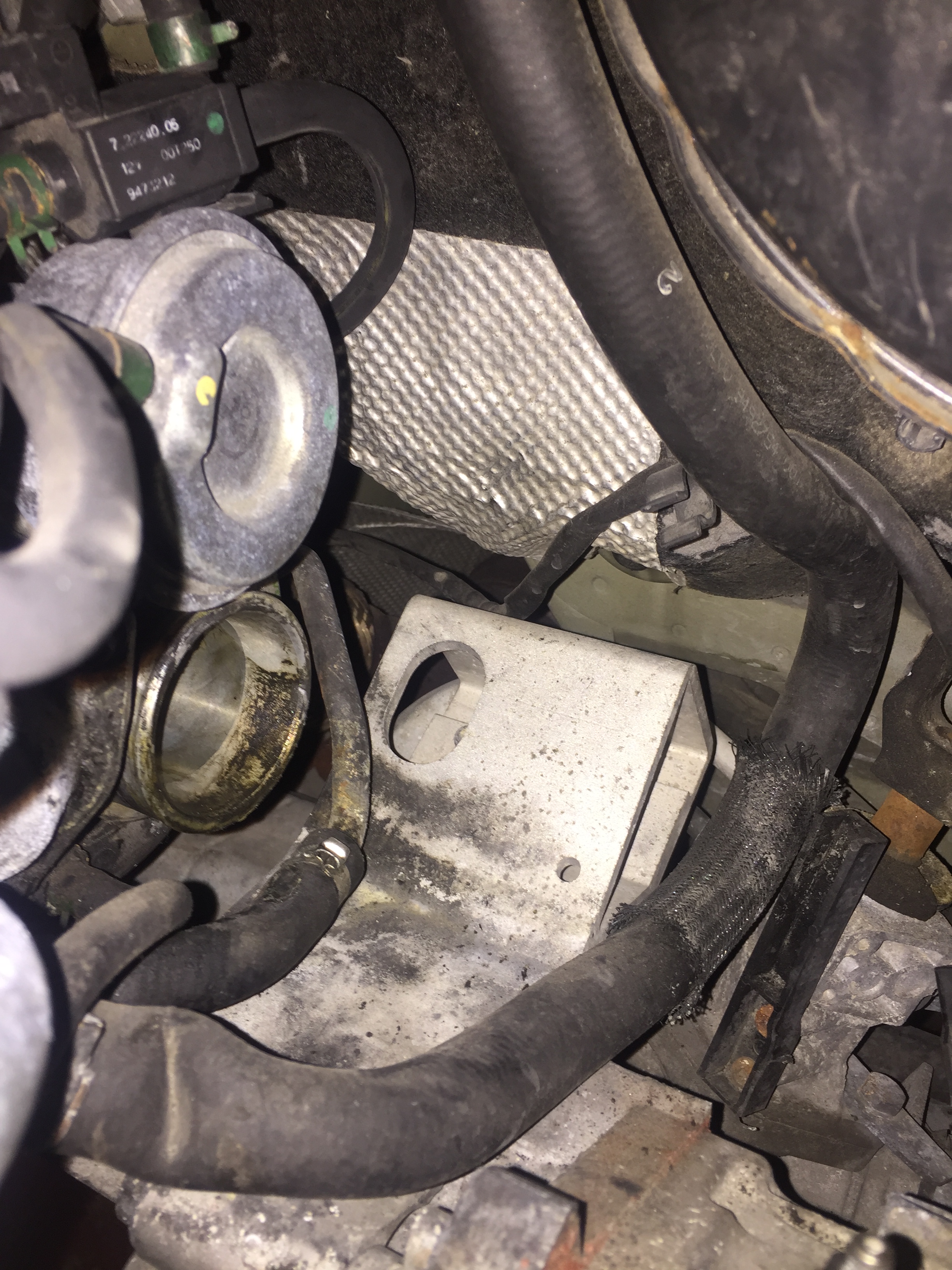

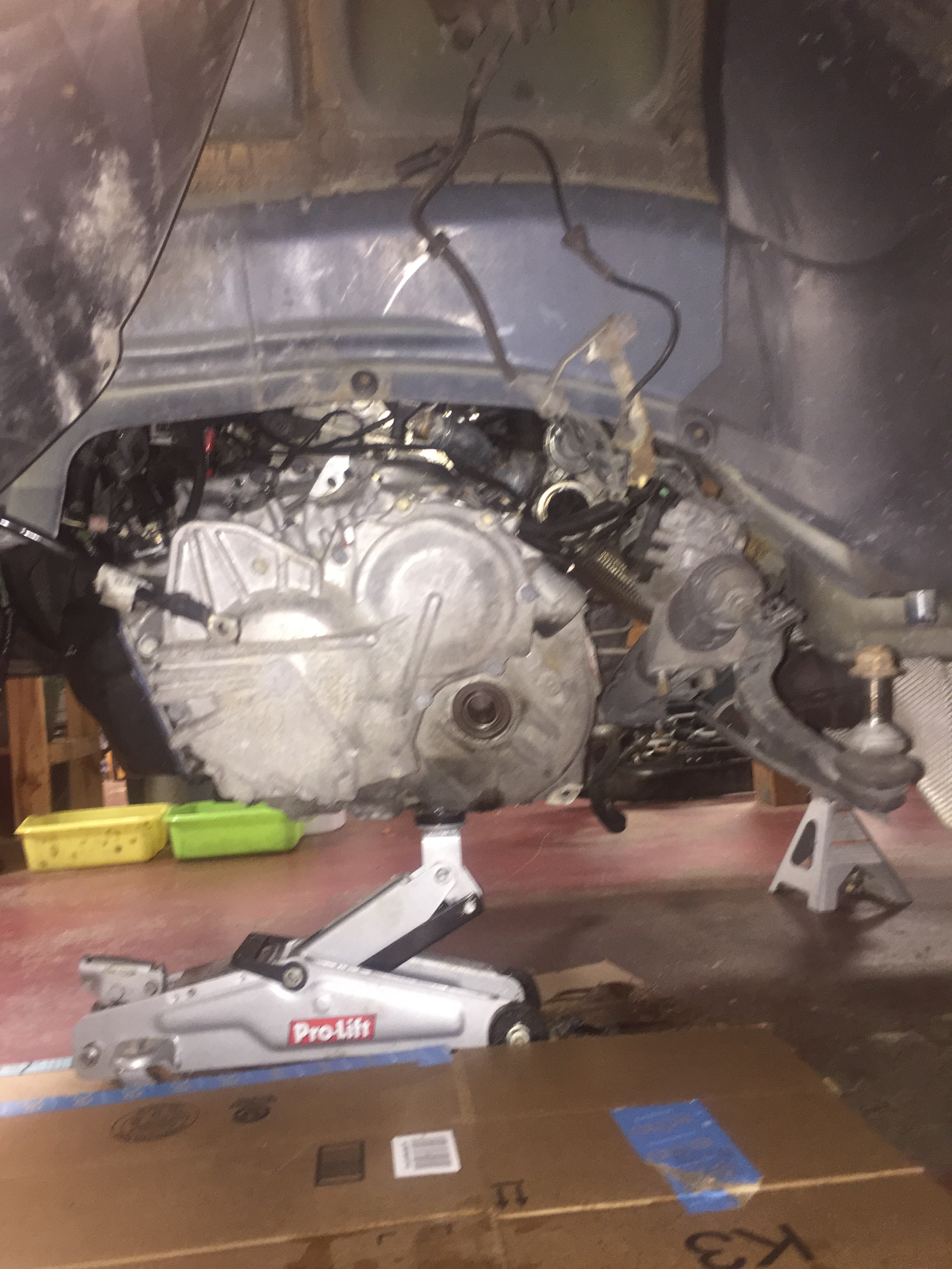

Step 50: Lower rear of engine until transmission will clear fender liner as removed
Step 50 Lower rear of engine until transmission will clear fender liner as removed
Step 50 Lower transmission to clear fender well.JPG (2.12 MiB) Viewed 2439 times

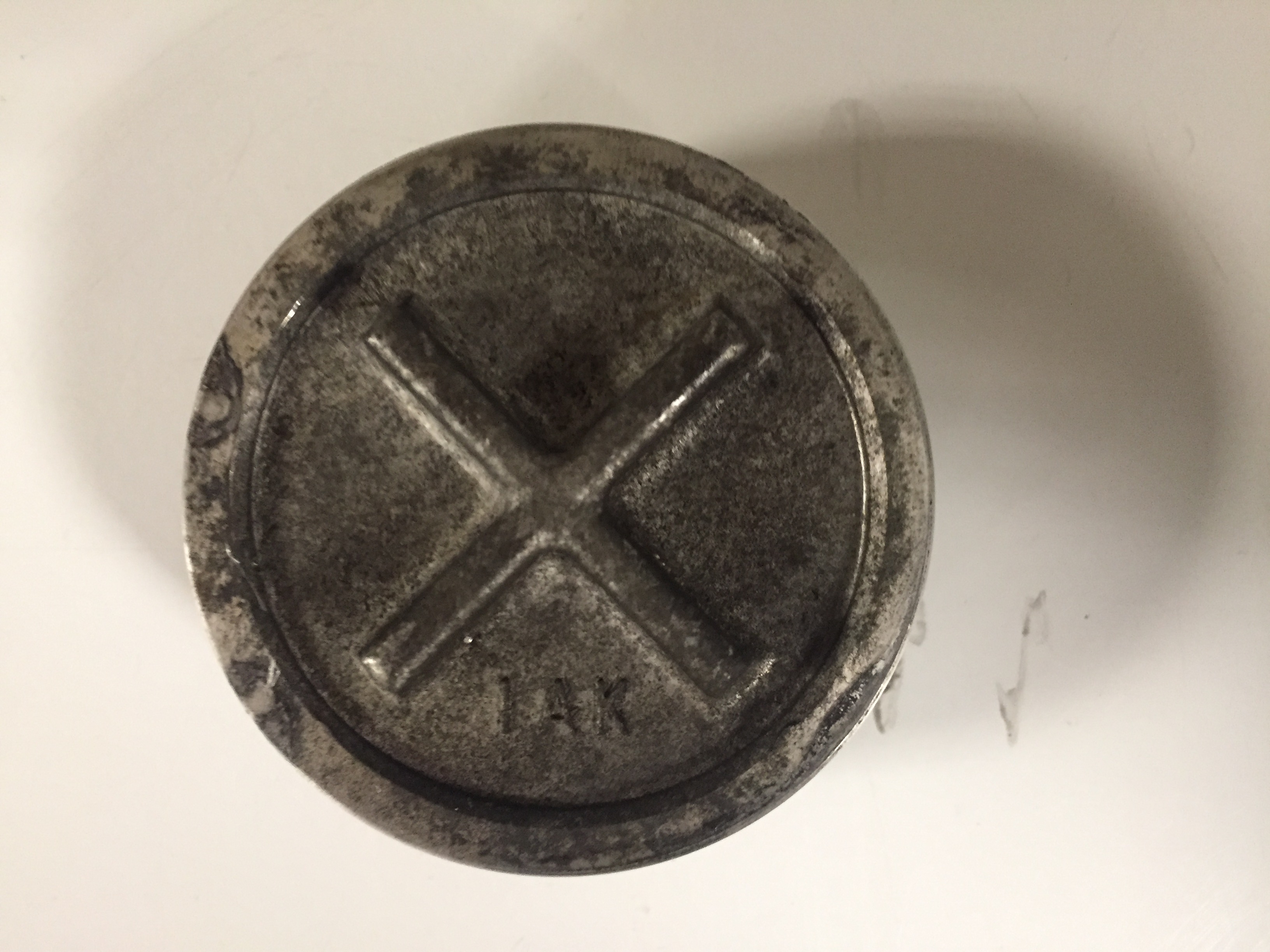

Step 51: Remove transmission
Step 51 Remove transmission
Step 51 Remove transmission.JPG (1.37 MiB) Viewed 2434 times

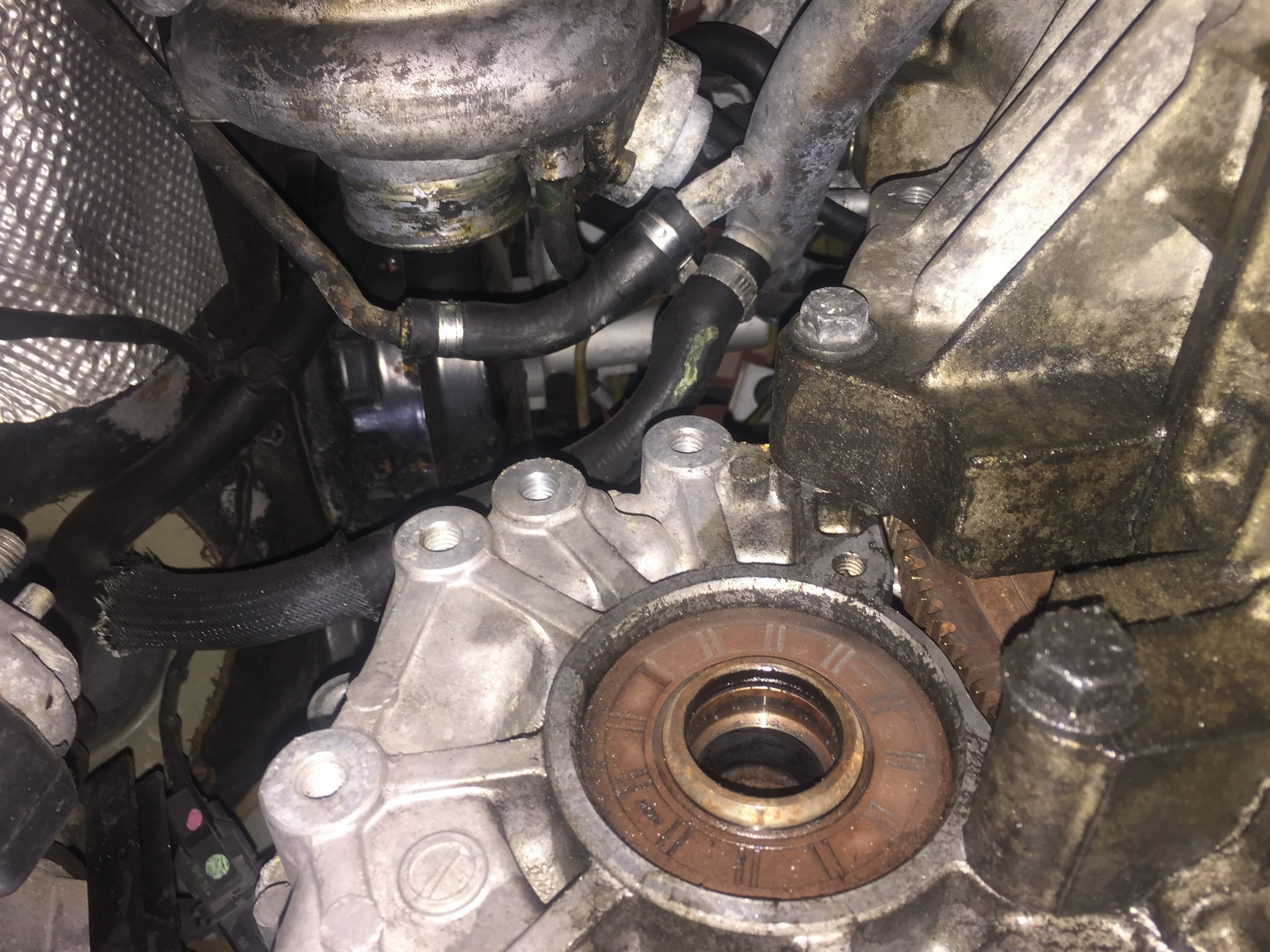

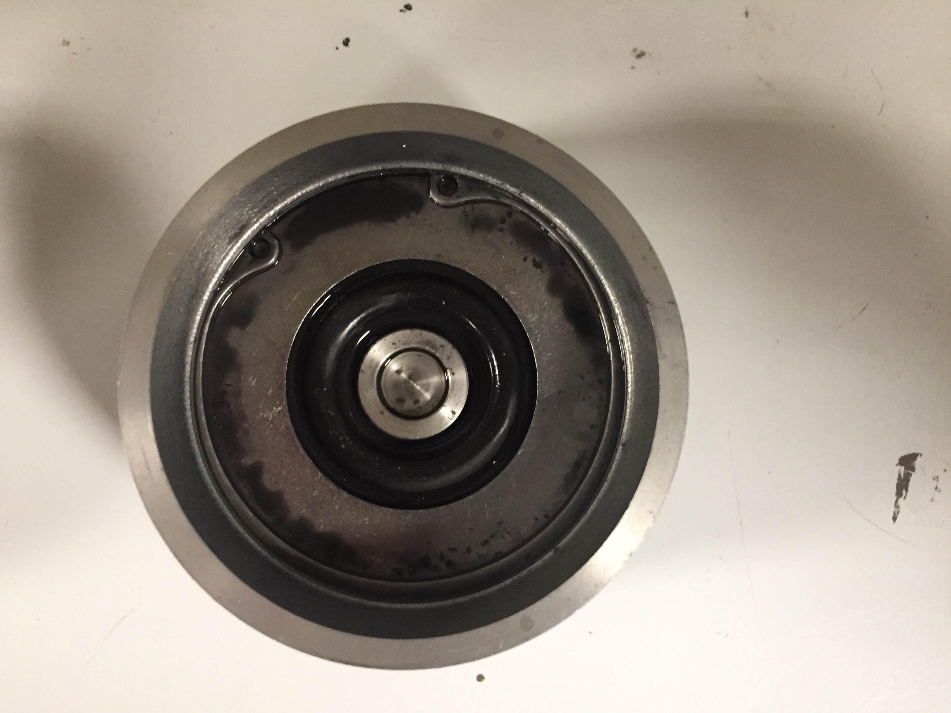

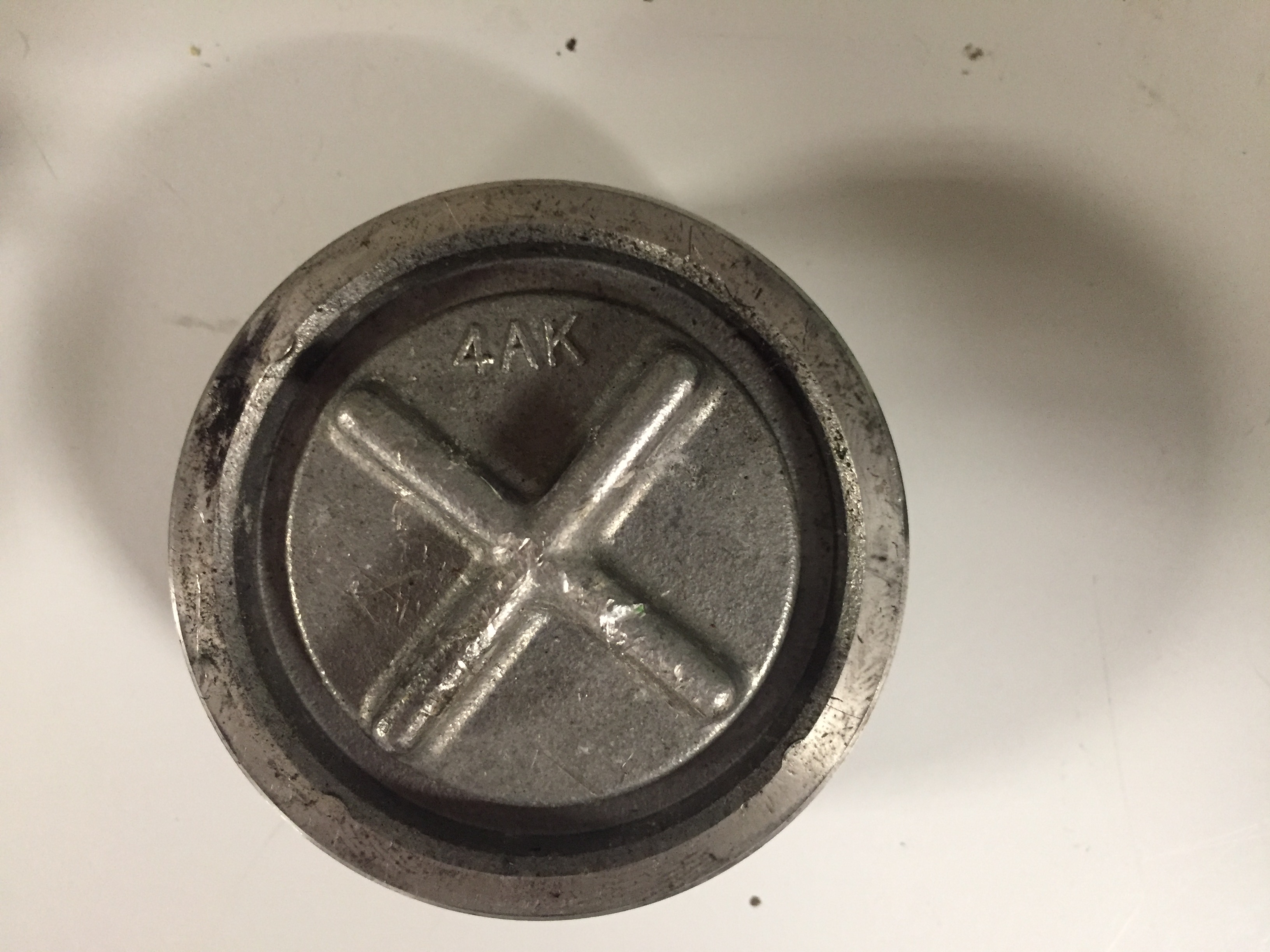

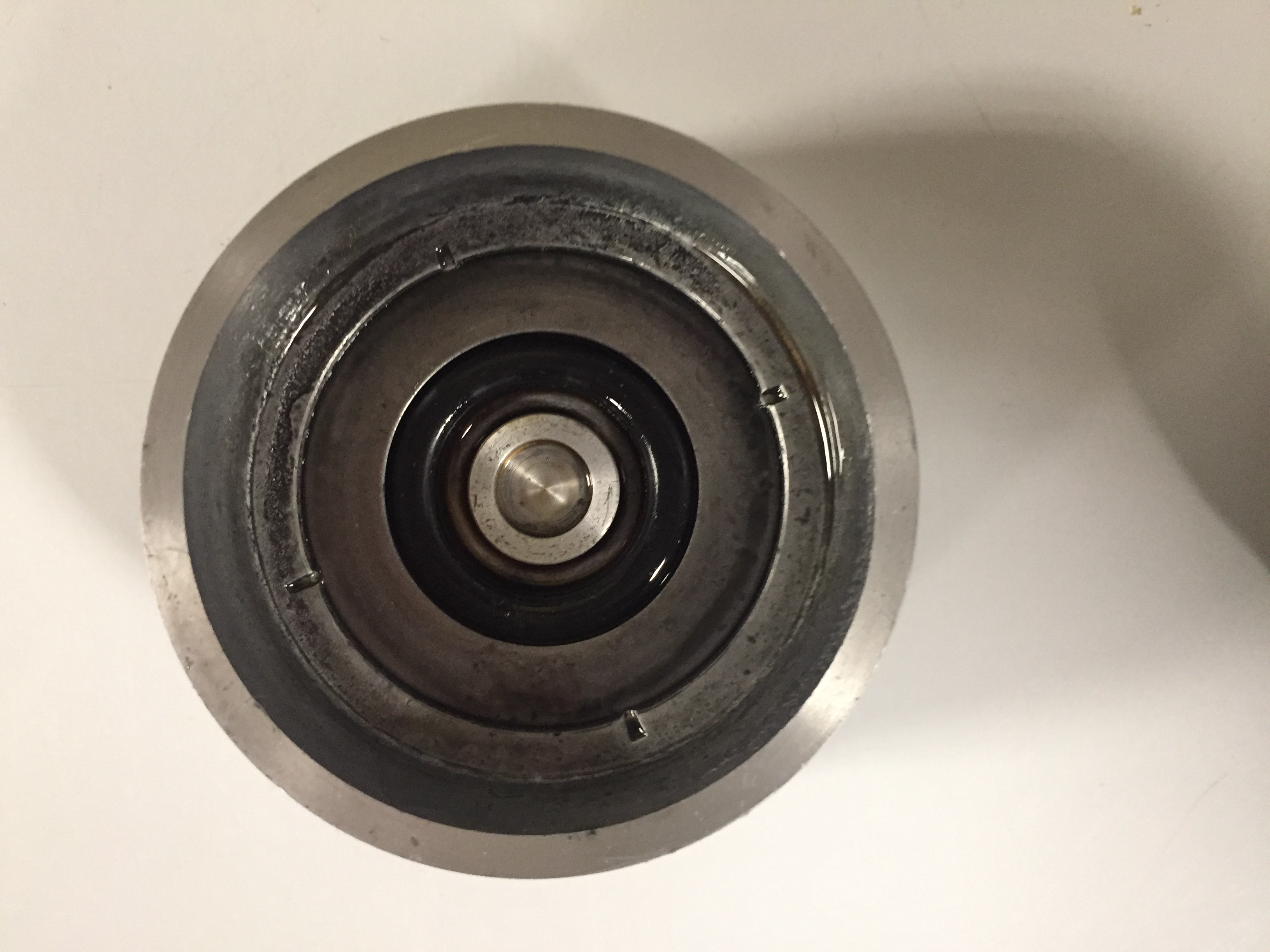

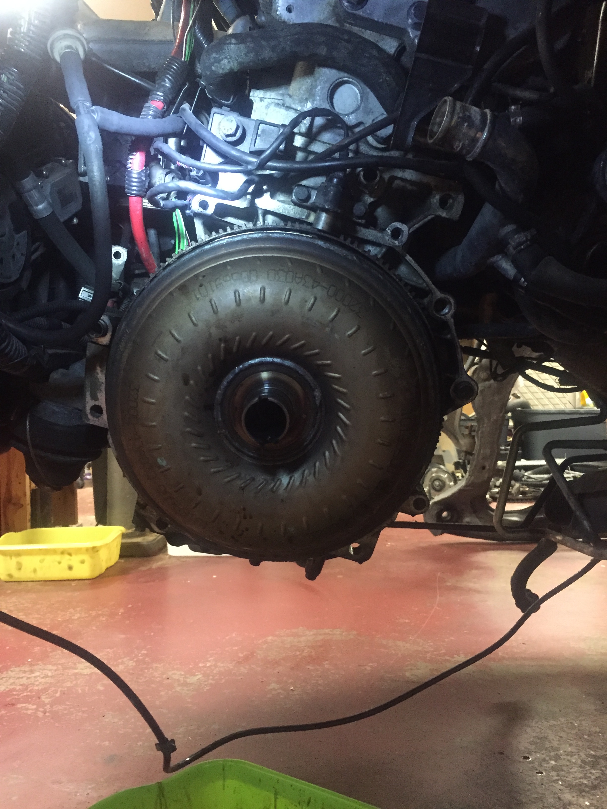

Step 52: Remove torque converter
Step 52 Remove torque converter
Step 52 Remove torque converter.JPG (1.63 MiB) Viewed 2434 times

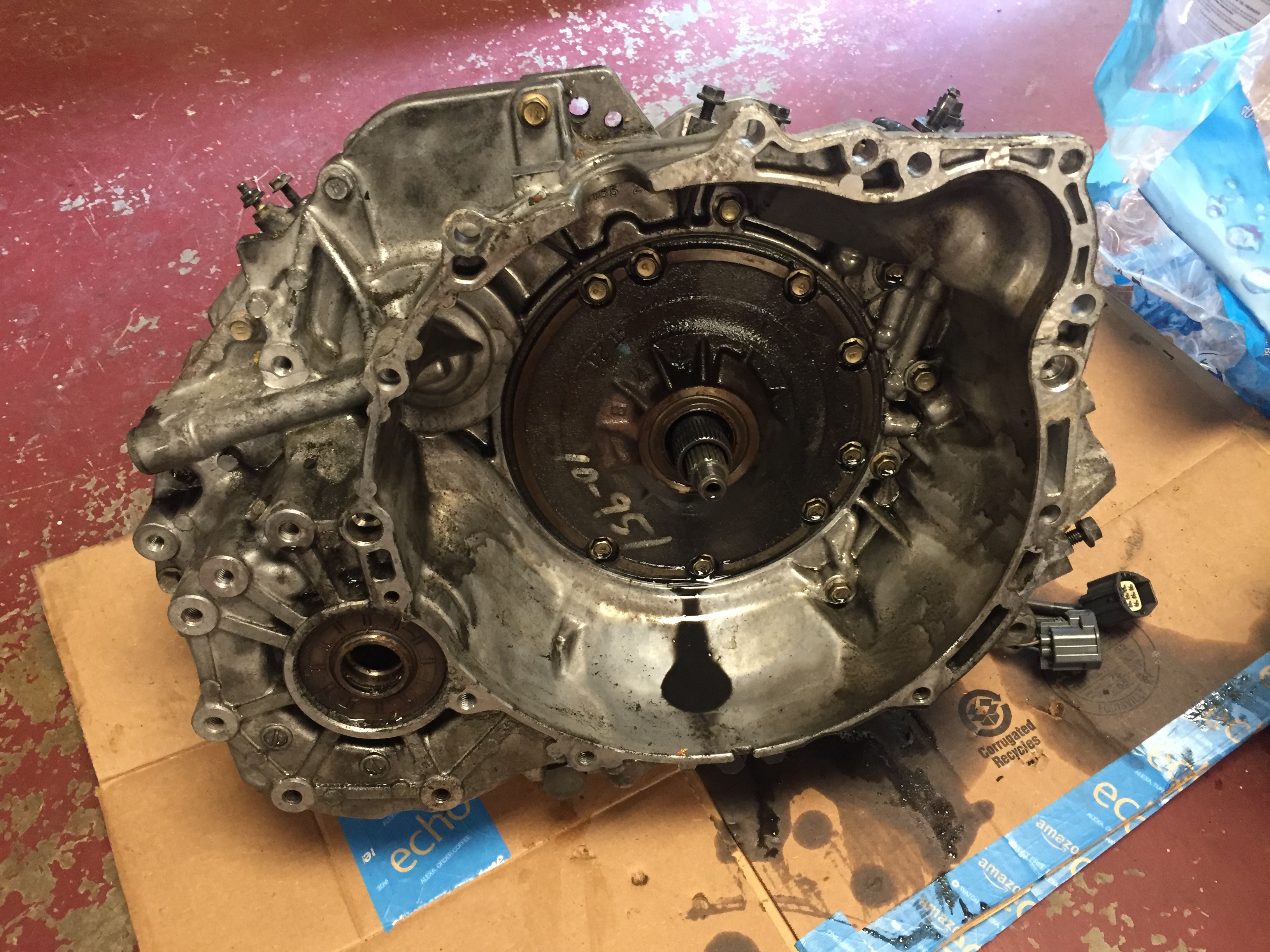

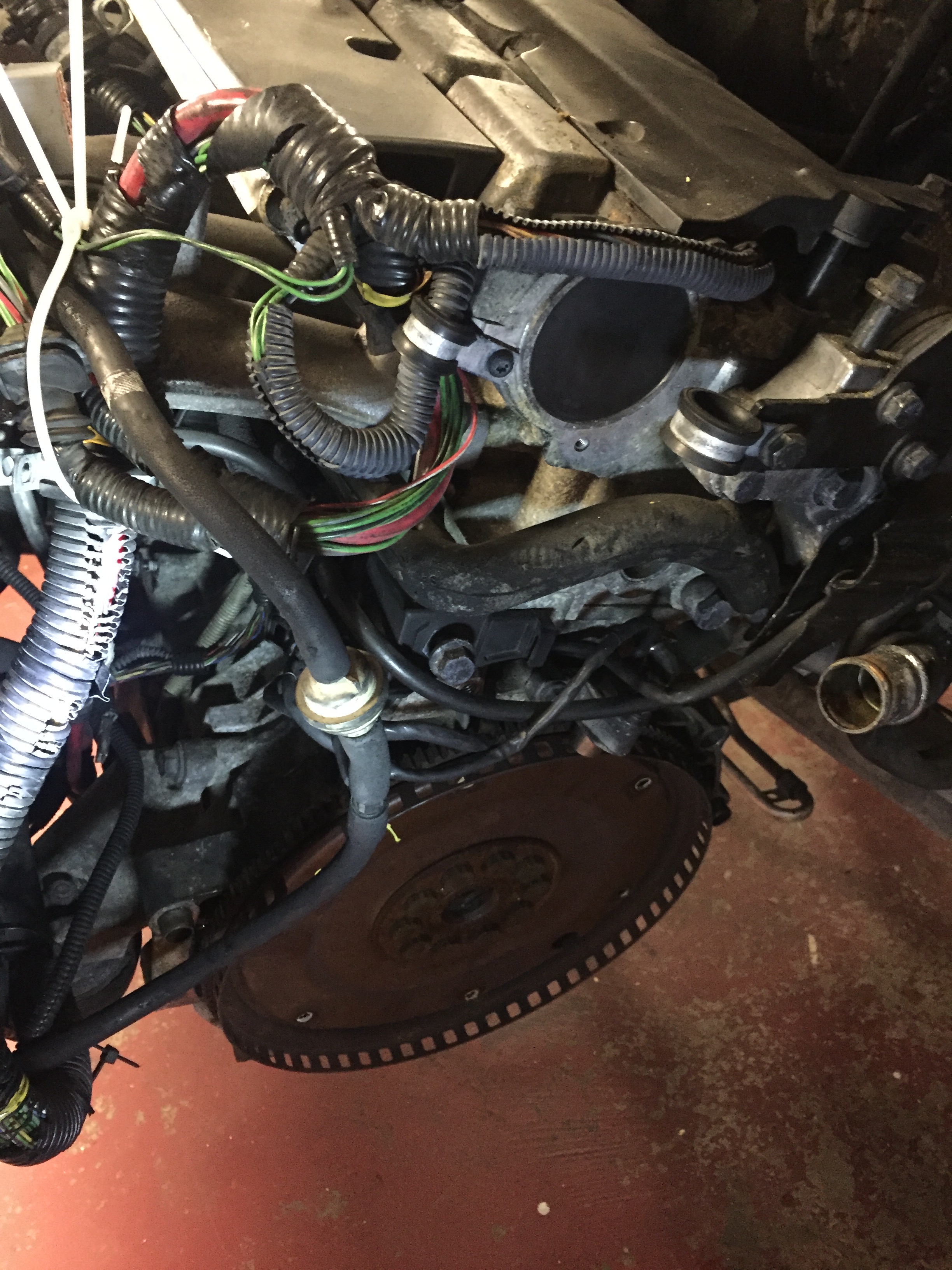

The old transmission is out!
Old transmission
Old transmission
Old transmission.JPG (1.64 MiB) Viewed 2434 times

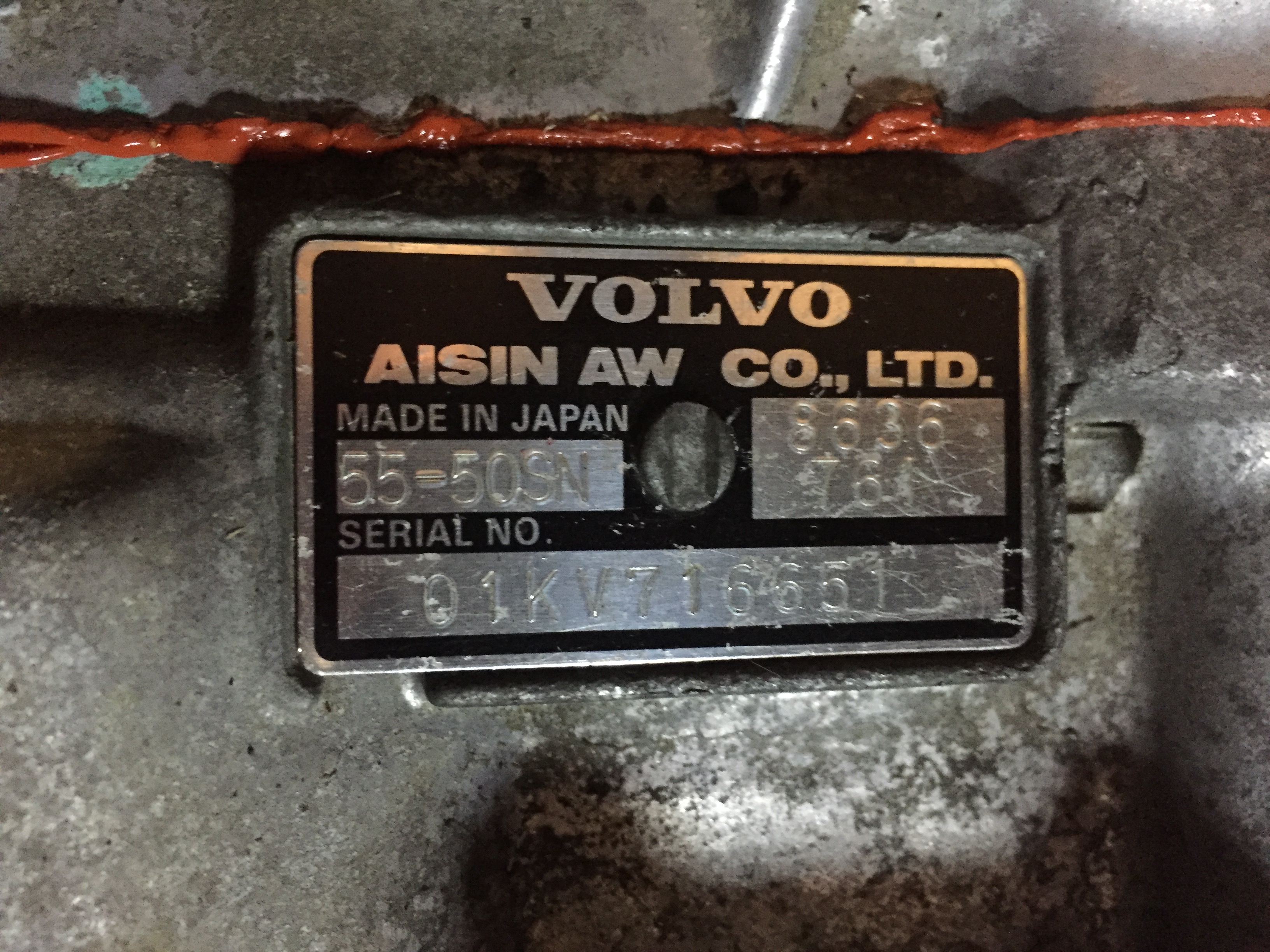

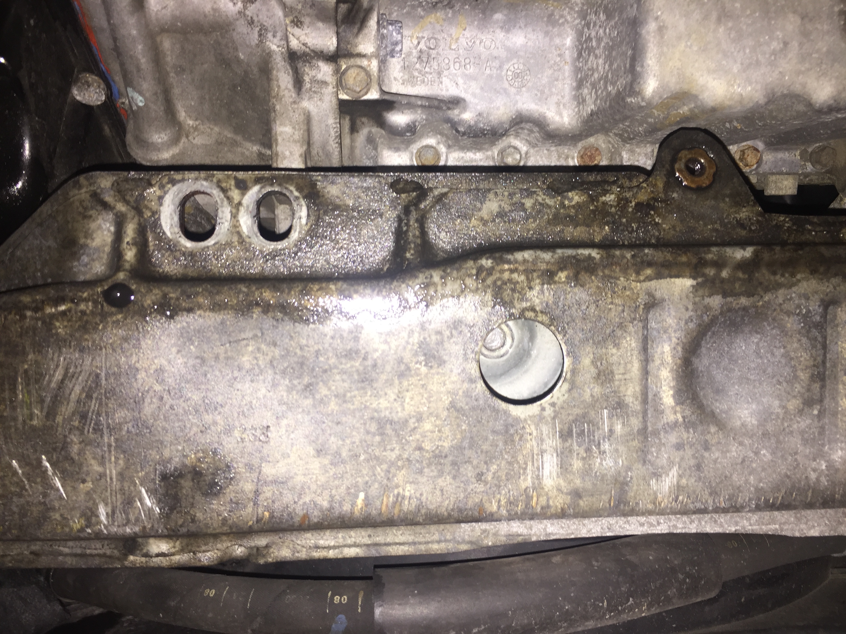

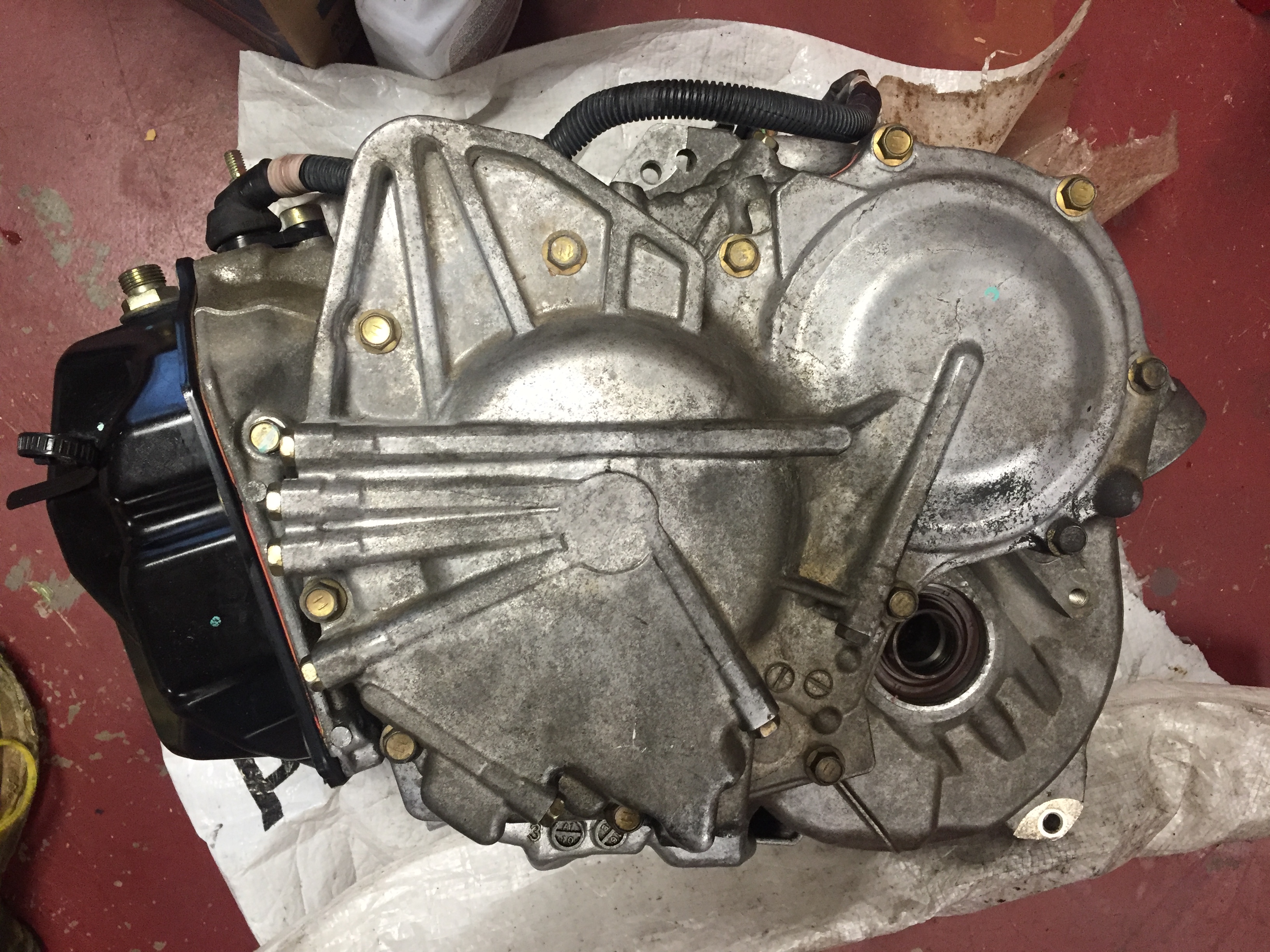

The new transmission has had the axle seals replaced, filter replaced, and generally cleaned.
New transmission
New transmission
New transmission.JPG (2.57 MiB) Viewed 2429 times
The "new" tranmission is a 01K... serial number and thus has a suspect B4 Servo cover. Luckily, I had installed the updated cover on the old transmission, so it's a matter of swapping this.
New nameplate
New nameplate
New nameplate.JPG (1.73 MiB) Viewed 2429 times

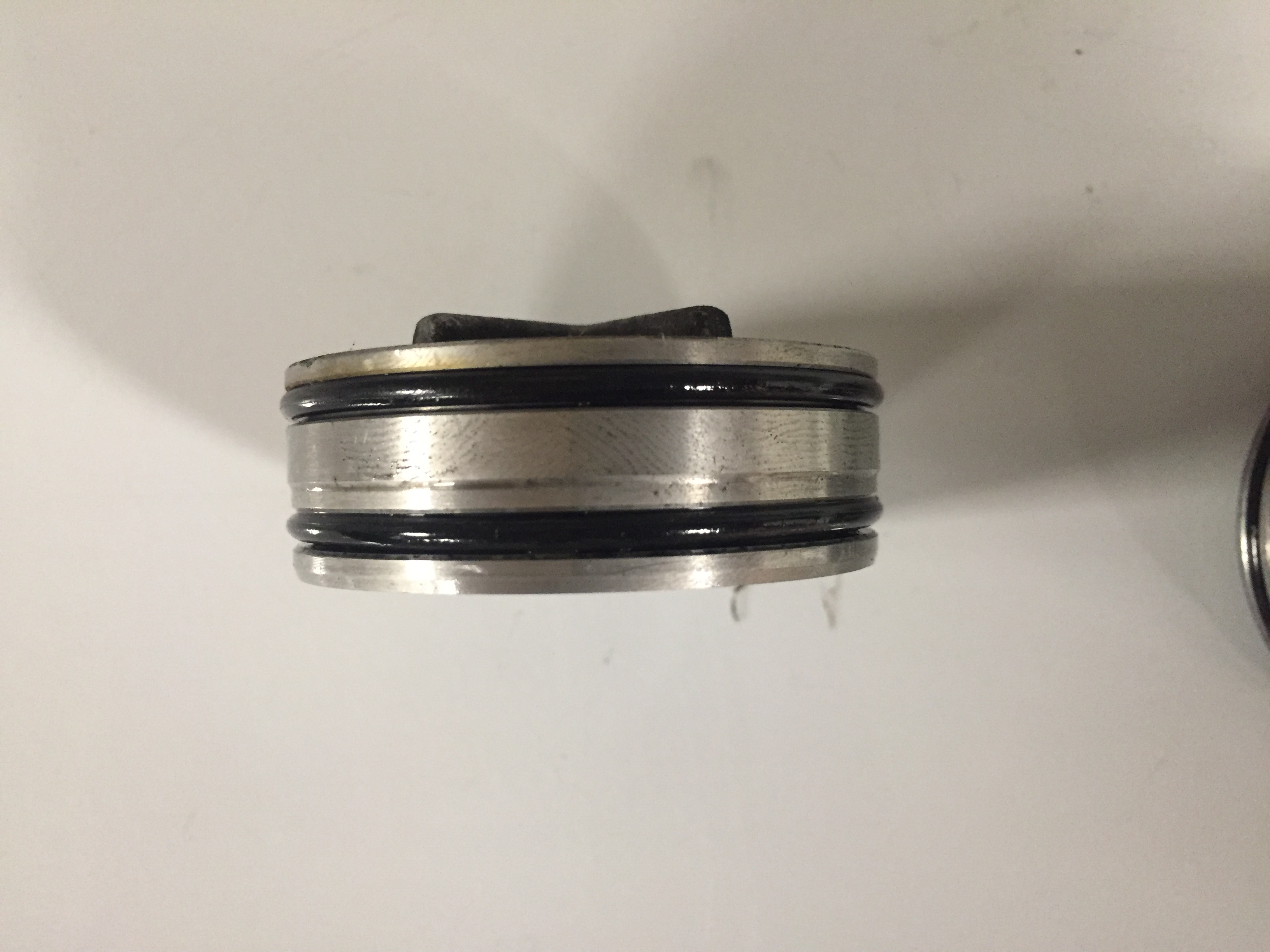

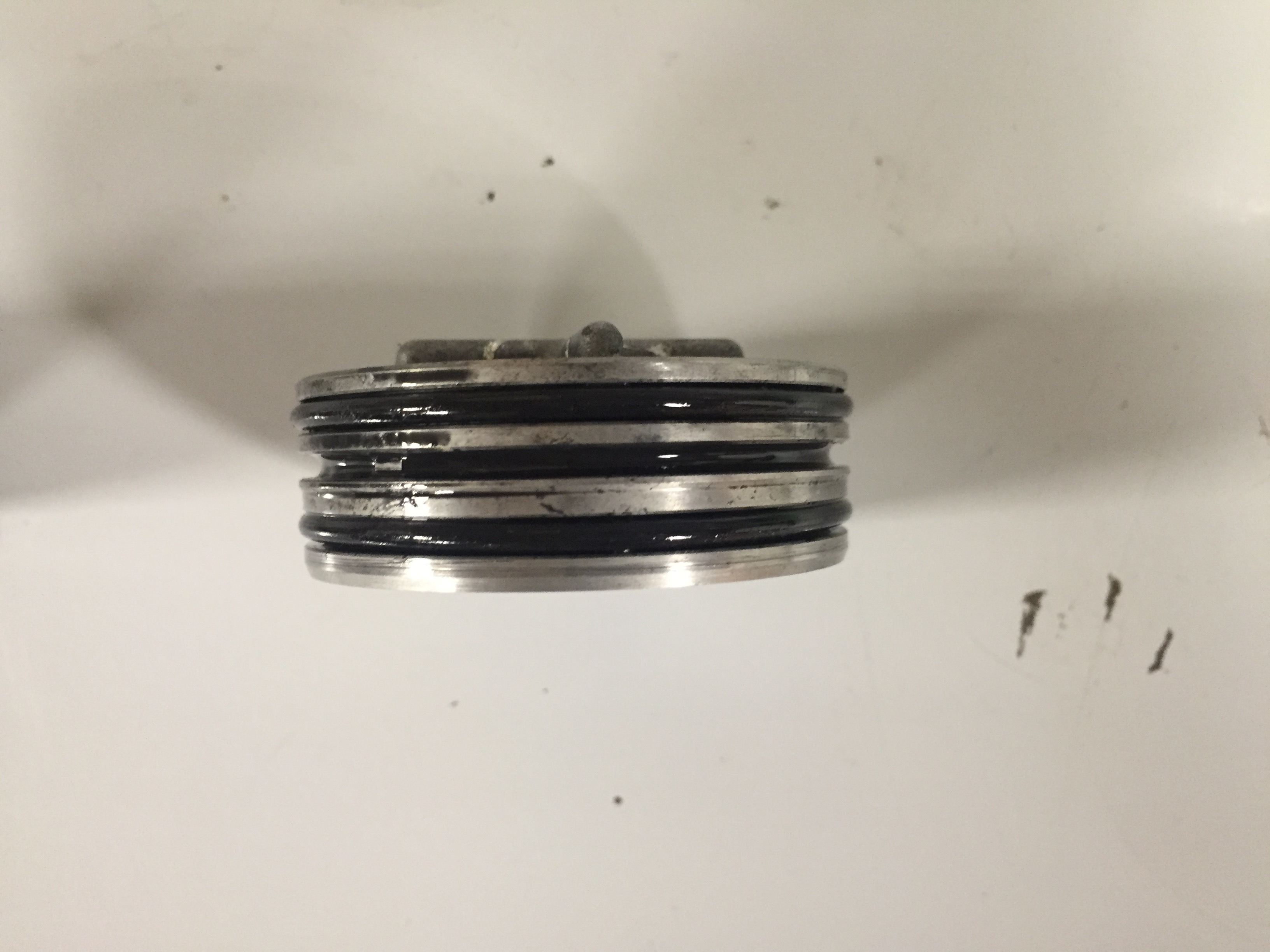

Here are some shots of the differences in the B4 servo covers
Old B4 servo cover underside
Old B4 servo cover 1
Old B4 servo cover 1.JPG (1.01 MiB) Viewed 2425 times
