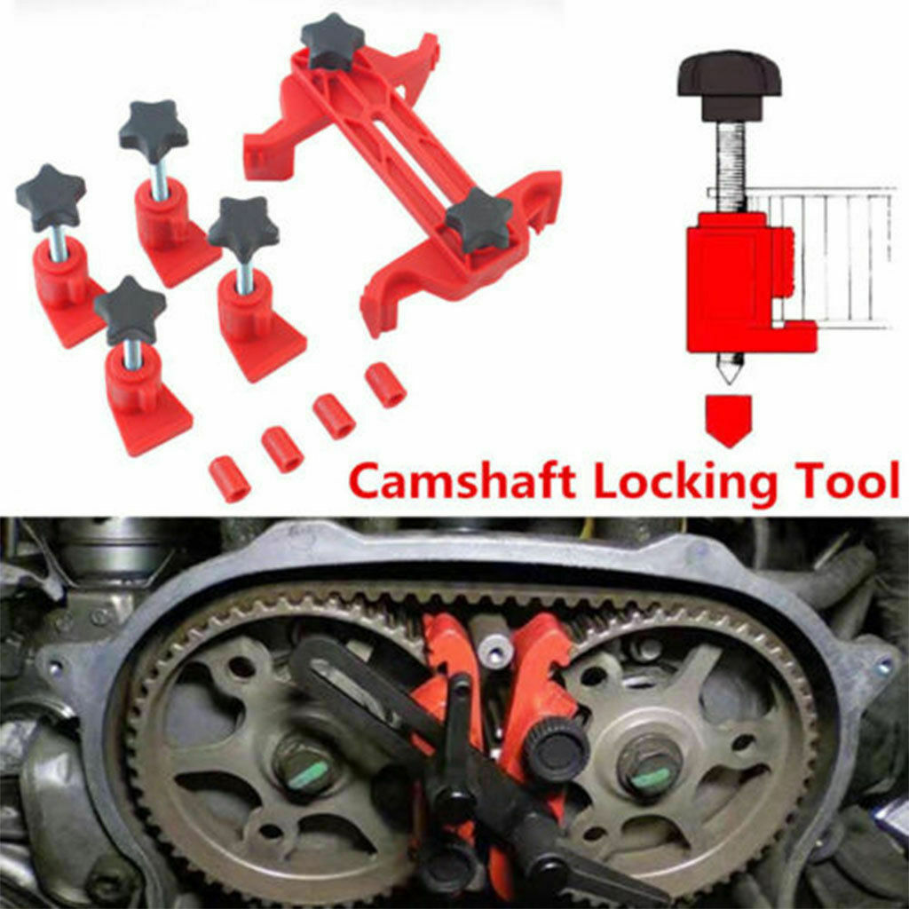

A Universal Camshaft lock can be used on the front in addition to the rear camshaft locks. Keeps the pulleys from drifting as you install the belt and snug down the pulleys.
