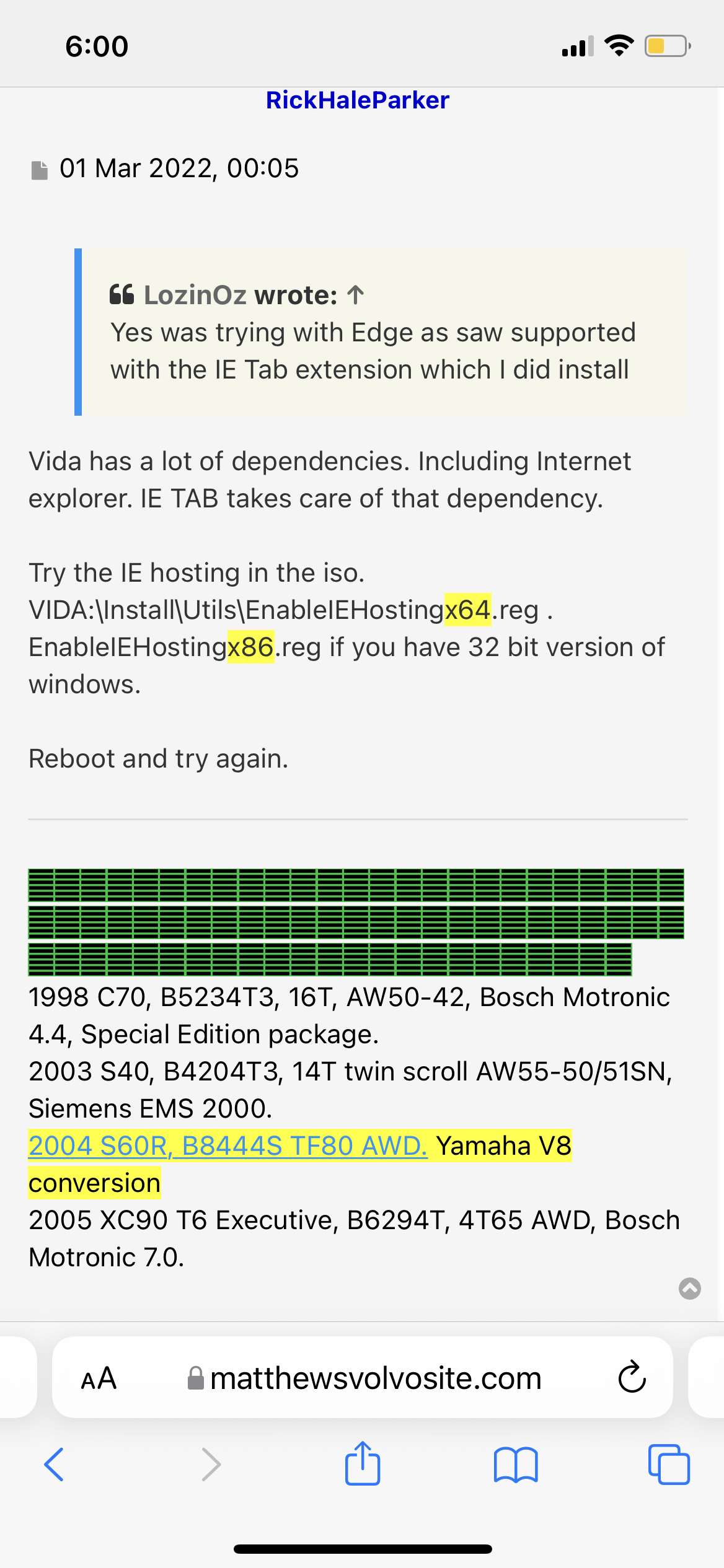

It is set to American when I press read it does it for about 10 secs and read stops and from there only dice configuration is highlighted read vehicle.
I was looking at one of your earlier posts and you said to make sure IE hosting is set correctly but I can’t find the file to do that.
