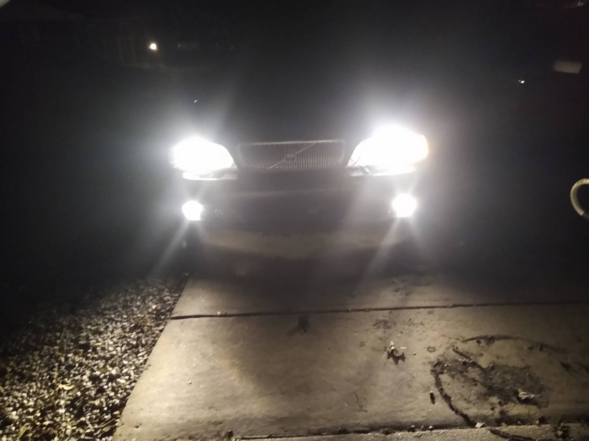

Cars approaching you are likely completely blinded.454cid wrote: 07 Nov 2022, 06:32 Yes, They do really light up the road. In fact sometimes it's too bright when I'm driving through construction with lots of reflective barrels/markers everywhere.

Half the newer vehicles on the road now blind you when approaching, anyway.850oldschool wrote: 07 Nov 2022, 10:12Cars approaching you are likely completely blinded.454cid wrote: 07 Nov 2022, 06:32 Yes, They do really light up the road. In fact sometimes it's too bright when I'm driving through construction with lots of reflective barrels/markers everywhere.
I remember in the olden days when there were regulations about headlight height and so forth. If they still exist, they must be loosely enforced or ignored. Growing up in NJ, headlight alignment was one of the few things they really checked during your annual drive-thru state vehicle inspection. If your headlights were out of alignment, you failed.
The biggest problem seems to be with tall vehicles like pickups and SUVs, especially if they have been lifted even higher than stock. In many cases, even brand new vehicles are just WAY TOO BRIGHT or are not properly focused or collimated.
Having said all of that, MODERN headlights SUPPOSEDLY can be super bright because they ARE properly collimated and the beam stays on the road. If you put super bright lamps in an old 1960's round headlight with little or nothing really designed to focus or limit the beam, it probably is more of an issue for oncoming drivers.

They're high beams, they don't get used when there is approaching traffic. I travel on a low traffic divided freeway at 3am.850oldschool wrote: 07 Nov 2022, 10:12Cars approaching you are likely completely blinded.454cid wrote: 07 Nov 2022, 06:32 Yes, They do really light up the road. In fact sometimes it's too bright when I'm driving through construction with lots of reflective barrels/markers everywhere.

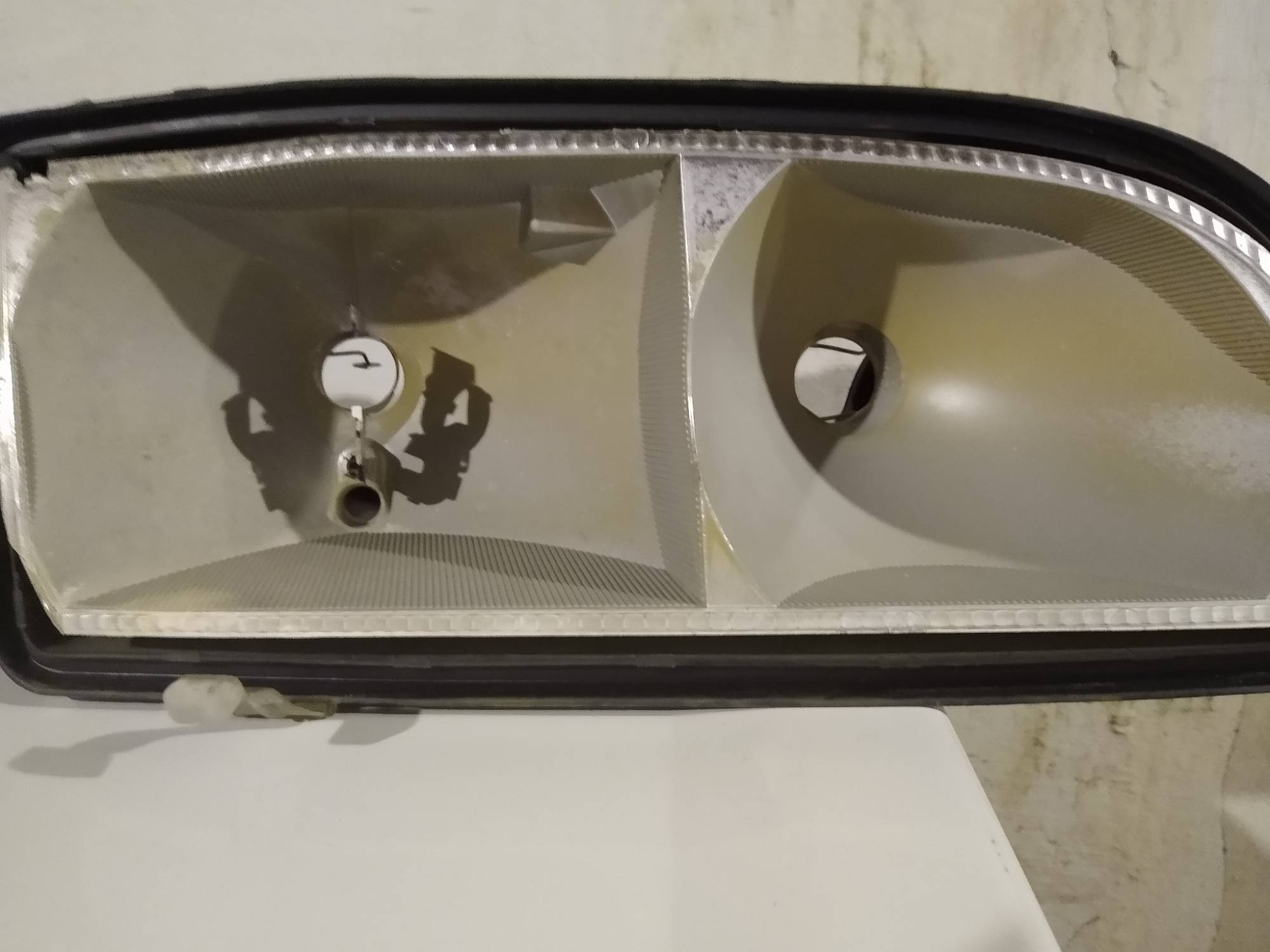

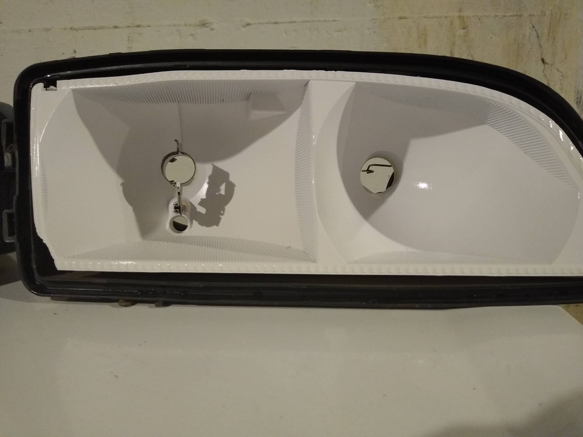

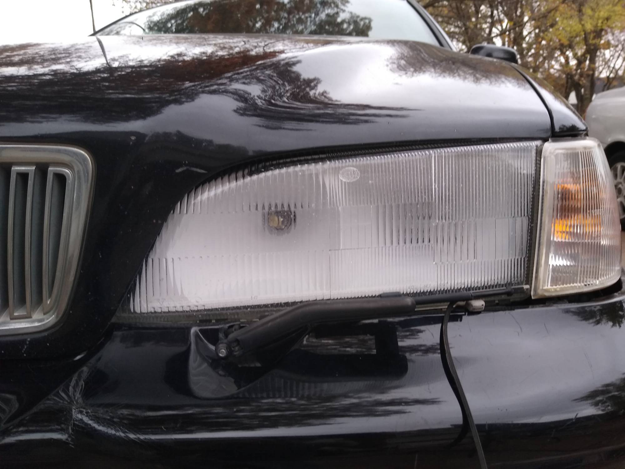

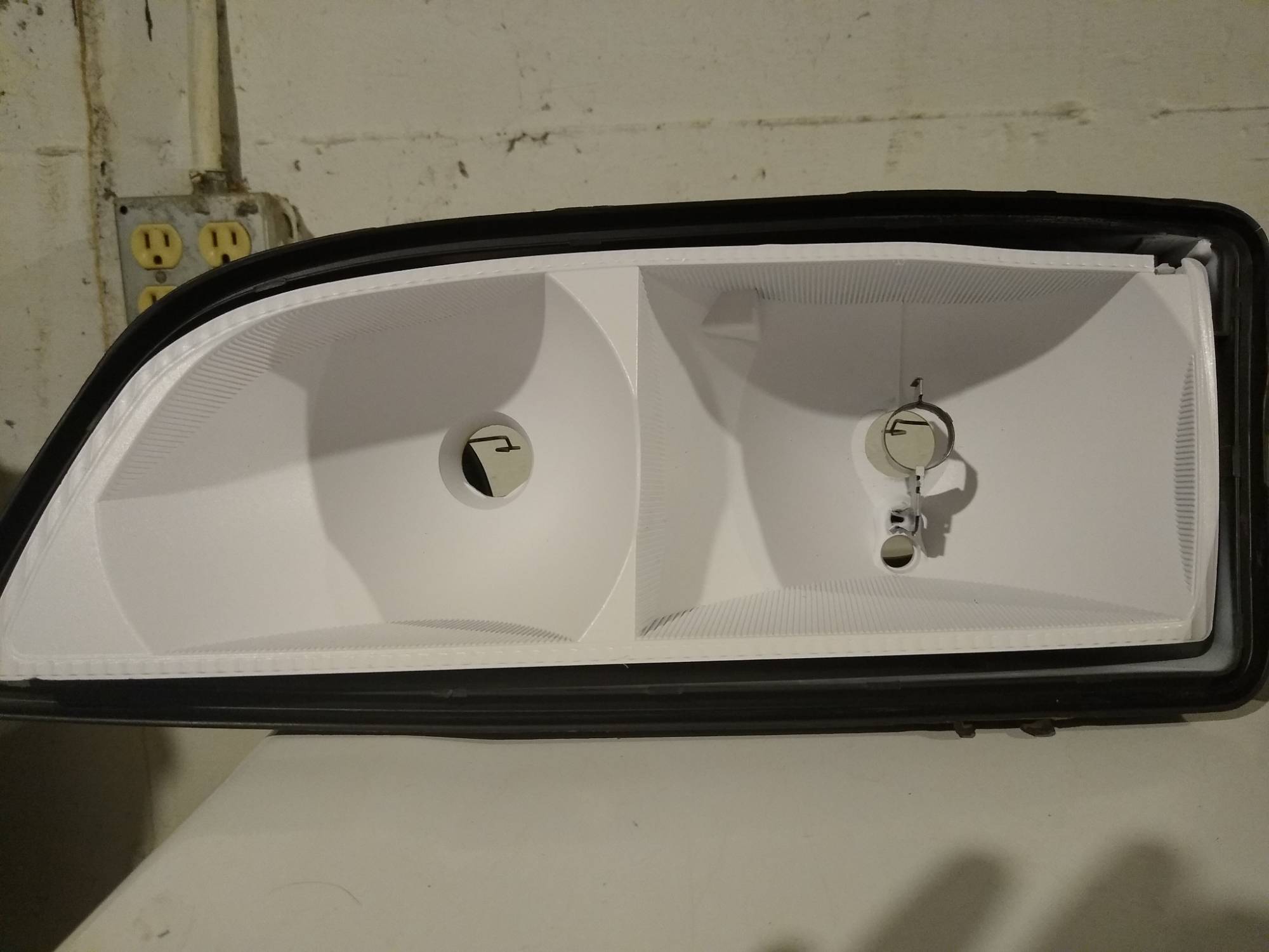

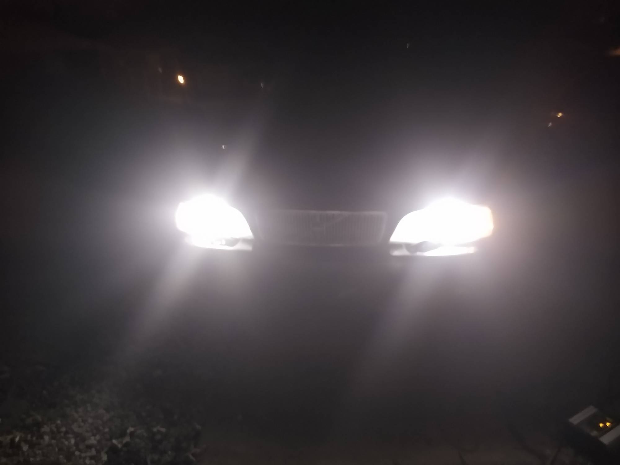

It worked out pretty well. Lights up the road and street signs good but not over done, blinding on coming drivers.

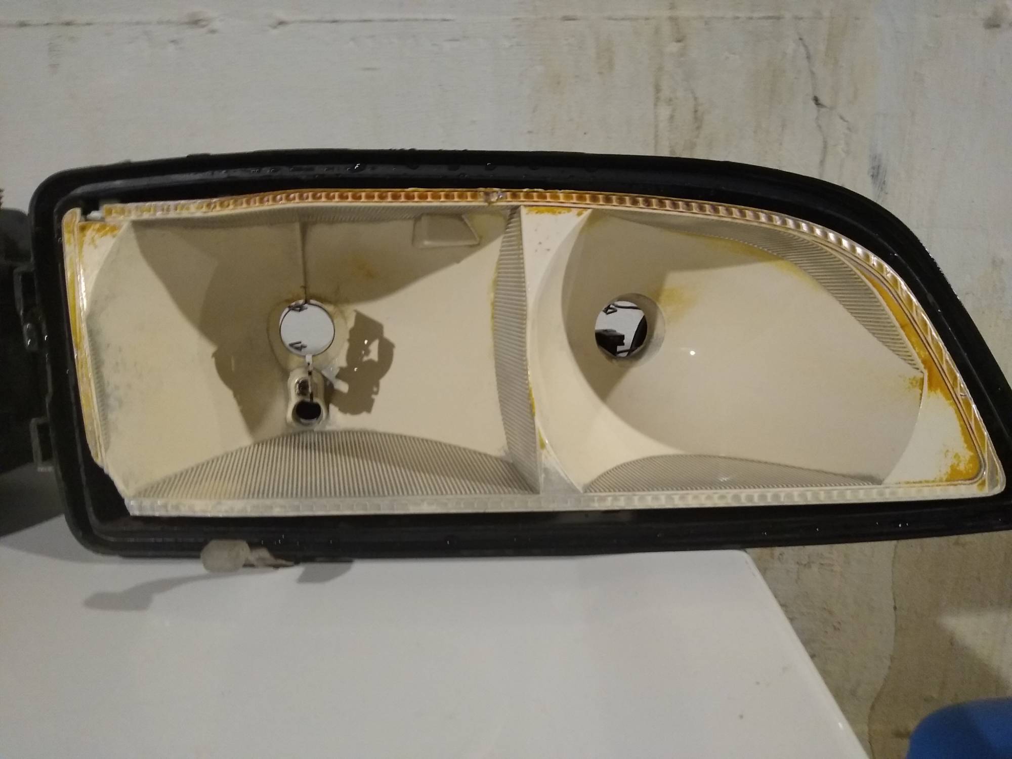

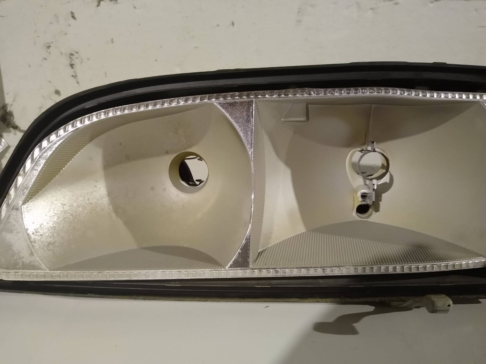

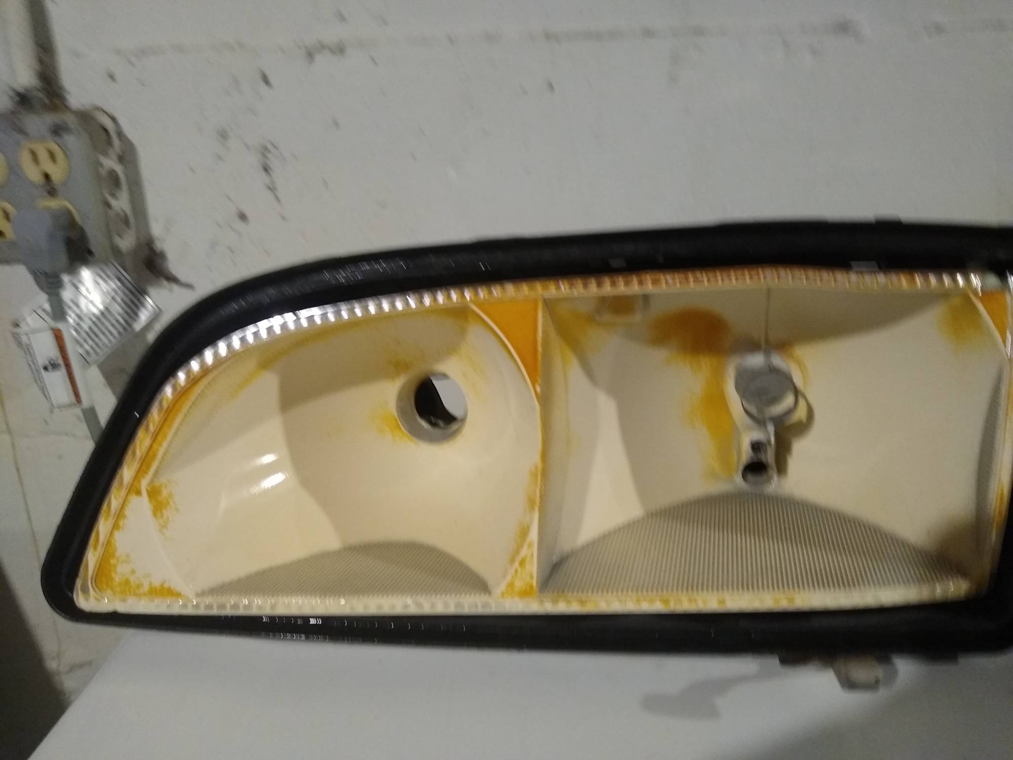

Before After Before After Day time looks like frosted glass. The silver was pretty much gone. Clean up well with a Steel wool soap pad. Six light coats 1/2 hour between Remove masking 1/2 hour after last coat.

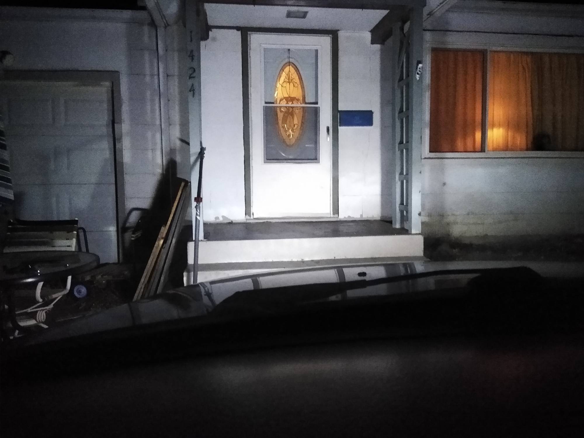

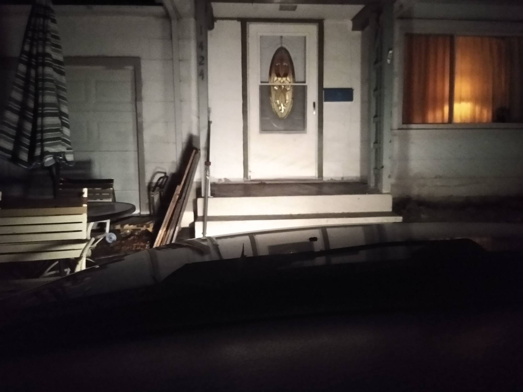

+1 for an objective test!
+10 if you used the same exposure between shots!
+10000000000 if you used the same exposure between shots and checked that ambient nighttime background illumination was generally similar!
+1x10⁹⁹ if you used the same exposure between shots and checked that ambient nighttime background illumination was generally similar using an EV meter and recreated exactly the distance from headlight to house wall!
Whatever the case, outstanding thinking-outside-the-box on this one with white paint. So much more accessible than chrome-ish paint, or chroming itself. I love headlight illumination testing. It brings out the super nerd in me.
