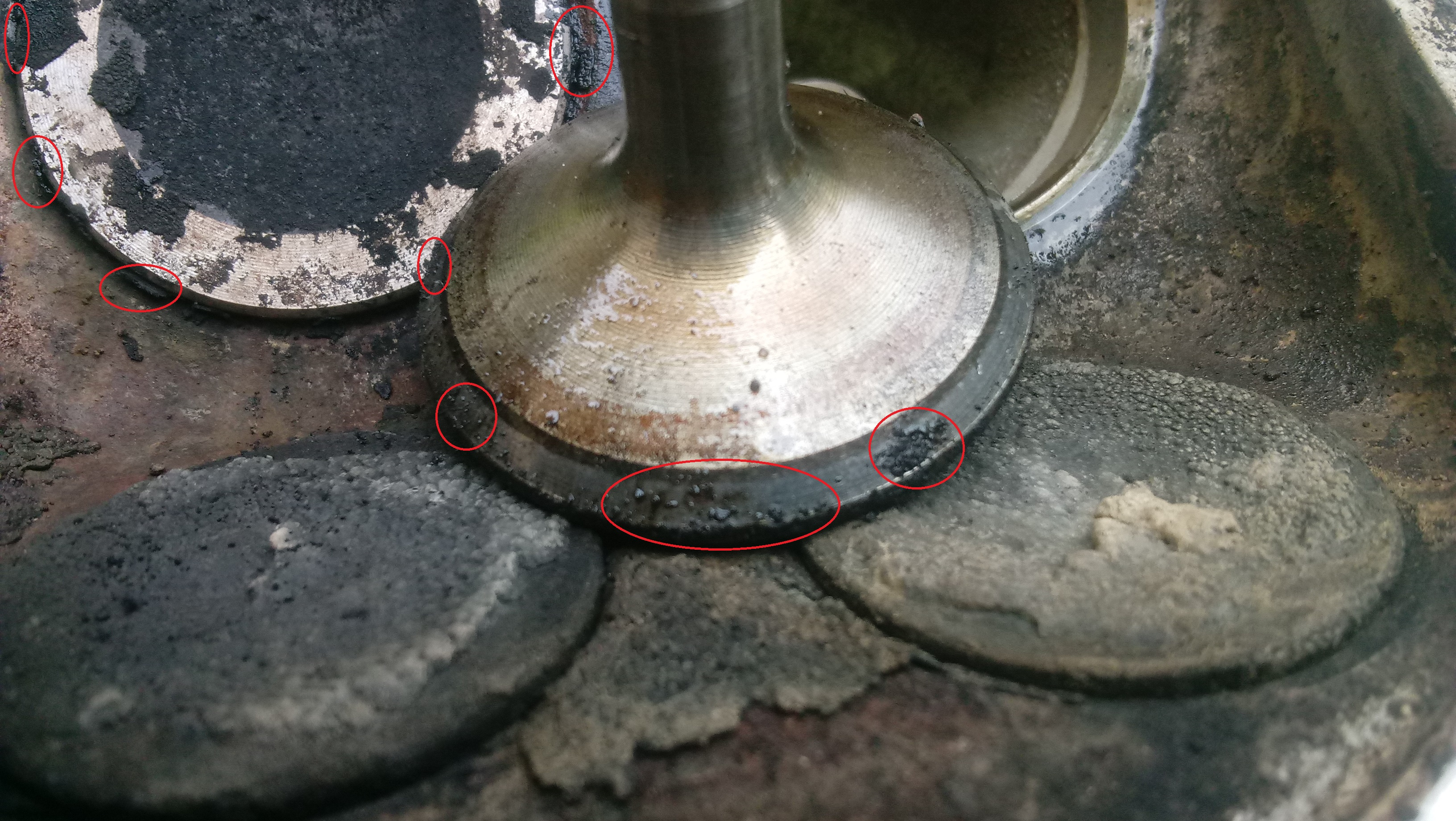

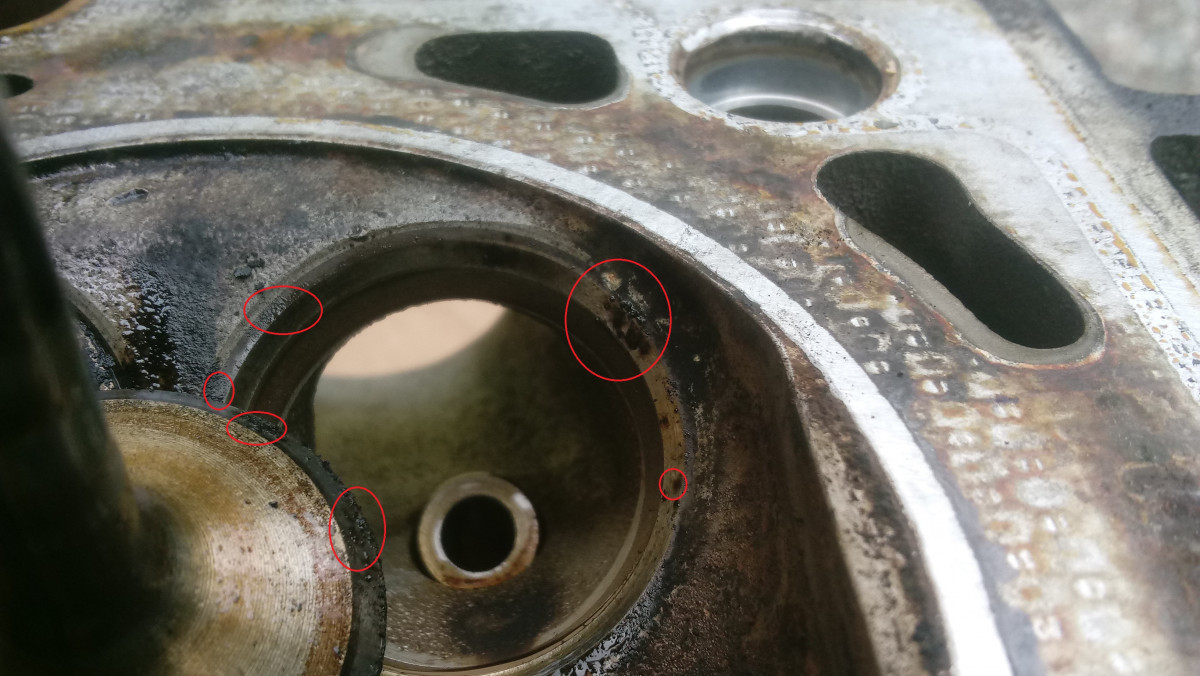

Alright, the moment we've all been waiting for:
Nasty! The valve pictured is the one that appeared to be leaking the most during previous tests. Bad angle of the pic but visually it is straight with the line and there are no signs of contact on the pistons/valves, phew! It's got some of that carbon or whatever on it and on the seat which may have been keeping it from sealing, but it wipes away so I figured the brake cleaner and MMO would have dissolved it, maybe not.
Other than just general disgustingness, anything jump out at you all? I knew the valve seals have been leaking for a few years, might be where most of the build up came from.

Use a straight edge against the valve stems to check for straightness. Check in at least three positions.
They could use a good lapping.
