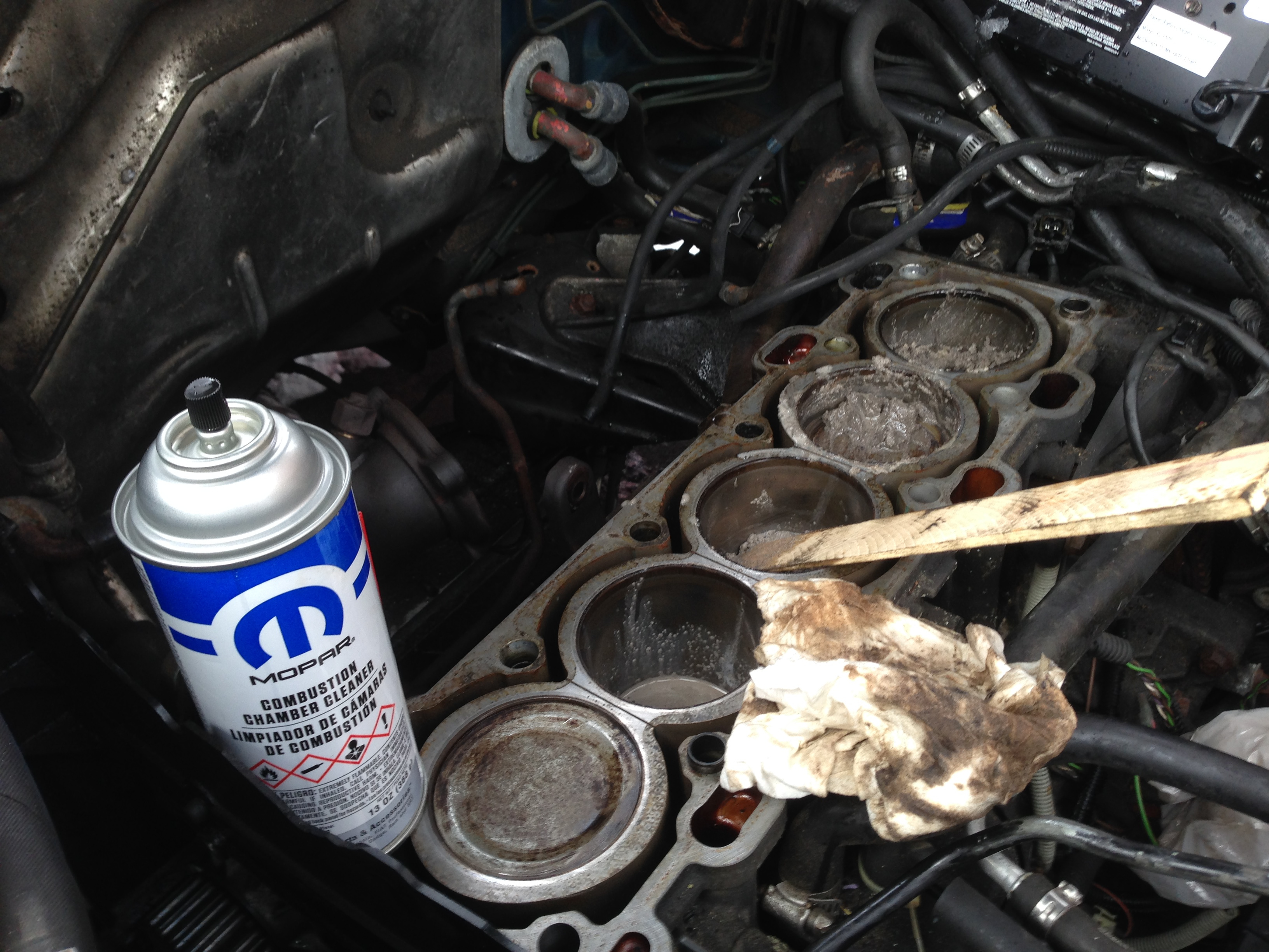

Used the Mopar upper cylinder head product to clean the piston tops. This stuff is magical
Apply, soak overnight, wipe with paper towel....

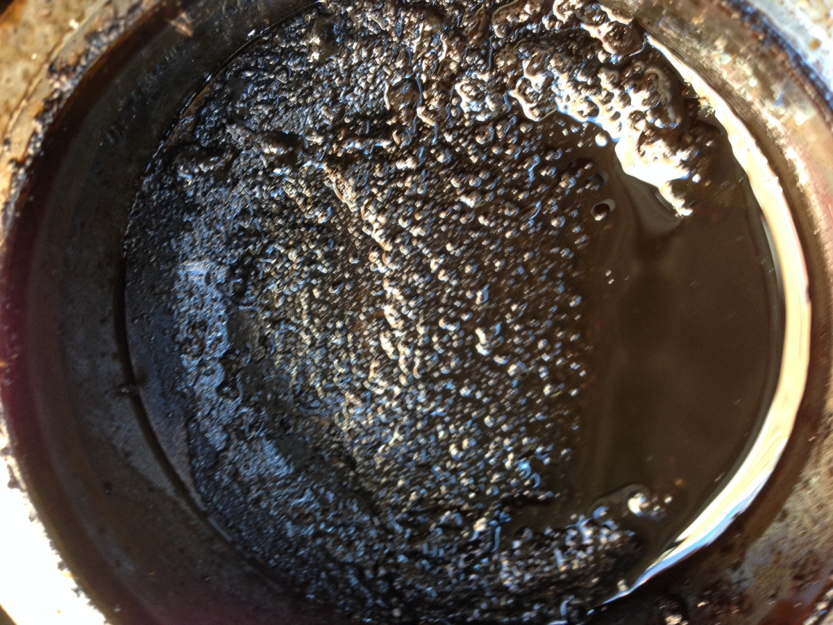

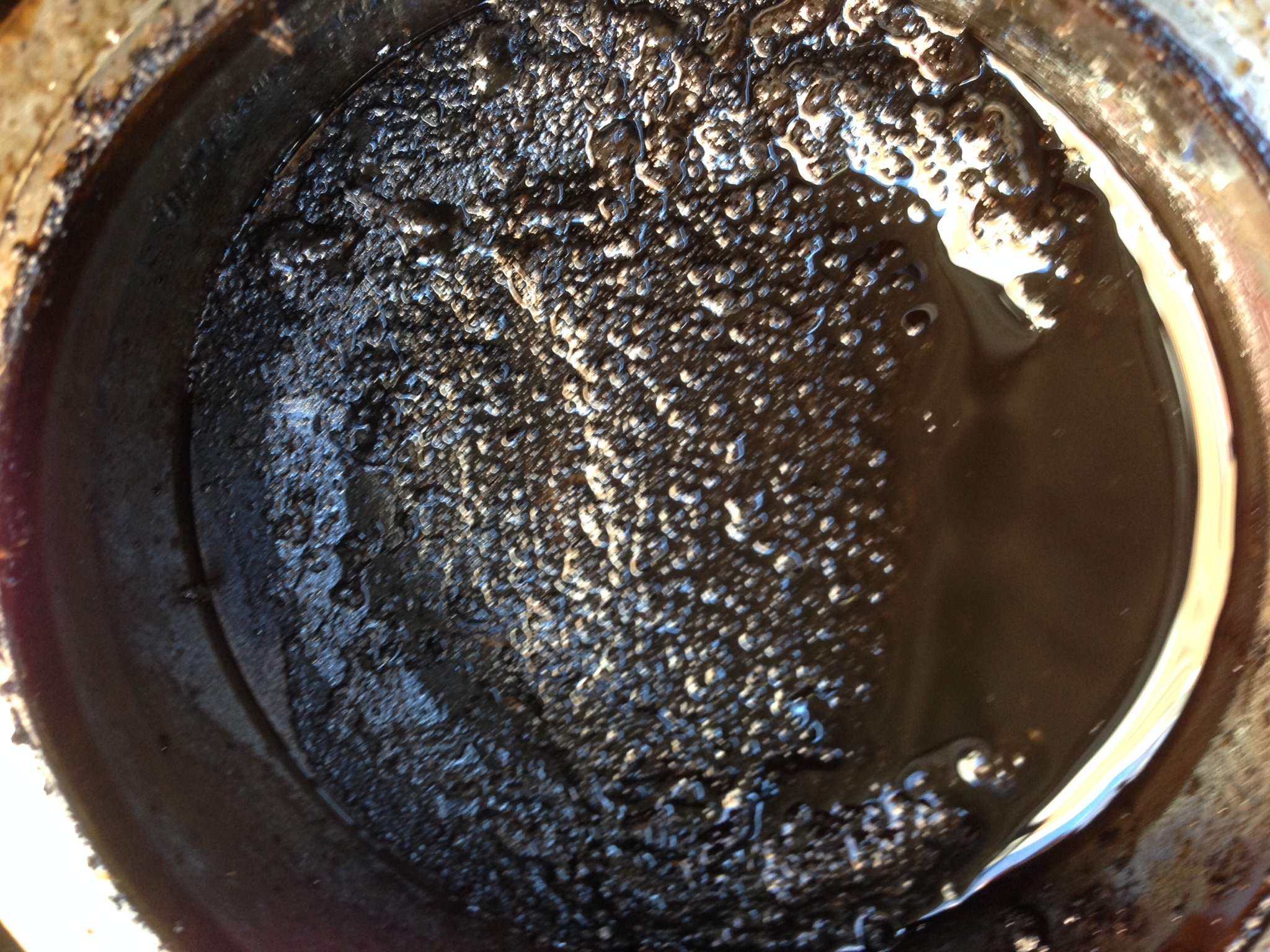

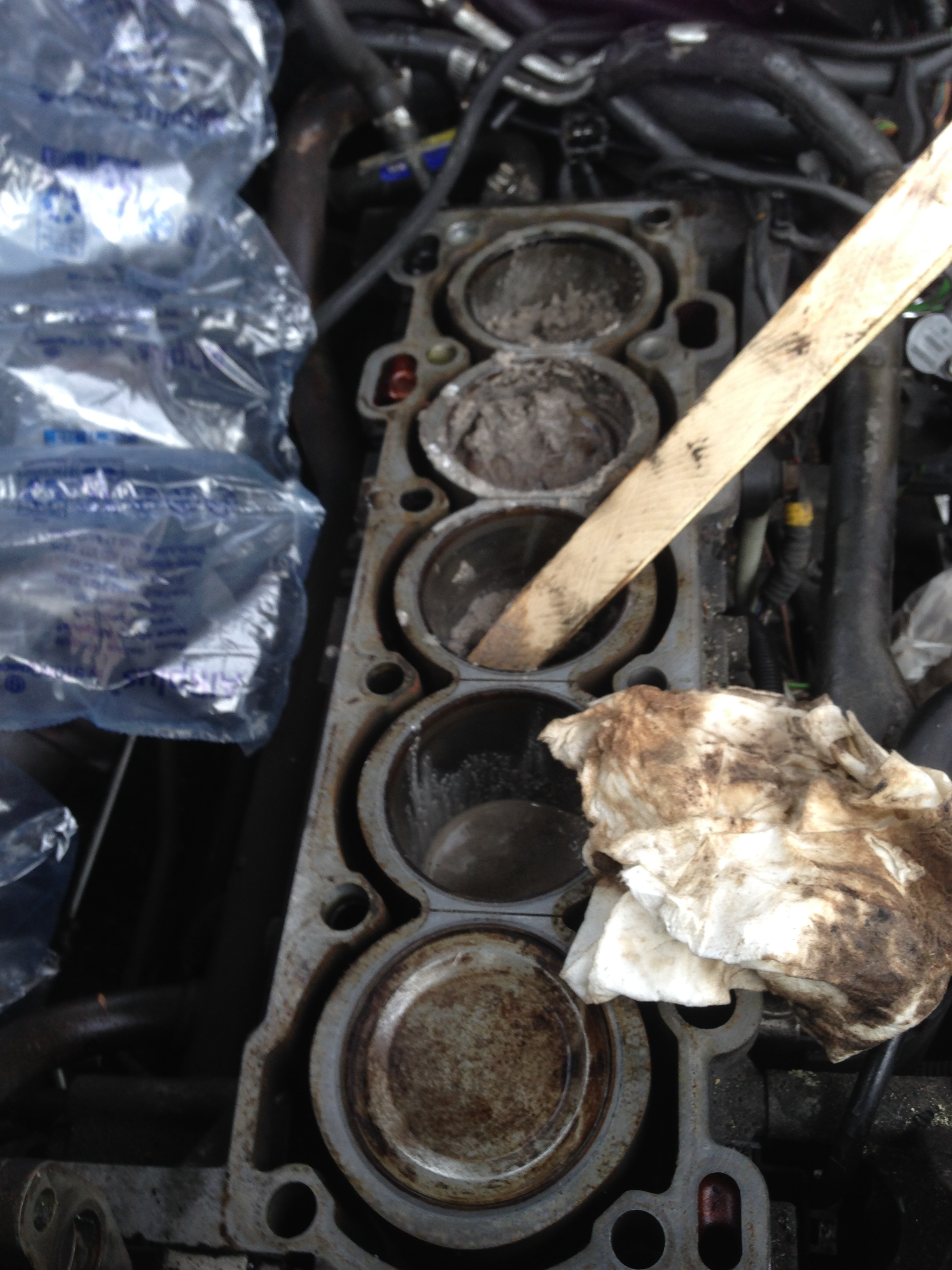

wait....you have some sort of mud volcano going in 4 and 5.
Also - isn't all the grime and grit getting down the sides to the ring lands and scraping up the walls? Any way to suck that out of there with a tiny vac nozzle?

It got cold enough for the solvent to freeze
It will get washed down with solvent into the sump, then air blasted to get rid of particles
It’s an engine, not a Neuron.

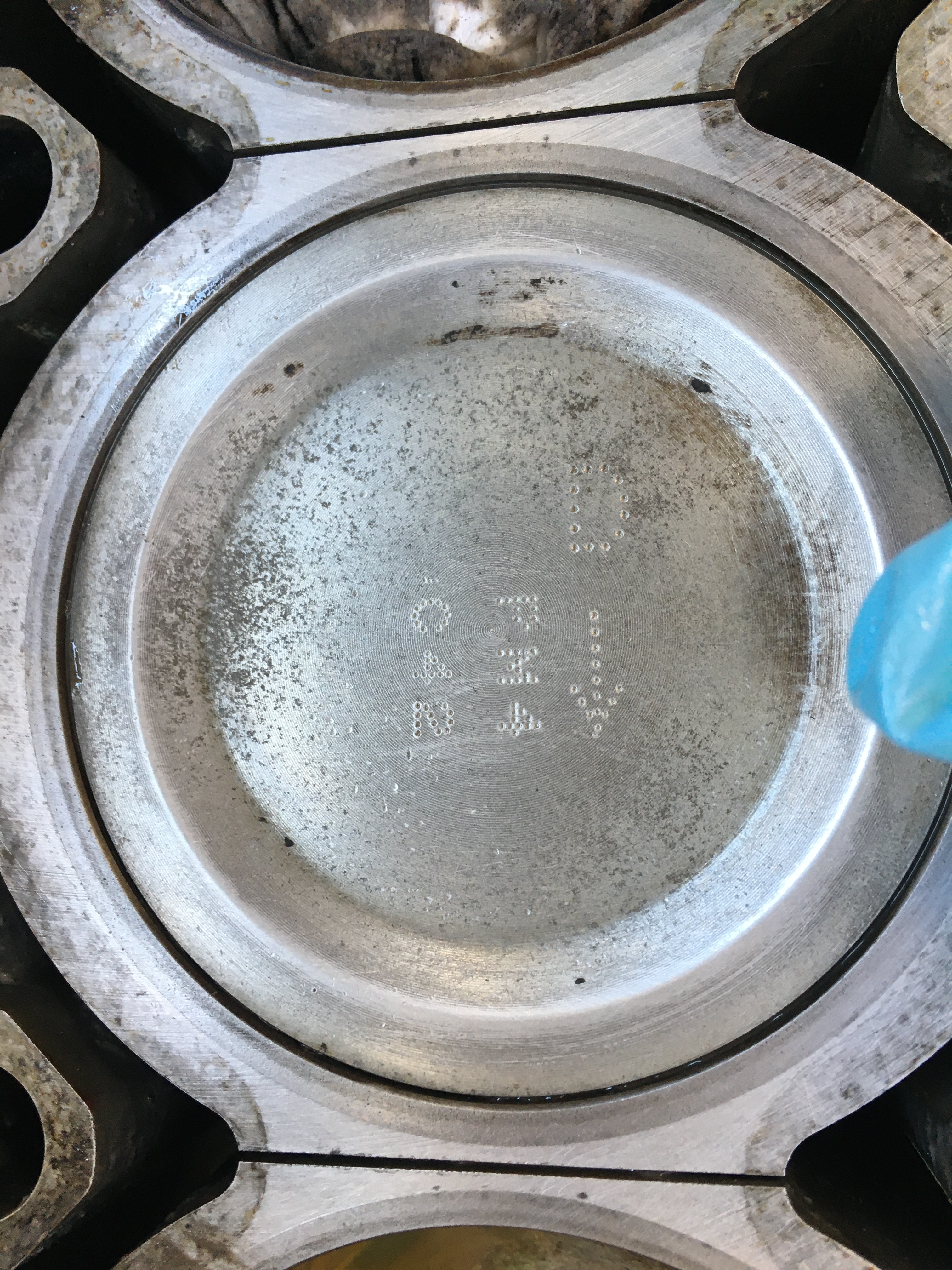

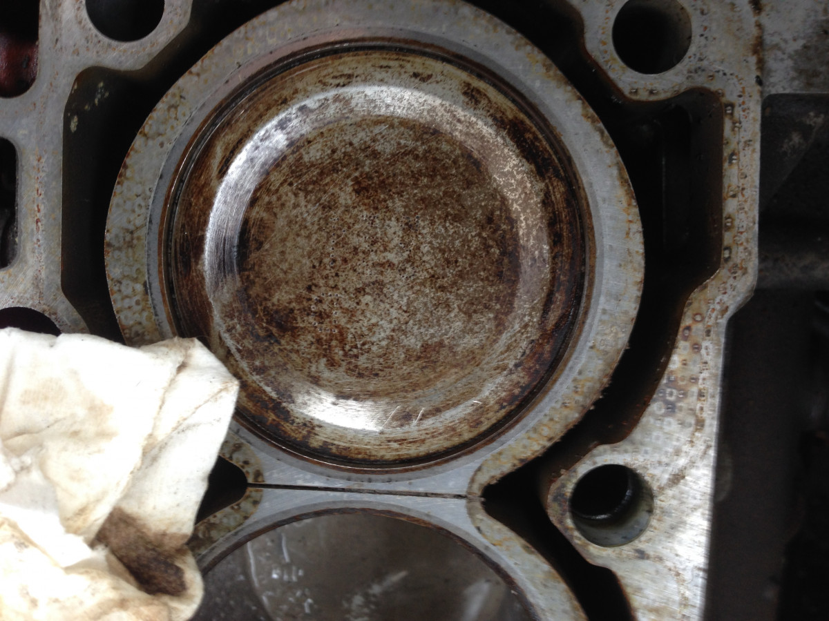

Got them scrubbed , blown out, oiled up

I see no mirror like polished surface? Are you getting lazy, Steve?
Joking aside, it's quite amazing how nice the piston looks after all these miles and millions of explosions right above them.
