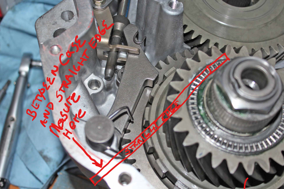

For the clearance spec, 1.3mm is within the spec range but from your photo I'm not sure how you measured it. The straight edge should be sitting flat across the thrust bearings and extending out past the mating surface of the case. The clearance to measure is between the case mating surface and the straight edge over the case surface, the same edge that's pressed flat on the thrust bearing. .

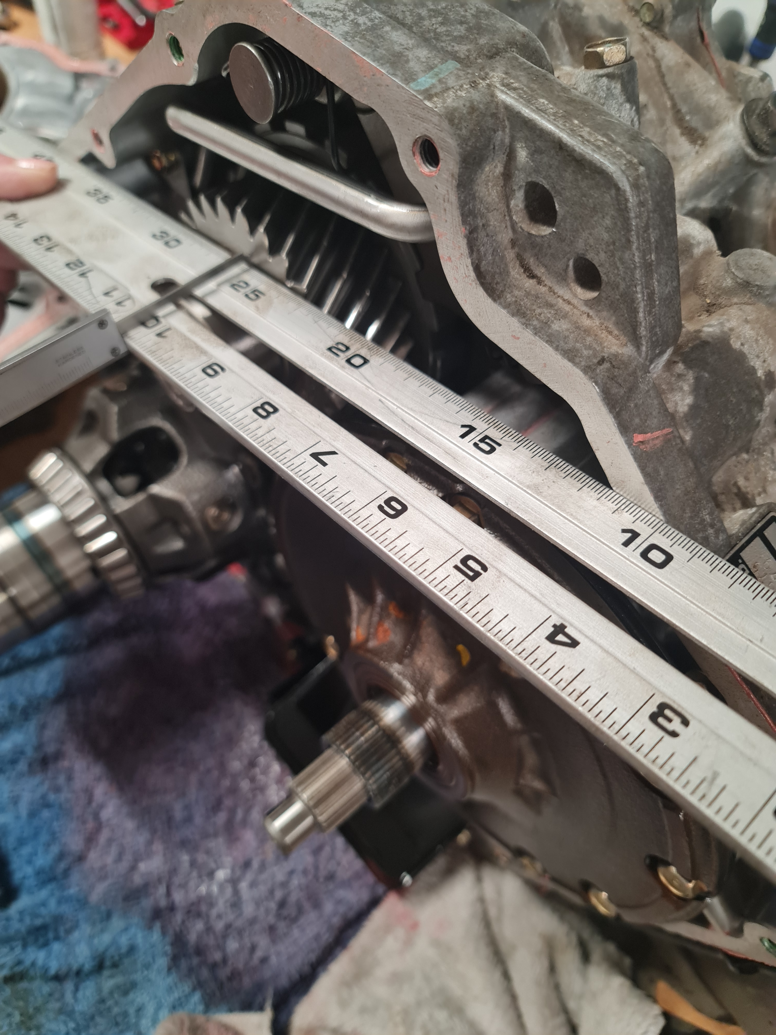

Meassued like this...

greffel wrote: 24 Oct 2021, 13:28 Meassued like this...
The straight edge should be vertical and the edge should be flat against the pinion gear thrust bearing rollers with the edge extending out beyond the case mating surface. The measured clearance is between the case mating surface and the straight edge extending over the mating surface. The thrust roller bearings should be slightly higher than the case mating surface and that the clearance to measure.
From your photo it looks like the big end shaft bearing is still in place, it needs to be removed so you get to the thrust bearings and rest the edge on the thrust bearings.
Set the straight edge on edge and across as many of the shaft thrust bearings as possible so it's flat and extends beyond the case mating surface.

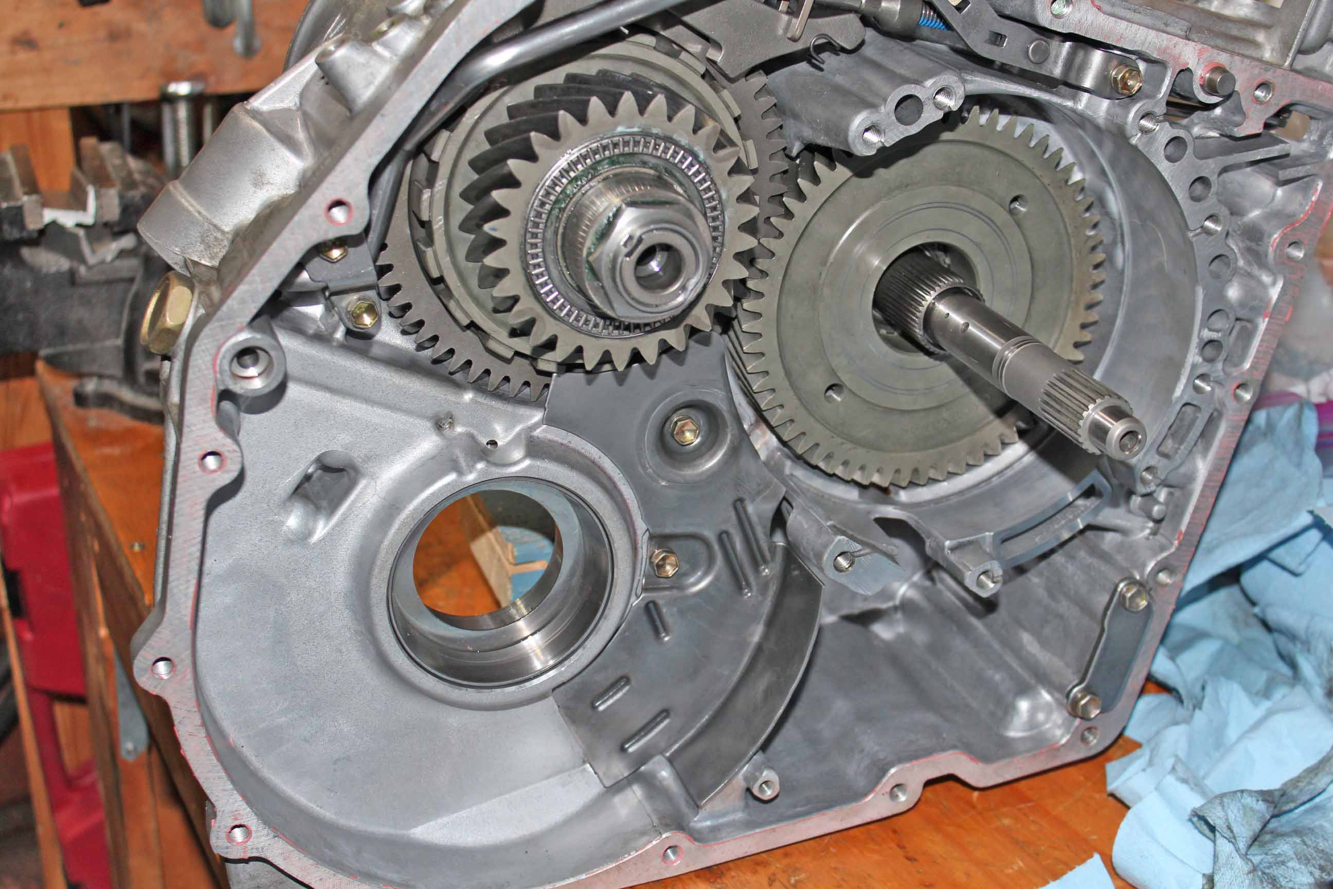

EC) Small windage pan installed Note selective sized washer behind diff bearring race for preload.jpg
Place straight edge across as many thrust roller bearings as possible and extend straight edge beyond case edge. Measure between case surface and straight edge.

Now you lost me a little bit... the way I measured is without the bearing in your picture.
The measurement shows that the gear is 1.3mm lower then the case surface.
Should i measure with this bearing installed and see how muck higher the bearing is over the case ?
Without this bearing I get 1.3mm
