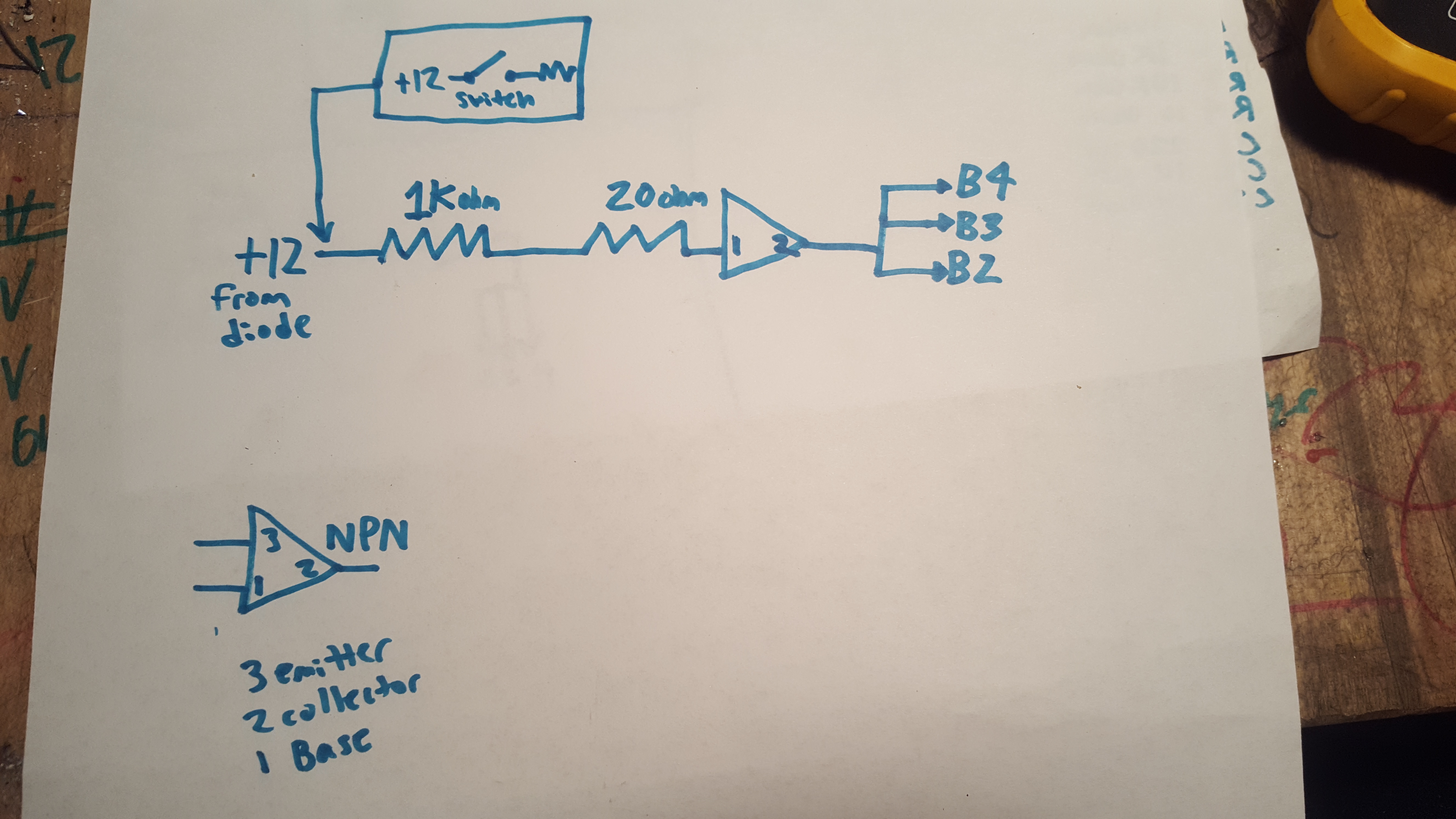

Parts: ECU M4.3, 1K ohm resistor, 20 ohm resistor, NPN transistor capable of accepting 12-13V.

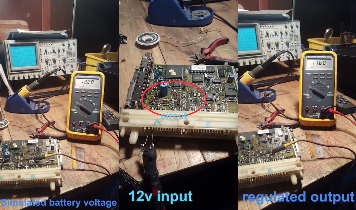

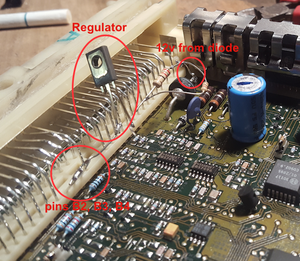

Ok so to do the hack you gotta open up the ecu and find ground, 12v, b2, b3, and b4.
Solder a 1K and 20ohm resistor (in series) from a 12v source on the board to a voltage regulator to make sure the voltage is under 12v but between 8v and 11v.
Then solder the resistor pair to the base of the regulator and the collector of the regulator gets soldered to pins b2, b3, and b4 on the board ( cut the pins out to wiring harness). One extra thing to do that I diddnt was wire a switch before the resistor pair as to be able to controll the mod as ive already spun tire when not intending to.
I will add photos and a schematic soon.

Thank you! With my 855T manual swapped i could spin tire accelerating in 1st without trying
P.S: Having or not having a voltage regulator has no effect so I wouldn't bother adding it.
