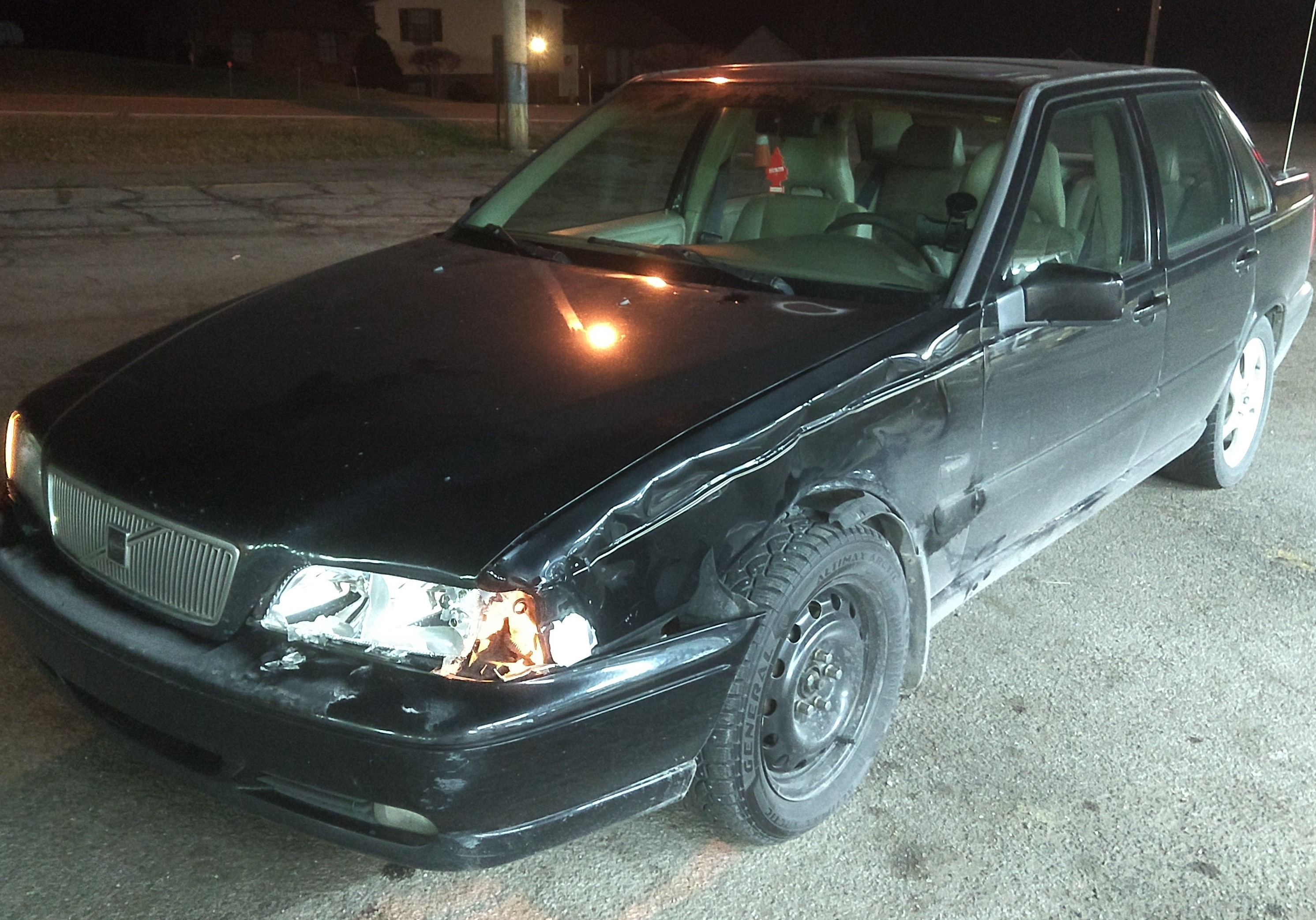

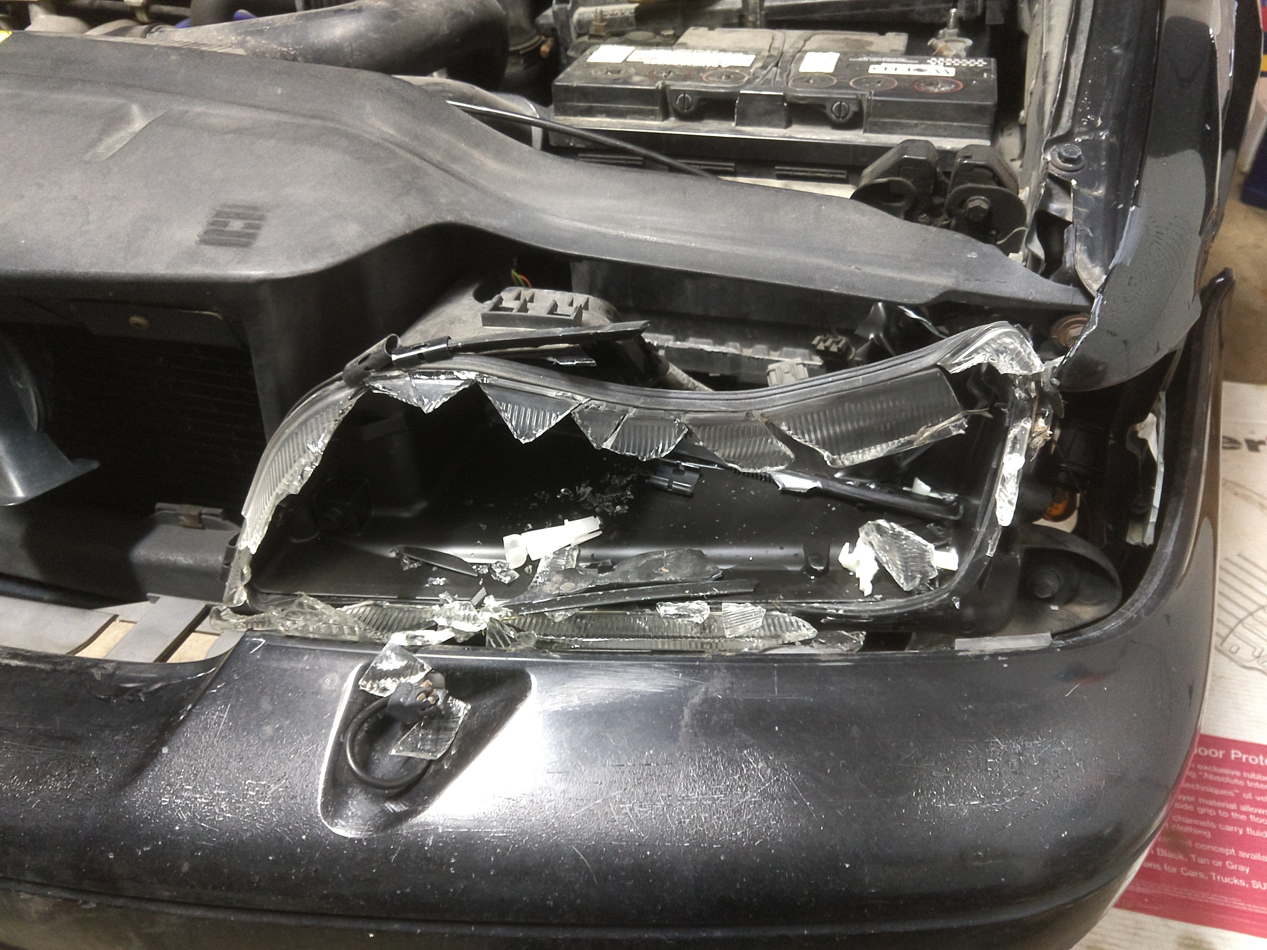

Well... it's been a rough few weeks. In short, I hit a deer at 45mph in a freak and totally unavoidable accident. But never fear, my beloved T5 still lives... she just looks a bit different. I'll try and get the pics off my phone later. Damage report: Hood, driver's side fender and lights, a steel wheel, the fiberglass rad support thing, and the bracket that holds the bumper to the fender. If anyone's got anything for sale or to donate, send me a PM. Car is stone black 019.

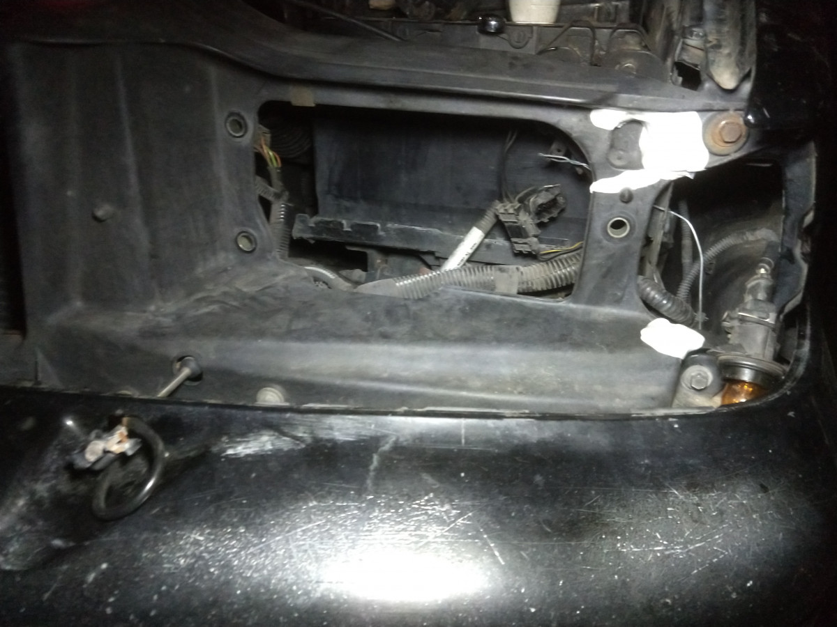

I ended up grabbing the dinged up and rusty fender off my '99 parts car. Sourced the fiberglass rad support semi-locally, but ended up using JB plastic weld putty to hold mine together after seeing how much work it was to swap (junkyard car was already relived of everything in the engine bay: easy grab). Took the hood off and got mad at it with a 15lb sledge until it would close with a driver's side headlight installed. bumper bracket is till broken, but everything is back together to a depressingly satisfactory degree.

That damage doesn't look too bad, fortunately. Easy enough to fix, just time consuming taking apart the front end to replace that radiator support!
