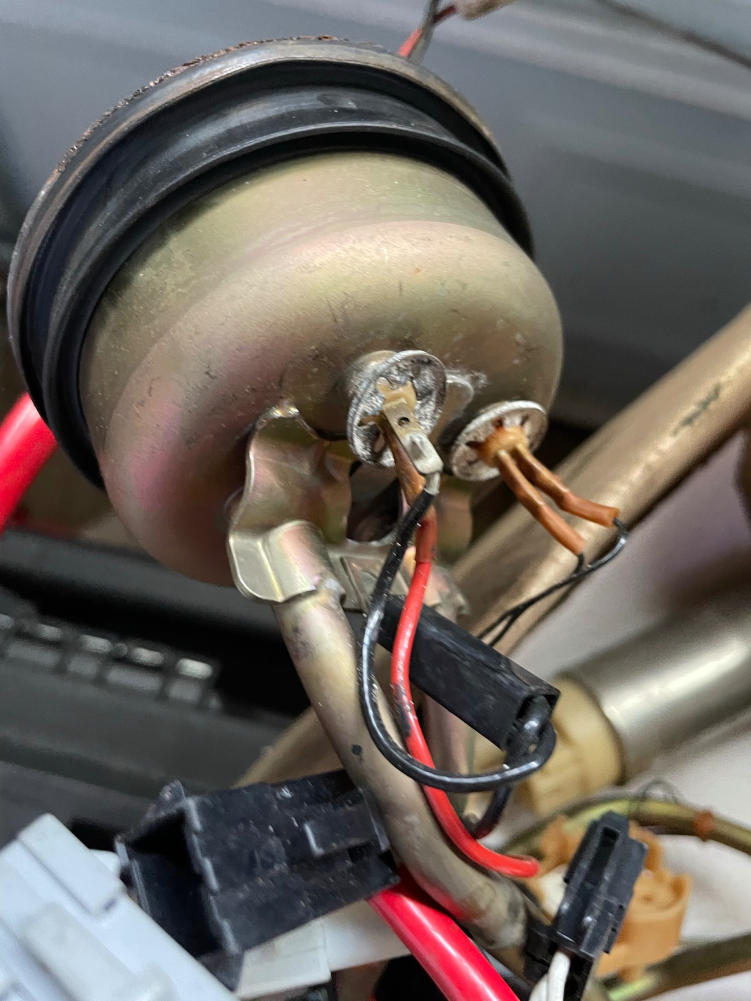

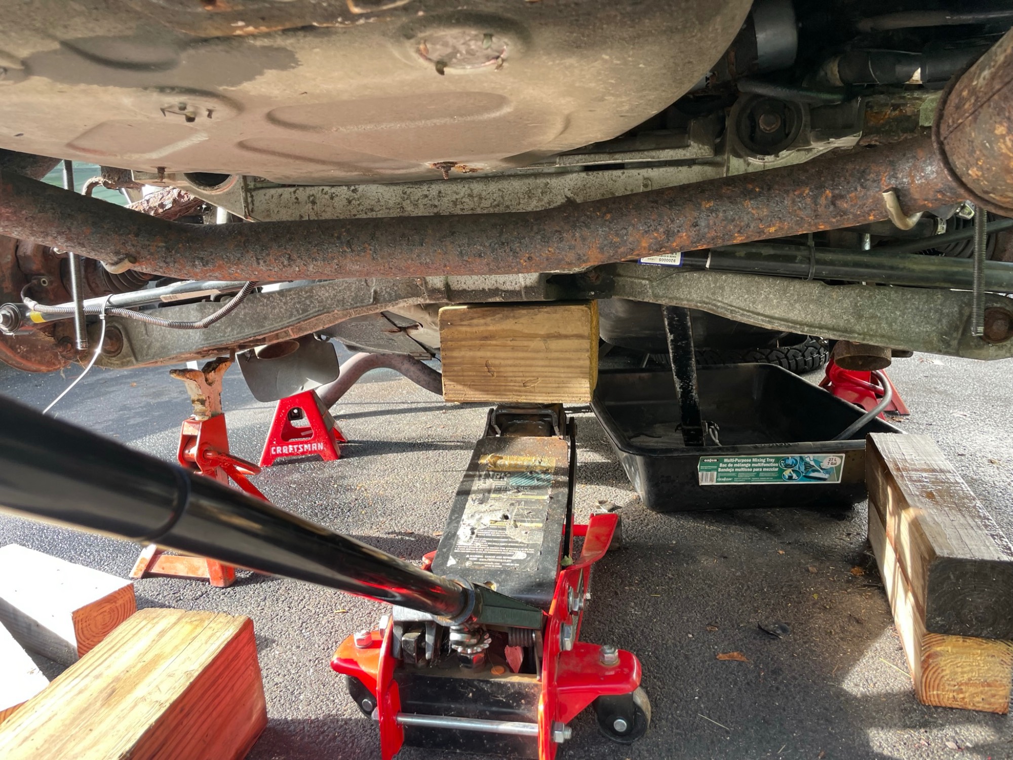

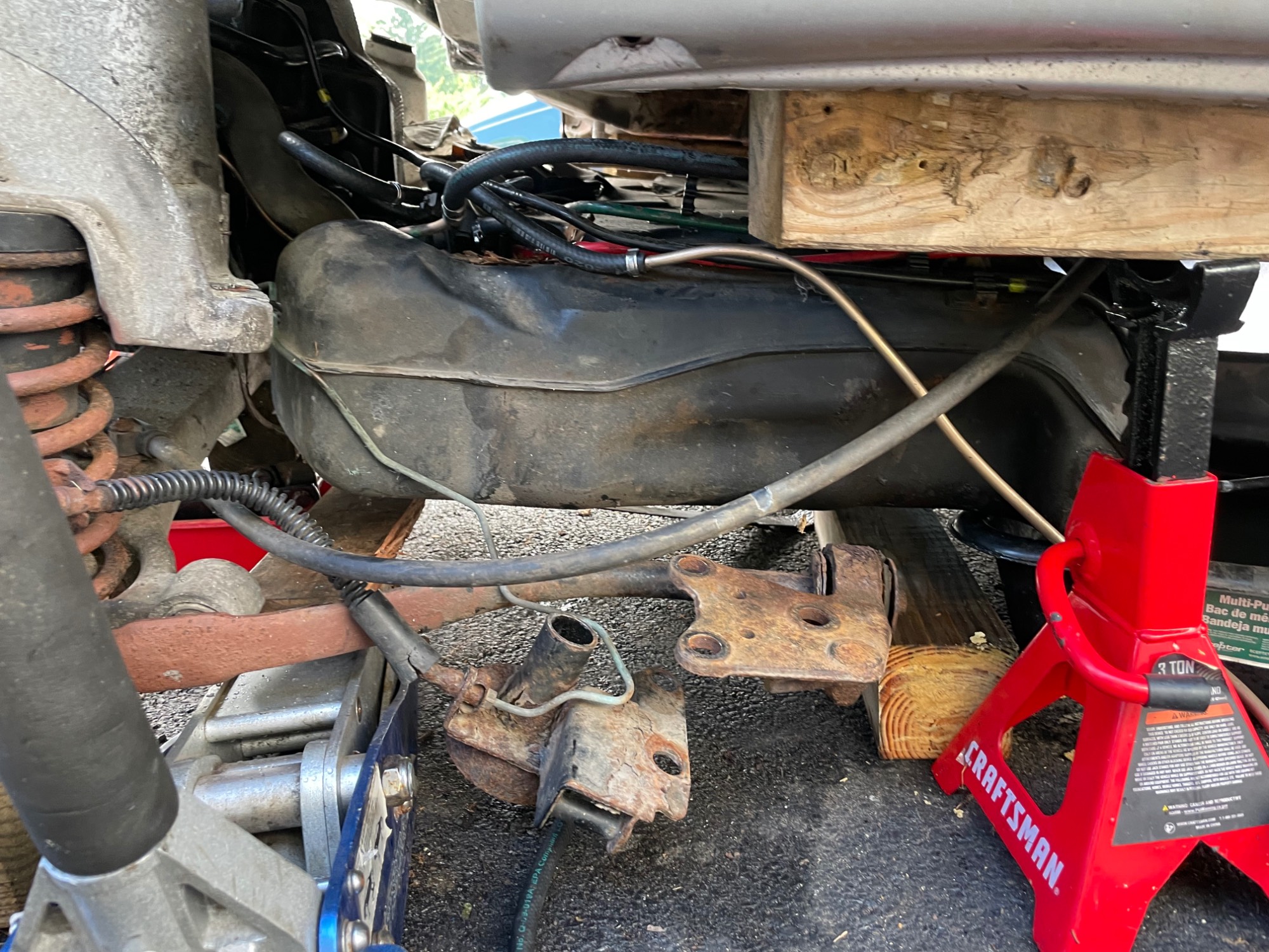

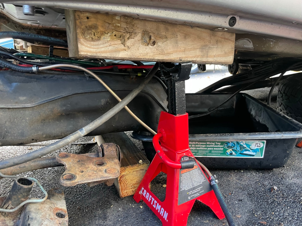

When I replaced the fuel pump on my 99 v70xc, I did the partial-tank-drop using Robert's video as guidance. I dropped the tank three times in one weekend because of f' ups and overlooking things. The first time took me about 12 hours...then it it got 50% quicker each try. Have plenty of jacks. Have a couple of bottle jacks to lift and tweak things when needed. The bottle jacks when used along 1x lumber will help push the tank down and lift other suspension stuff. I also had to use my extra long screwdriver to fish and maneuver the cable...it will get stuck at the FPR clip and other clips. It seems like most instructions will give you the general plan on how to do the job but it is all about the detail that will either make the repair a struggle or not. Repairs on my Toyota Corolla and former Jeep were very straight forward. Being a new Volvo owner, I've noticed that there's a lot of "special tricks" and maneuvers that need to be done when working on one.

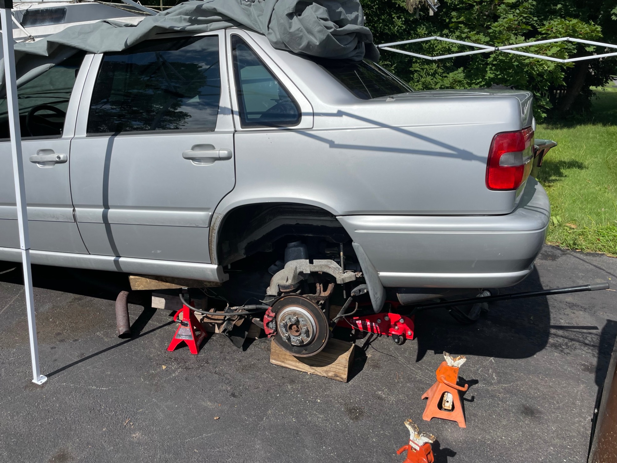

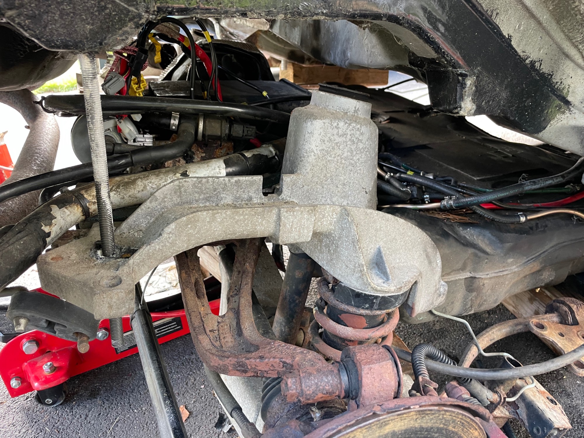

Wrap up. The trick of buying two 30 cm m12 threaded rods from McMaster Carr and using them as guides made the full axle drop and install only a 2 hour affair.

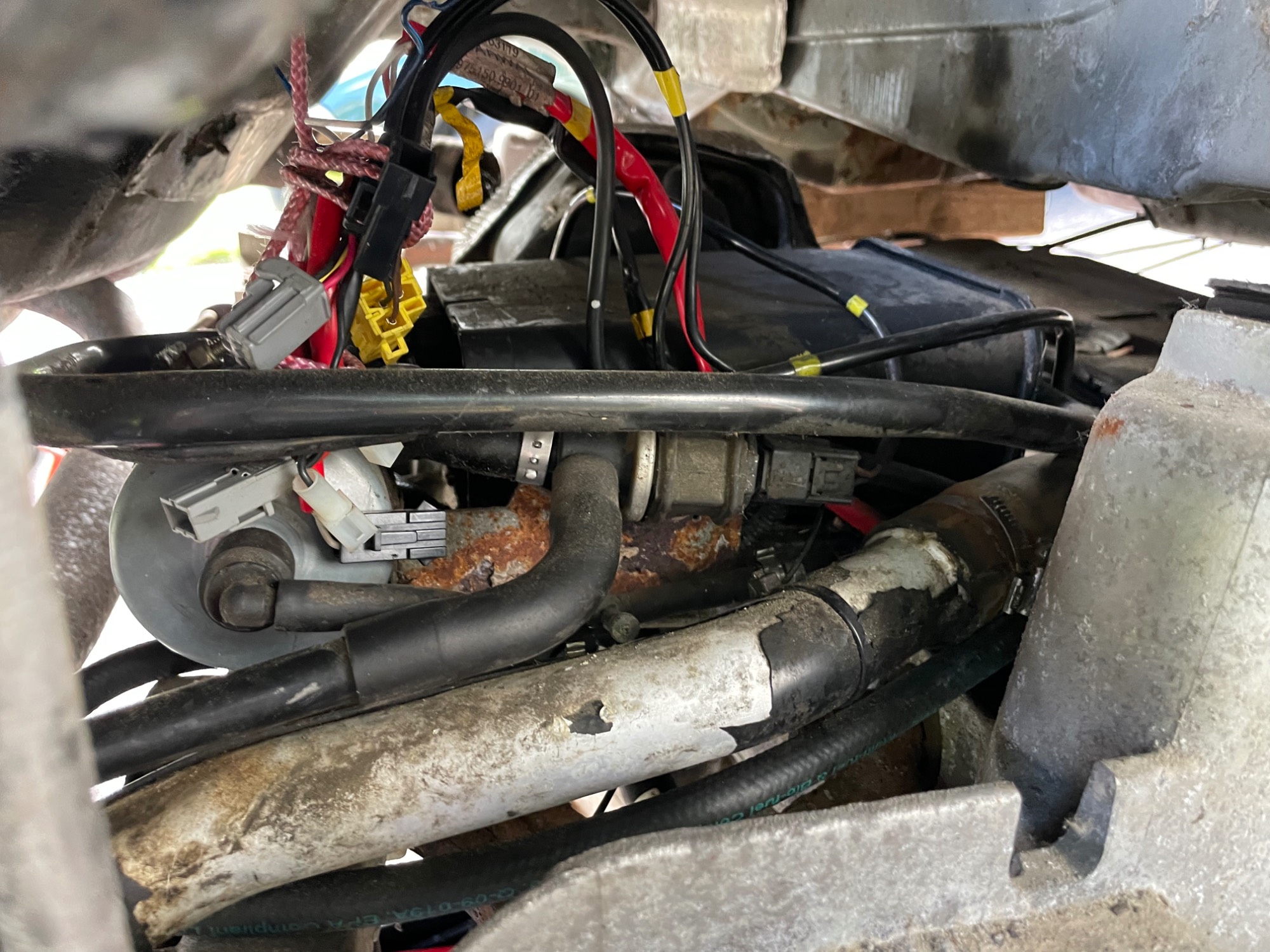

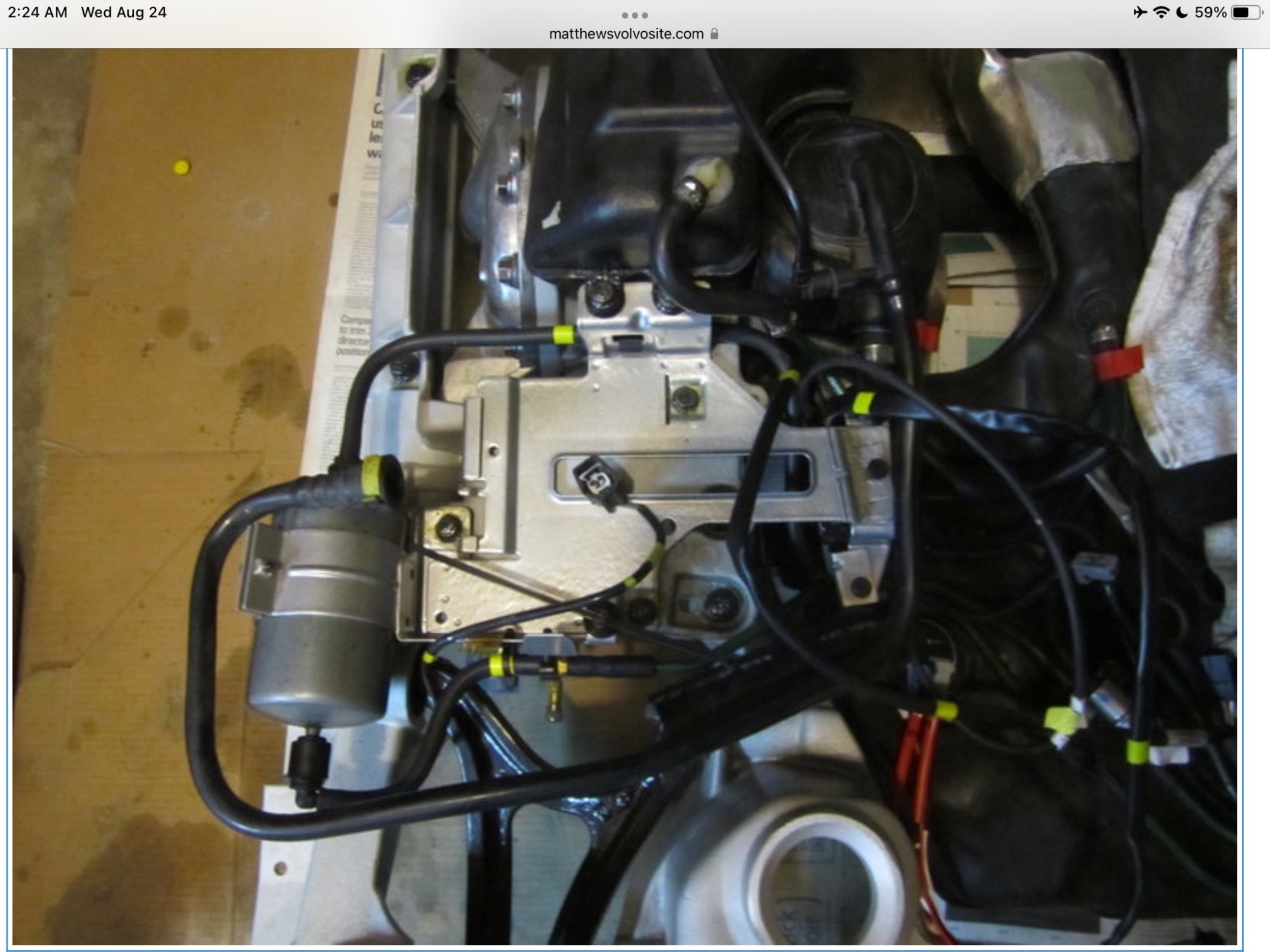

I eliminated all the fuel hose from my tank while down except the bridges between CuNiForm and components. Trying to eliminate stuff for critter munchies, got all hose lengths down to 5 cm or so, double oetiker

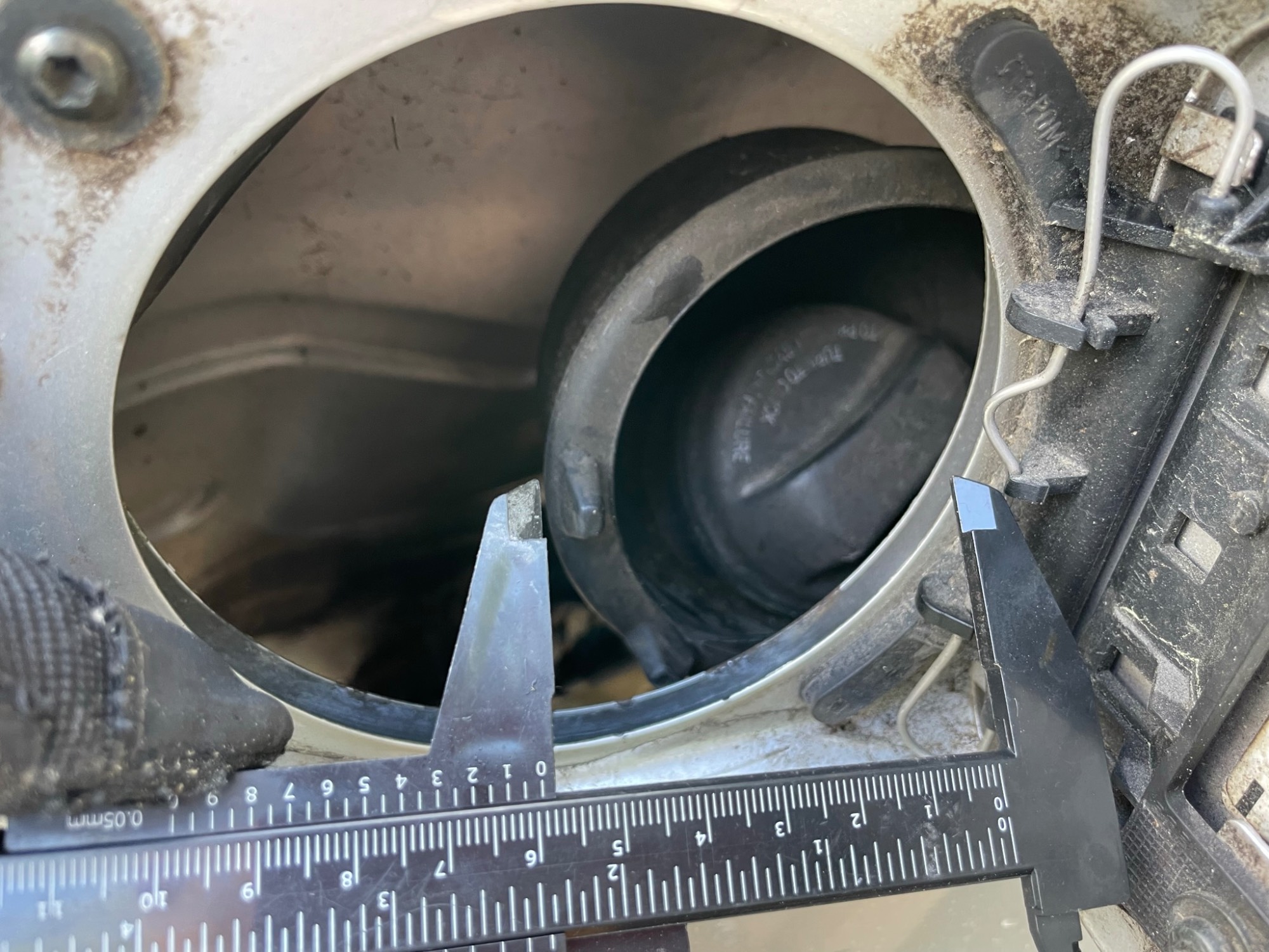

Got the fuel gaiter installed. You have to twist the pipe on the tank hard to ccw direction looking down from rear. A small change here of a cm position on the rotation will move the fuel fill gaiter 10-15 cm where it won’t fit back on the body
Took her on her first 100 mile trip away from home. 27 mpg and smooth as silk. Monitors finally went ready so I can inspect her.

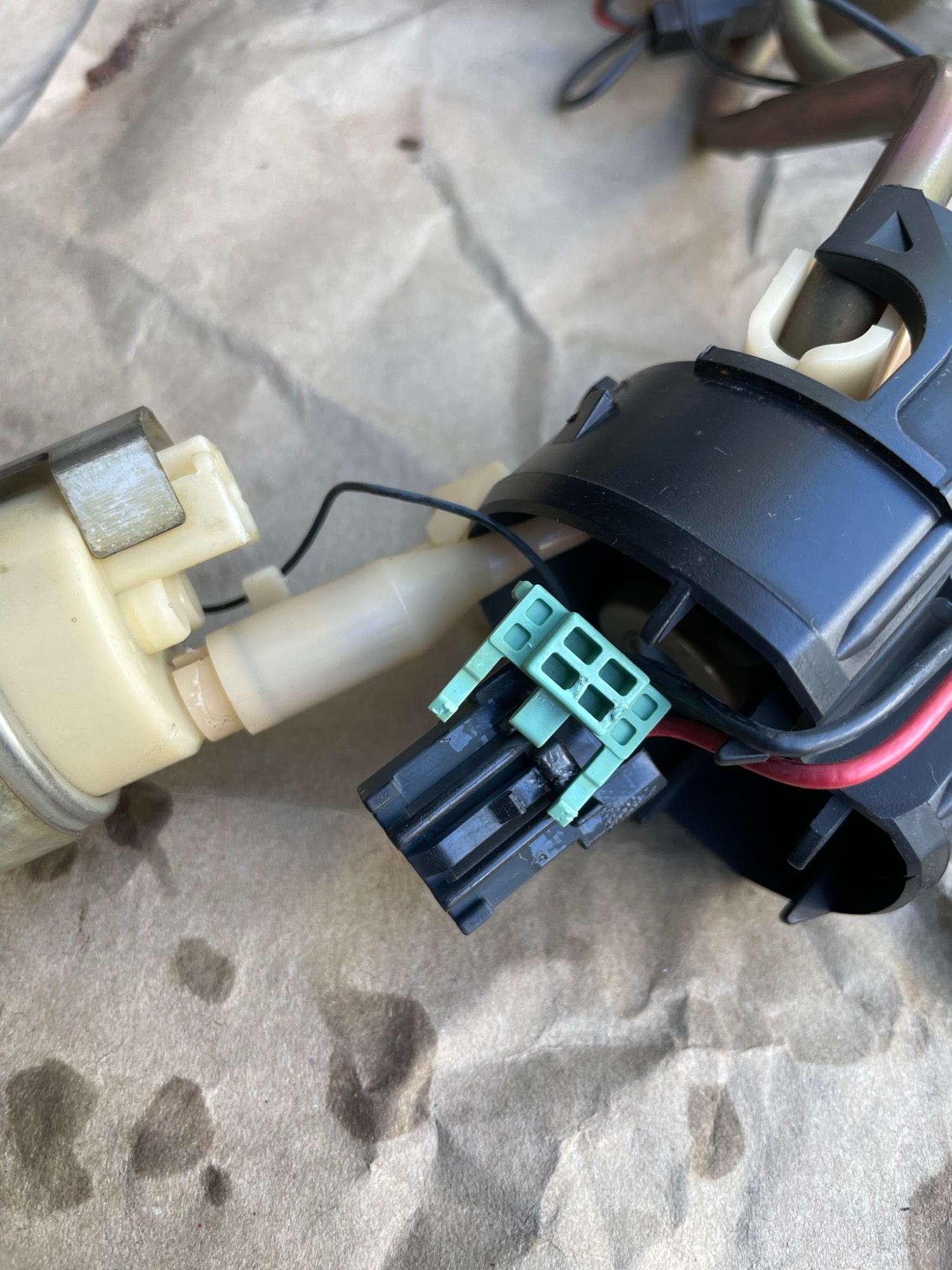

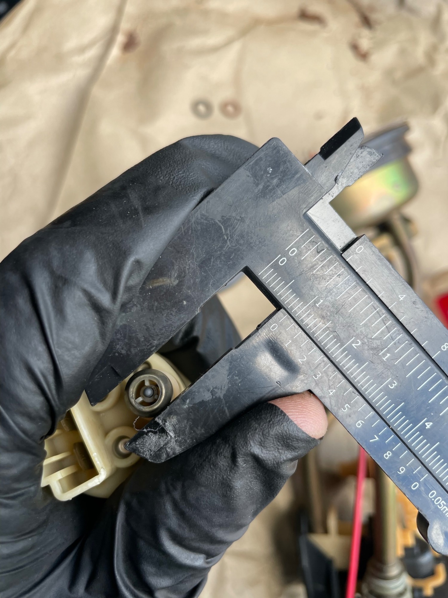

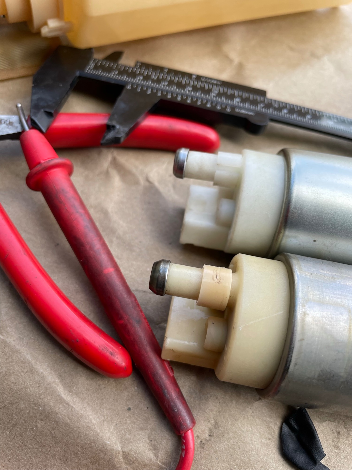

Picture gallery of repairs for reference.

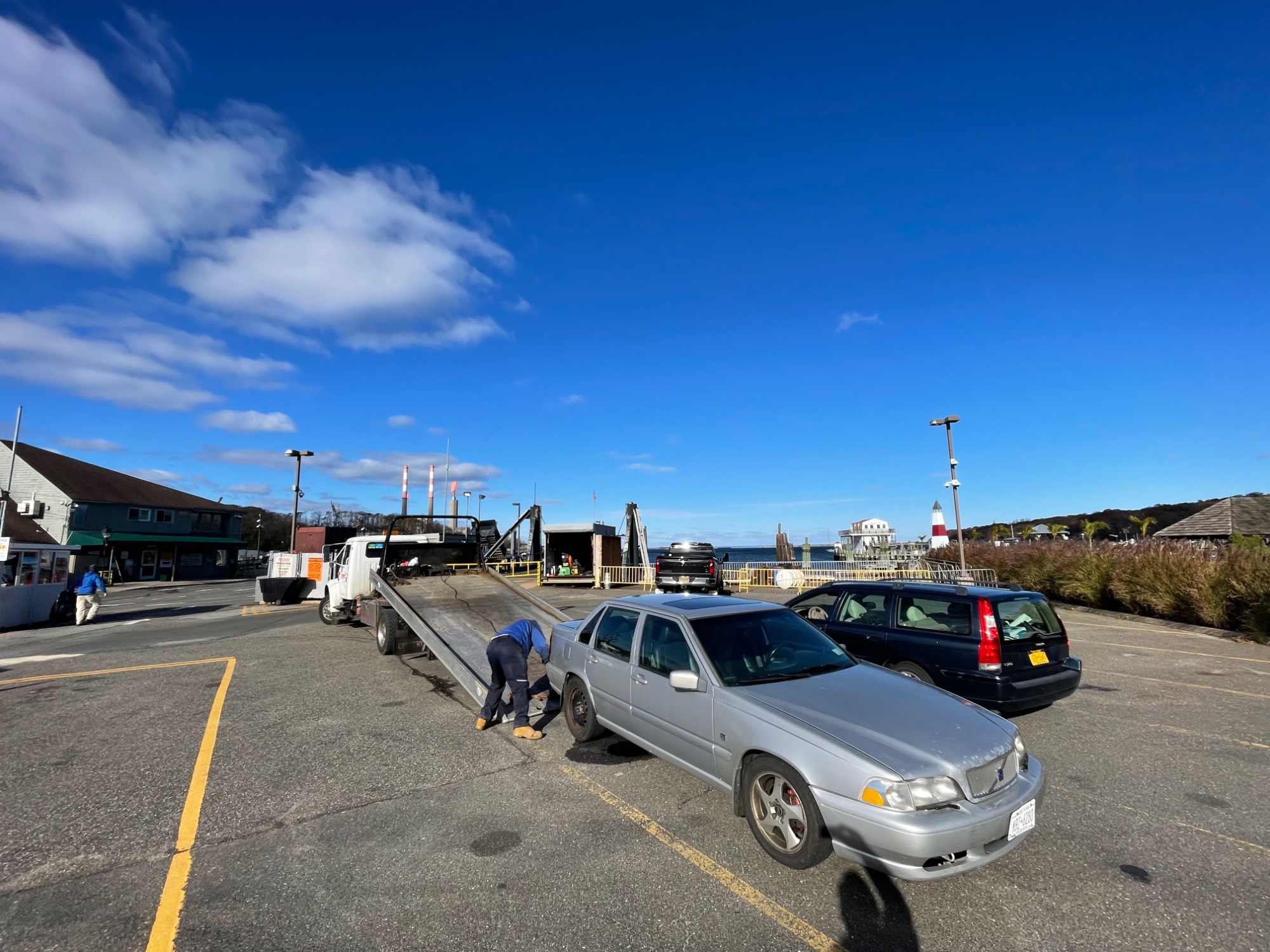

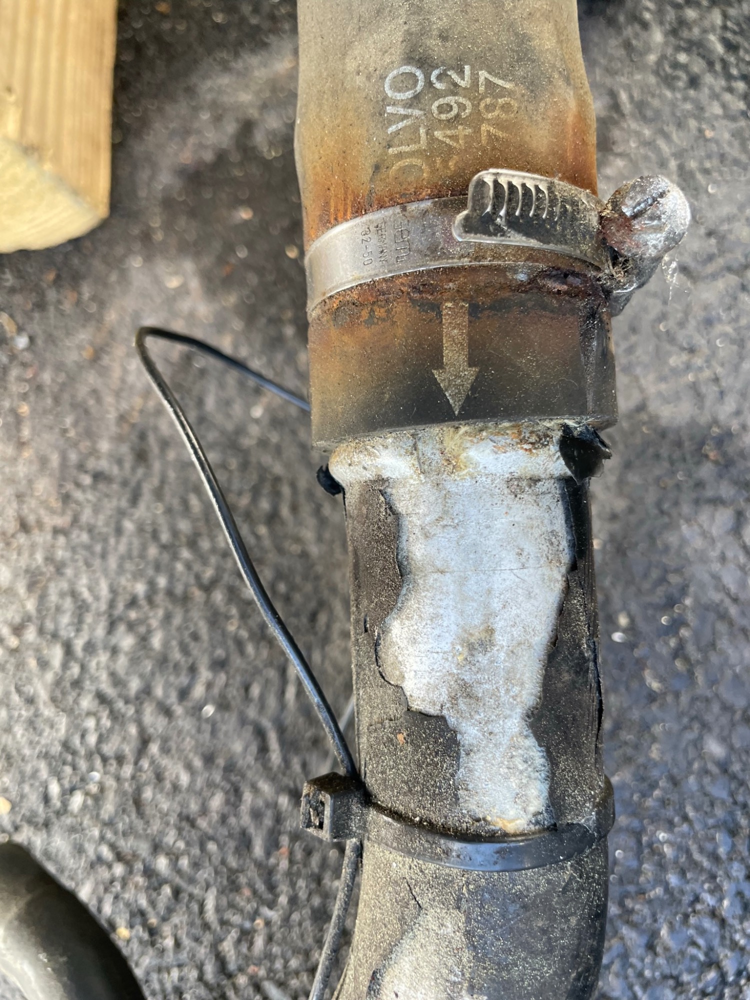

I got 5000 miles on her with great driveability, then the high pressure supply side blew off at my NiCopp hose and left me stranded. I got her towed to a great independent in Stony Brook, Munch Auto, and got lucky with a Swedish car guy who knew P80 Volvo
5 hours to drop axle and repair, at $110 an hour
He complimented me on my axle work but taught me two new things:
Roughen the NiCopp with a file to help the rubber bite into it
With a flare tool, put a small flare on the end to clamp and secure the rubber.
Gotta say it was a great deal to trade $500 for a 3 hour dolly tow back to Albany plus wrestling that axle gorilla in the driveway
