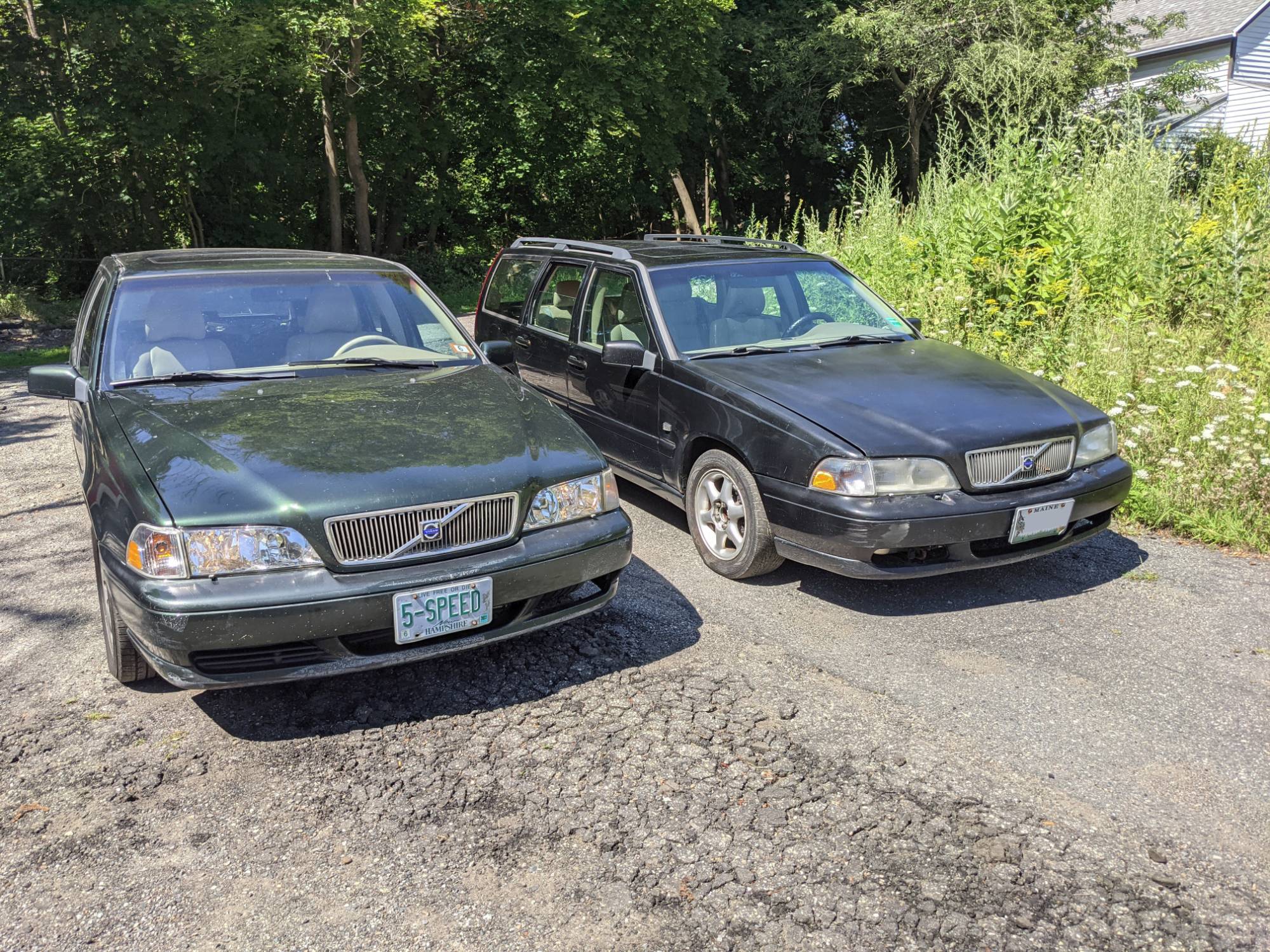

I'm now the proud owner of Geronimo with 357k miles. Poor thing drives terribly but the DTC codes reveal whats wrong. It's just a matter of replacing the parts. First step, a used coil pack fresh off the express train from Albany.
The front wheels got quite hot after a 30 min drive. Their center caps are removed so I could feel that the axle bolts were even hotter. Yes, it's 92 degrees and sunny today. The front right wheel bearing is very loud. I don't think the calipers are dragging (one new, one recent and tested good). Could friction from the wheel bearing cause so much wheel heat, on both sides?
VIDA says it can't communicate with the climate control module. But the climate control is manual so does it have a CCM? It worked six months ago. Maybe a fuse blew, but I wonder what blew it.

After making a foolish attempt to repair a power steering pressure line, I replaced it with a used one. That line must have been leaking for years considering all the filth I cleaned out from under it. Steering is still stiff when turning while stopped but works when I'm moving, so that's the next concern.
Next job is to replace the front wheel bearing which is spectacularly failed. Last month when I tried to replace it, the final bolt of the wheel hub was rusted in place and wouldn't remove, stripping the head. I had to reassemble everything with the hub not replaced. Next week, I'll try again to get that darn bolt out. I may have to buy a blow torch because I can't seem to find one in the decently stocked Makerspace.
With these two jobs complete, the car will at least be safe to drive around town. I may have to sell it in this condition instead of repairing it to pass inspection. Sad to say, but I'd rather put my time into preparing my 2000 V70 for sale and rehabilitating the new T5M.
