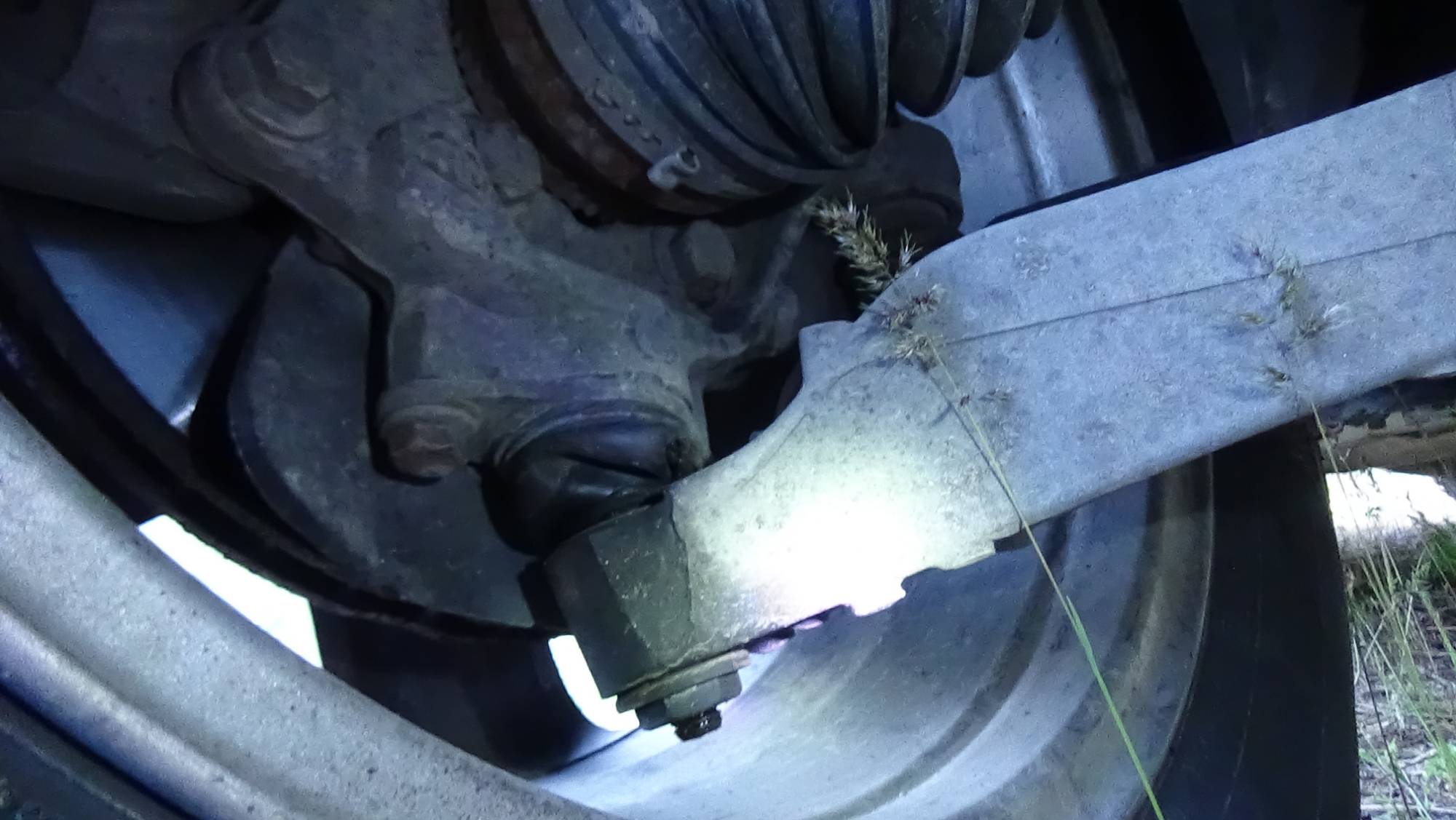

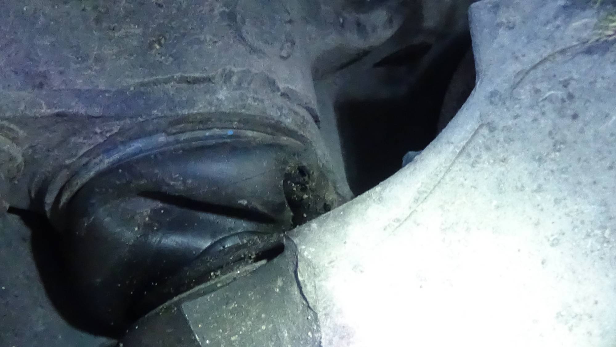

I looked at the bushings, and found this.
It looks broken, so would this be making the noise? What is it called, and how would I replace it?

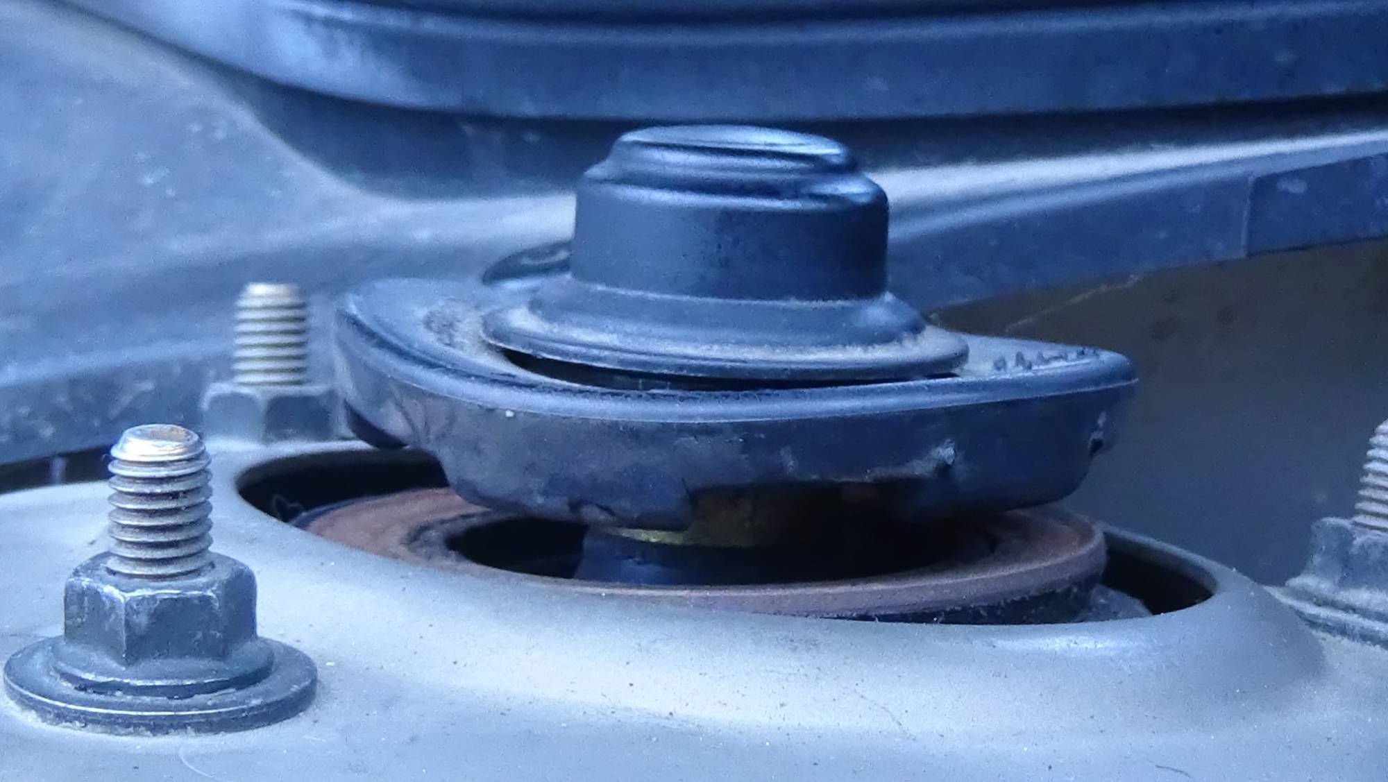

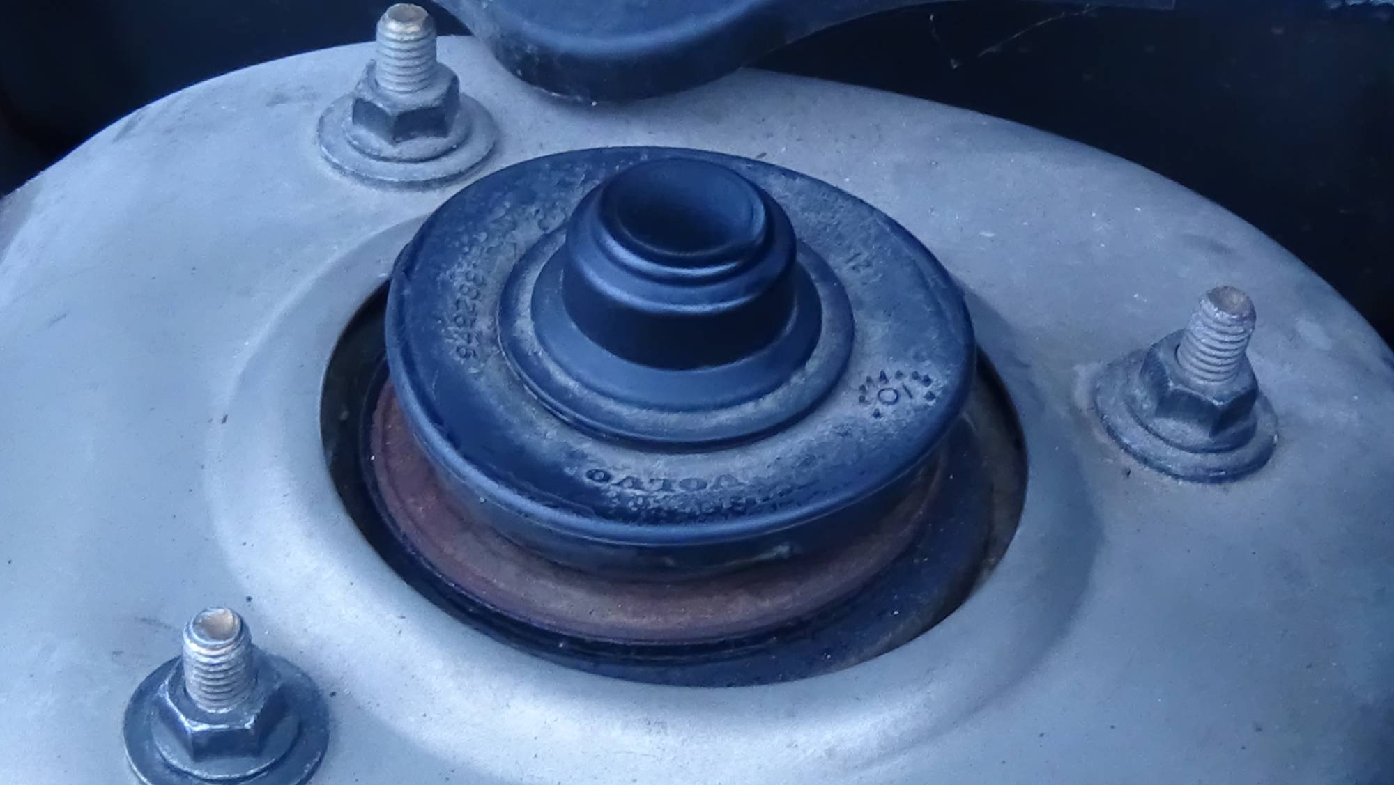

Also, this is what the top of the strut looks like is this normal?
The other side looks similar.

It looks like you need new strut and ball joints, both sides
About $500 in parts
$500 labor, except in CA, where it will $900 labor

Smells like front suspension rebuild coming soon. It is actually not difficult, maybe 5% of your engine adventure. Need a good clamp-style coil compressor, ~$90 on ebay. FCP has a kit with all the hw needed, around $600.

Do I need to get new coil springs too? Or does the strut include that?

No - the springs come off the old strut and go back on the new one, with a new bearing / seat on top.

Curious how did you guys diagnose the strut? The balljoint looks obvious to me. But I haven’t seen the video.
You need to get new upper strut mounts too since you’re already in there.

I am replacing the lower ball joints, and it looks like some of the bushings for the lower control arm are not good. Can I replace the control arm bushings by themselves, or should I just replace the whole control arm?

I believe it’s…..
Aluminum control arms, replace bushings/ ball joints
Steel control arms, replace in whole.

On my P2 I installed alum control arms with bushings, and a new balljoint. All ipd HD kit.
