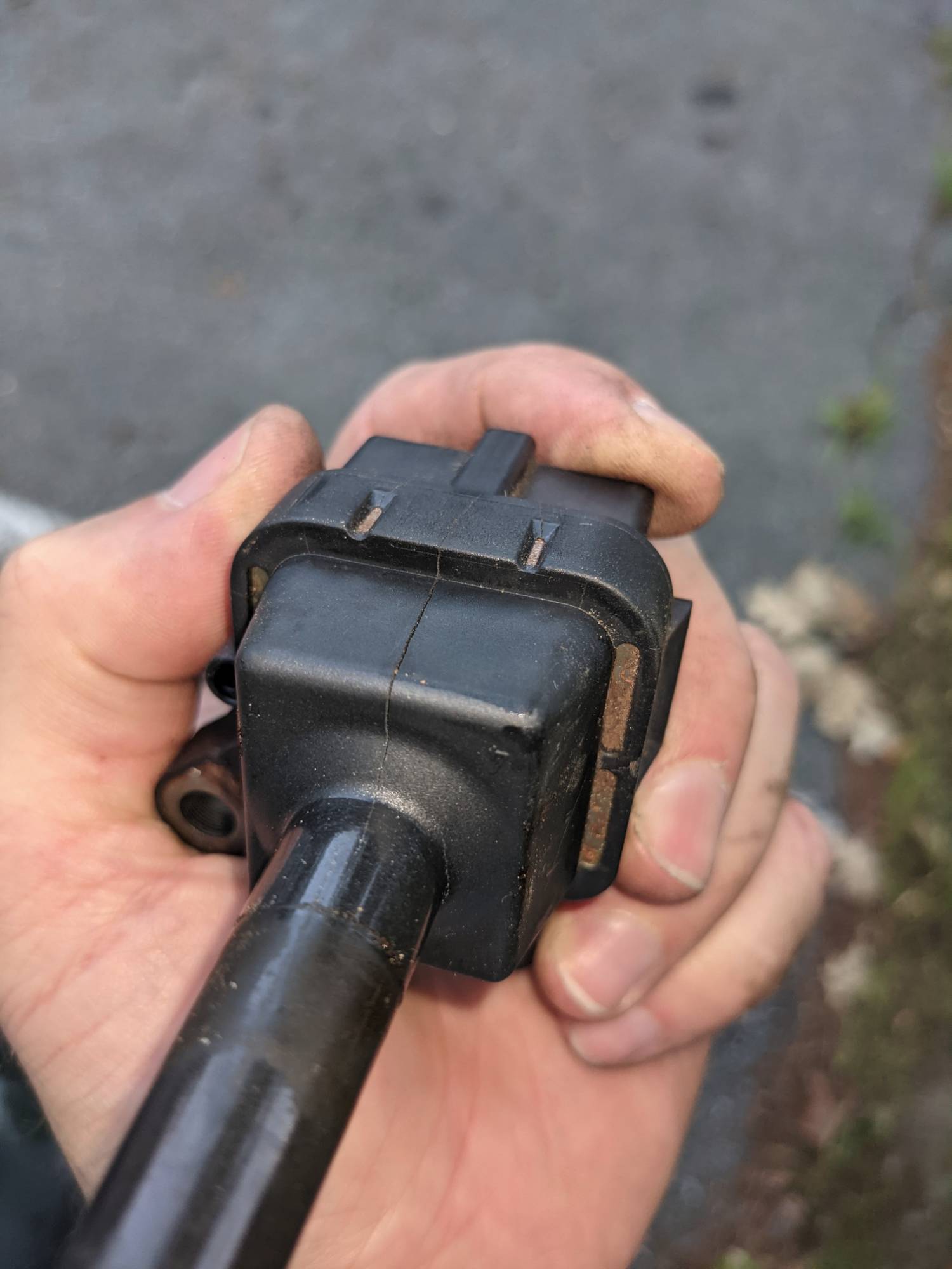

My 2000 V70 with 226k miles started idling rough accompanied by P0301 Cylinder 1 Misfire Detected. First thing I checked is the 22 year old original coils. Consensus on MVS is that they last a long time and we can swap in a used one when one fails. In a P2 forum post, precopster says "When the exterior casing cracks they misfire." Do you think 20+ years is too long to run these coils, even as spares? Is it finally time to replace them with new ones when they fail?

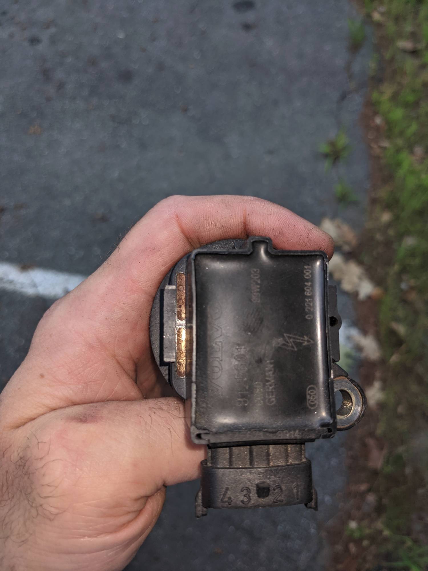

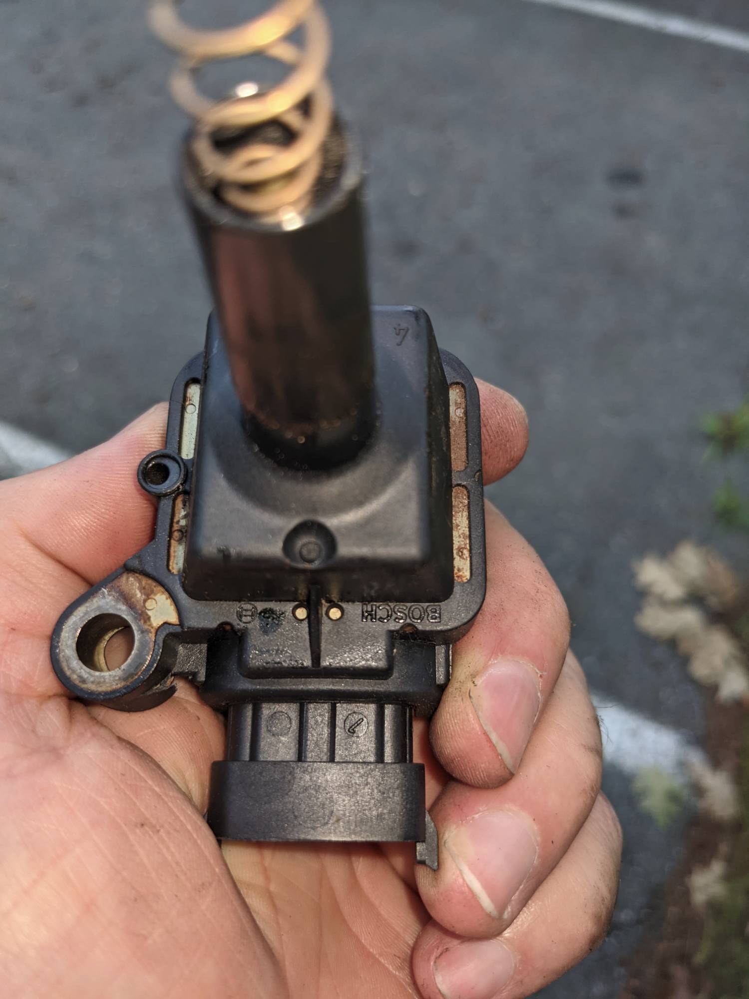

My misfiring cylinder 1 coil has a crack beneath the rubber boot. The other four coils have the same crack. The cylinder 1 coil also has corrosion on the metal visible on the underside of the coil. No other coils have that corrosion. All coils have corrosion on the metal on the top side of the coil.

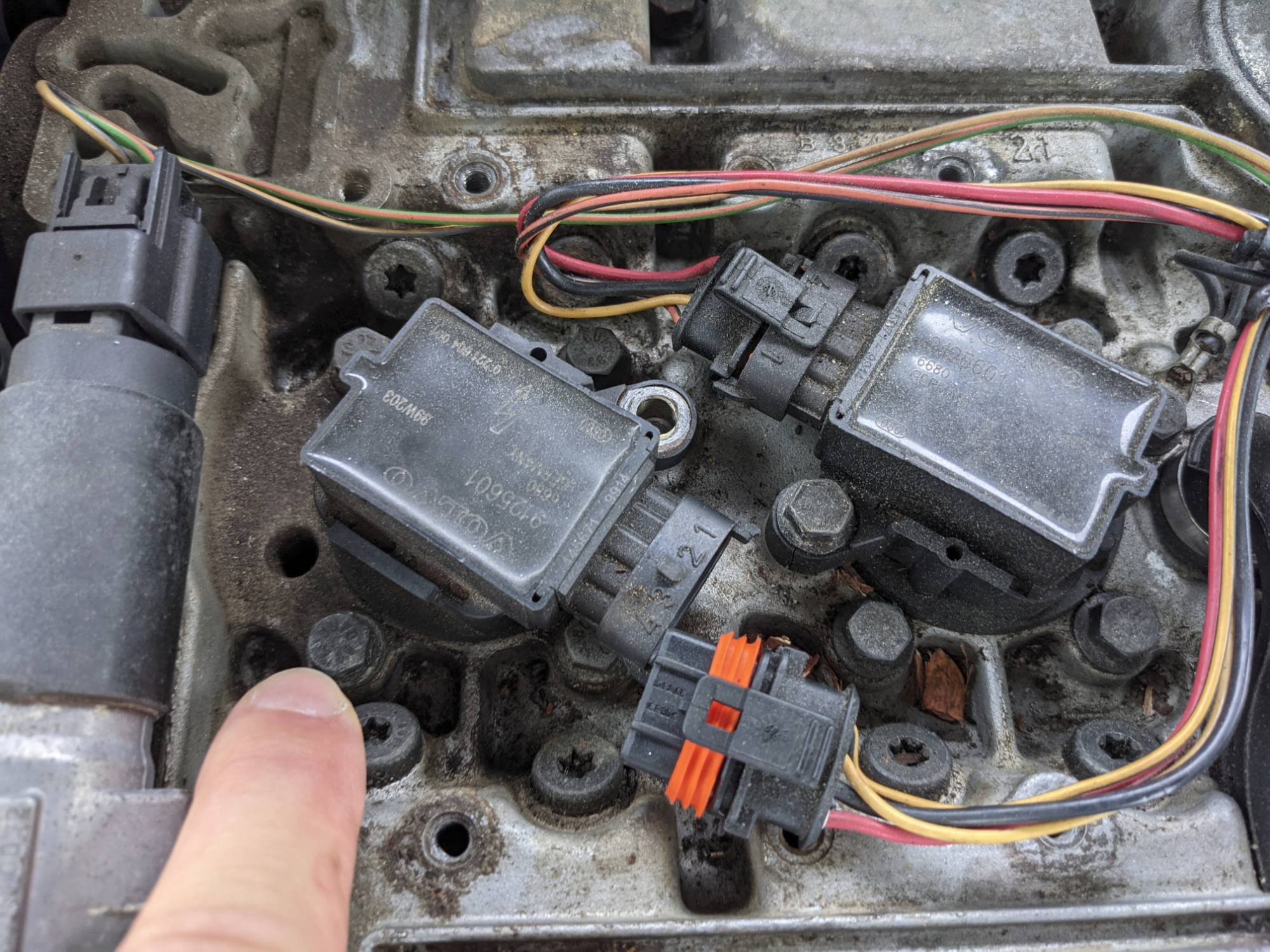

Side note, what's the torque spec for this top engine bolt? I removed it by mistake thinking it was a coil bolt. And what's the torque spec for coil bolts? All the Haynes has is "Engine top section to lower section - 17 Nm", and it suggests those are the outer edge where the grounding straps connect.

On the head cover bolt , just put it back in at 10 Ftlb. That’s a firm wrist twist on a 6 inch ratchet. The sealant keeps the cover on , not the bolts.

Once they crack they can run for a good long time but it is not a guarantee. I replaced my old 00 V70 base with new 'Volvo' OE (supposedly) from one of the online Volvo parts sellers. One was DOA. They did swap that and another that was damaged in the shipping. I sold that car to a buddy and about 2 years later #3 failed. He replaced that with a NAPA new coil and it failed again about 40,000km later. On removing it, it had rust on the coiled contact at the bottom and some sticky stuff on the underside from a crack. Swapped it again with a used Volvo stamped part with no cracked and all good again.
I did look to see if I could find a high temp., non-conductive epoxy that I could glue the cracks with to prevent them potentially worsening or shorting. No luck so far!

Years ago I read about a guy who rebuilt coils for Ford Flathead engines. These coils were of a unique shape and mounted on the front of the engine on top of the distributor. Purists needed good coils but want original looks. The guy would take old original coils and heat them for days to dry out any water accumulation. I believe he resealed them somehow after drying.
After this treatment they were often good for years.
How does this relate to modern Volvo coils? I think any cracks will allow moisture to enter the coil over time and start to degrade and short the insulation. In time the coils will fail. Efforts to seal the cracks should help.
