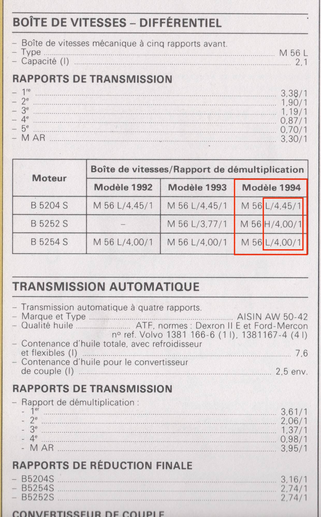

As you can see on the board, my engine is not named, it only speaks about B 52XX.
What do the numbers between slashes mean ?

The numbers are the rear axle ratio, or the final drive ratio in Anglais
Number of rotations coming from the gear box : a single turn of the rear wheels
A higher number means quicker acceleration ,a lower number gives better fuel economy.
You can calculate the total drive ration of engine revs to wheel revolutions by multiplying the gear ration and final drive ratio.
Your new homework…why is an automatic final drive ratio so much lower than a manual drive ratio?

Ok, i will study that more precisely. To come back to my question, as the GB is a M56, any GB stamped M56 will get then ?

On a front wheel drive car, the differential is built into the transmission. So, if you want an easier life, I would look at trying to find a matching transmission with the same ratios as yours.
I have to say I am surprised they had different ratios for the manual transmission/differential.

I'm afraid you may are right. But how to know this more level detail when i will buy another one ? In general, people write in their classified ad "M56", manual or automatic that's all. Where to find the precision ?

As it looks, the only parts available are the bearings (I have a list of them if someone needs them) and the seals. Syncro rings are not available, and nothing else.
Any M56 will fit any 850. The turbo M56s are said to have a strengthened 3rd gear according to german speed freaks. Swedespeed frequent swappers in the US claim there is no difference. But for a NA car, it doesn't really matter. One important thing though: from 96 onward the vehicle speed was calculated via ABS, before that there was a speed sensor in the tranny. So you need a 92-95 tranny for your cruise control to work.
Your flag indicates you are from Europe. If this is true, try bildelbasen.se (i hope i typed the name correctly, if not google will help) for sourcing a used tranny. Bildelbasen is a network of scandinavian junk yards, they have tons of Volvo parts listed. My m56 out of a running 96 T5M was less than 400 Euro including shipping, if I recall correctly. And this is a good price for Europe.
If you want to get the swap done fast, get a used tranny, replace the bearings and seals while you're at it (or have a shop replace the bearings for you) and then swap everything over.
If syncro rings are shot, you need to get ones out of a working M56. You supposedly can use them out of any M56.
