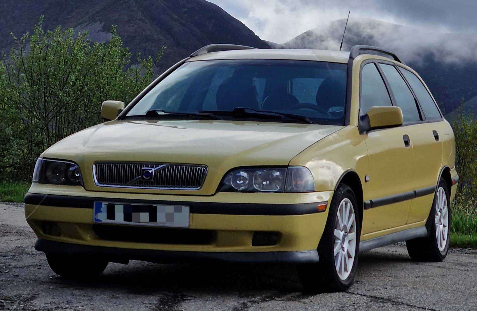

Also, here it goes a photo of the car :)
20230426_185159 (1).jpg (243.87 KiB) Viewed 2474 times

Hi Eddy, thanks for joining. You've got a rare color on that V40, very pretty. I understand completely why you want to do this restoration. My mom had a 2000 V40, silver, and I liked it.
I'd start at Stage 0. Then work on the rest. You want to divide this project into manageable chunks.
Here's my musings on the Panama paint. That article is incorrect on the Volvos that had a pale yellow paint option... in addition to those I listed, there was a 240 color that is similar. I need to fix that.
