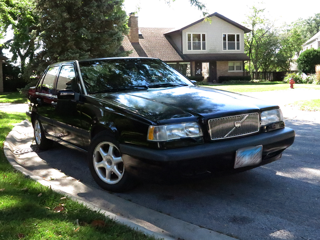

This was our 1997 850. I've many usable new and used parts; NOT junk. I'm happy to box and ship it to you for $1!nesman321 wrote: 15 Nov 2023, 07:59 I was wondering if you guys could help me try to figure out what going wrong with my car.
you would do that I would be grateful and that a nice looking 850 looks like mine but in a nicer condition
