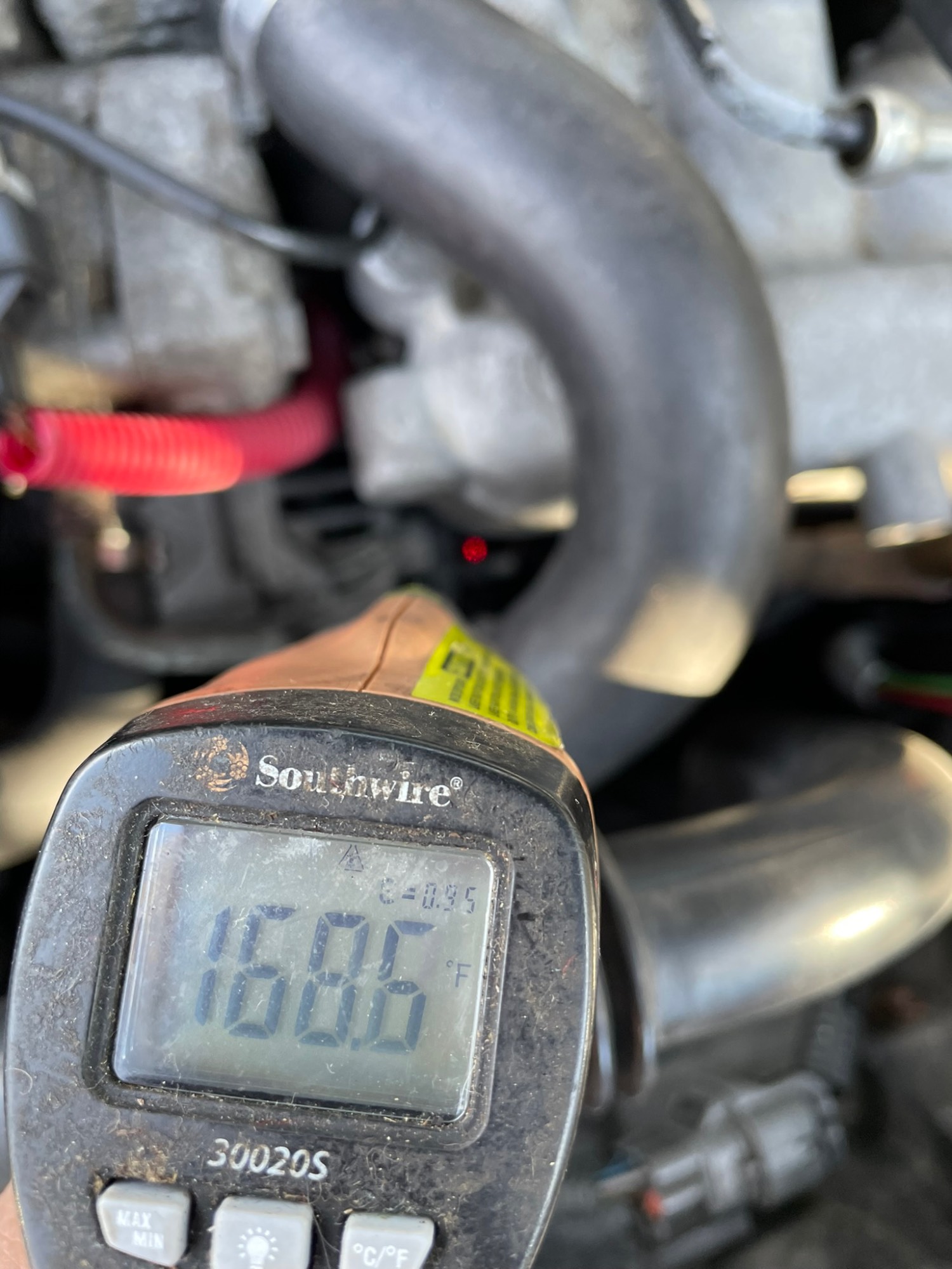

When I make a store run later today, Ill make a temp measurement on the 1999

15 minutes with the high beams on for load,,,170Fabscate wrote: 02 Apr 2024, 09:47 When I make a store run later today, Ill make a temp measurement on the 1999

Anyway, to answer Abscates question on temperature, so far after a 30 minute run it measured at 176F. That was in daytime. Last night the owner took a run out of town for about a 45 minute run and it measured at 172F.
The engine bay and position of the alternator makes it sit in a poor airflow area above the AC compressor and just around the corner from the turbo which is on the back of the motor at the same end. The huge air intake also reduces air flow. I'm now thinking that putting the IPD skid shield back on, especially in summer may not be a good idea.
