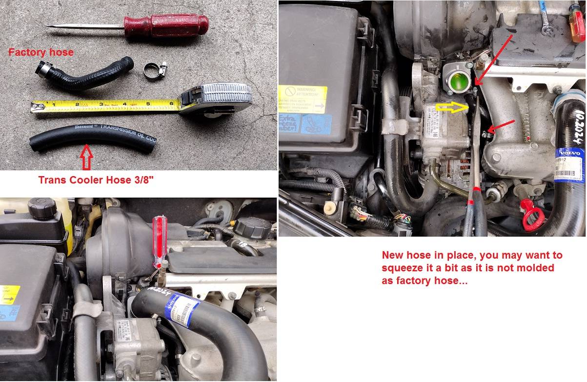

The 2006 S60 2.5T with 106K miles...I replaced the tstat preventively using Facet brand (made in Italy).
It works great but a few days later noticed coolant leak around tstat area.
Turned out the small hose is getting tired lol...
Tightend the clamp and it stopped leaking for a while.
But I wanted a permanent fix.
Went to O'Reilly auto parts, they told me Gates has not sent them heater hoses for months lol!
Went home and used the Trans Cooler Hose (3/8-inch type) I had lying around.
Tricks:
1. Definitely need the 7-mm wrench for the large rad hose clamp.
2. Remove the Large Hose on the tstat side only (no need to remove the rad side), life will be MUCH easier.
3. The length is ~ 5 inches long.
4. Use a socket to enlarge the hose inside diameter a bit bc the space is tight.
5. Gently pry the factory Oetiker clamp and throw it away. Use new clamps.
6. Pour a cup of water to clean any spilled coolant (cover alternator with some plastic to avoid water
running into it).
7. The generic hose is not molded to S-shape, but it will work.
Just gently squeeze it a bit and watch it in the next few weeks to be sure it is not kinked completely.
Of course, the coolant flow is not as good as factory hose (bc factory hose is molded for the S-shaped curve),
but this is good enough to stop the leak.
8. Also, position the clamp in such a way that it is easy to access later (such as tightening or removing it).
HTH...

Update,
This small hose...I used to have a mysterious leak, every few wks, the coolant goes down to Min. And this factory hose only leaked overnight when the engine is cold, drop by drop. So, if you don't use a flashlight and look down there, it is difficult to see the leak bc it goes down the engine block and splash shield.
Anyway, the new generic heater hose fix works. No more leak.
