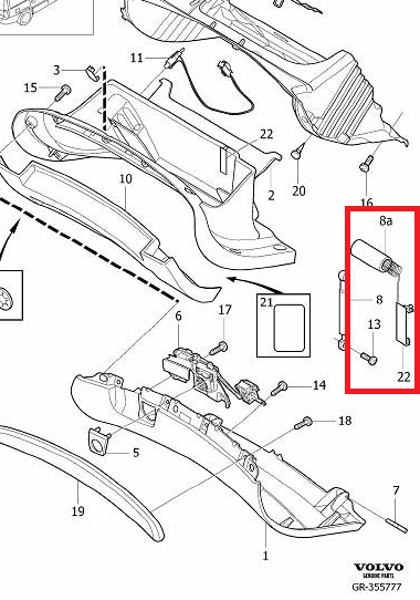

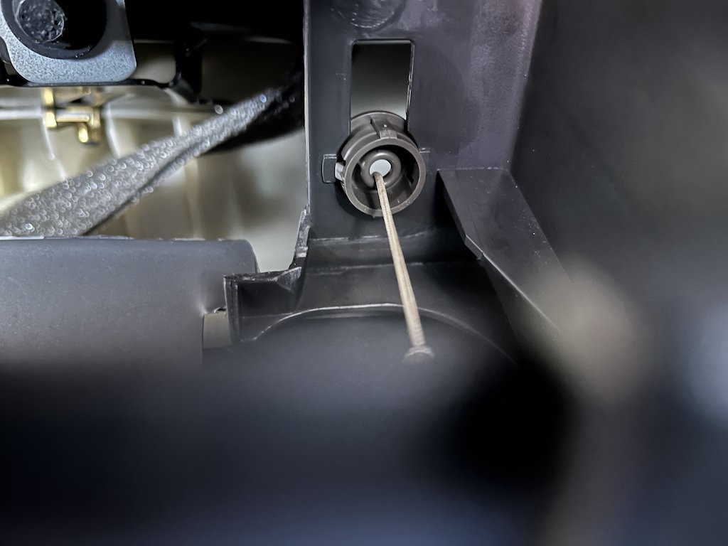

Recently my glove box door stopped openly fully. I wasn't able to get a good look at what was happening because of the lack of opening, but after some quick research on the typical cause and replacement procedure I ordered a Glove Box Support (9491713) off FCPEuro. The shock arrives and I go to do the replacement, and magically the glovebox opens normally for the first time in weeks. But the mechanism to slow open the glove box is significantly different than all the videos/guides/VIDA replacement instructions I've seen.
The mechanism on my V70 looks like this:
Screenshot 2025-03-31 083422.png (466.25 KiB) Viewed 432 times
Screenshot 2025-03-31 084320.png (134.21 KiB) Viewed 432 times
I haven't checked with any of the online Volvo parts suppliers directly yet to confirm, but it does not seem like that "absorber" (30643810) is available in new stock anywhere.
Does anyone have any knowledge about this glove box bit, where to best source a replacement (preferably new), or any info on how it can be repaired?

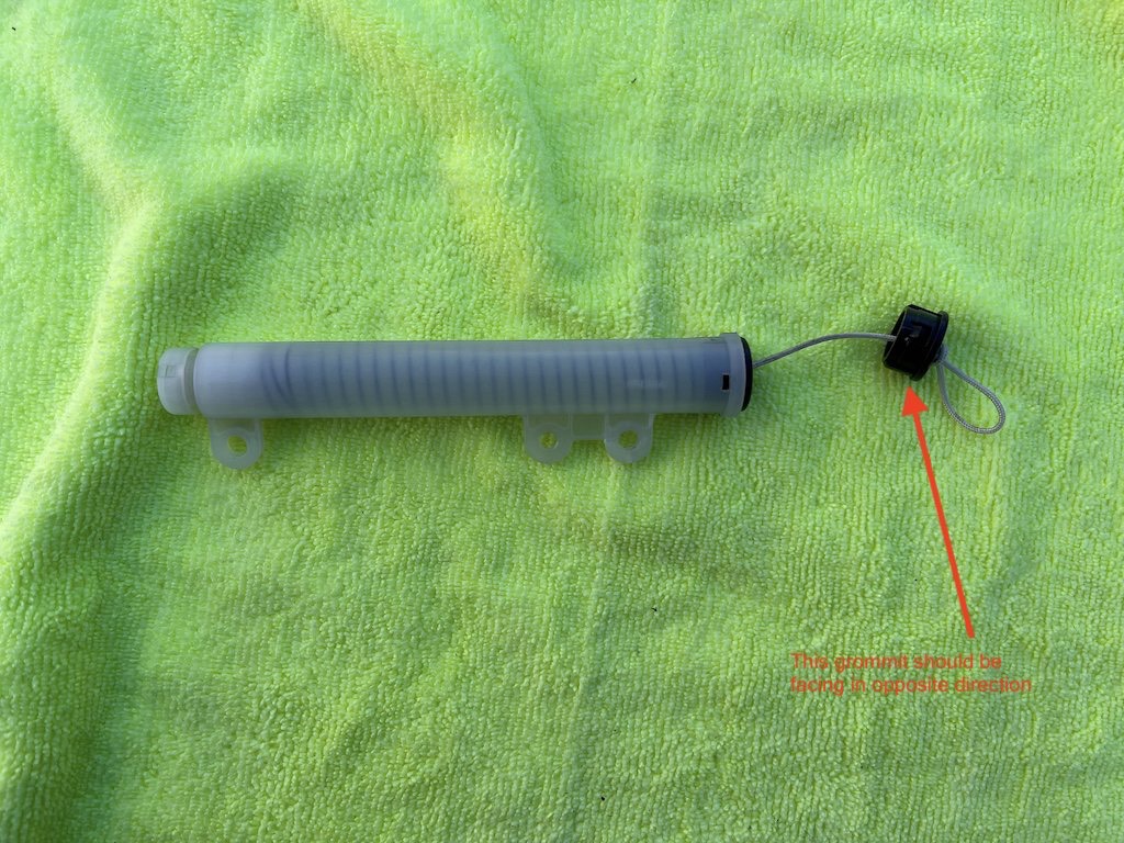

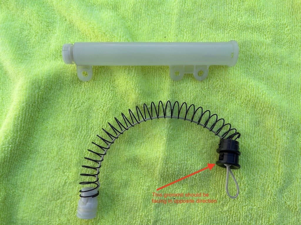

The chord is liable to breaking. It can be re-stringed but getting the correct tension takes a few attempts to get it just right
The plunger isn't the easiest of items to dismantle, the bottom part of the plunger is tricky to separate and requires gentle persuasion.
It took me several attempts with the length of the cord before I found something close to what it should be. I settled for 195mm between the knot and top of the loop
All back together and ready to refit. Note I fitted the grommet incorrectly in this picture it should be facing the opposite direction
Grommit is inserted from behind
Now works as it should
