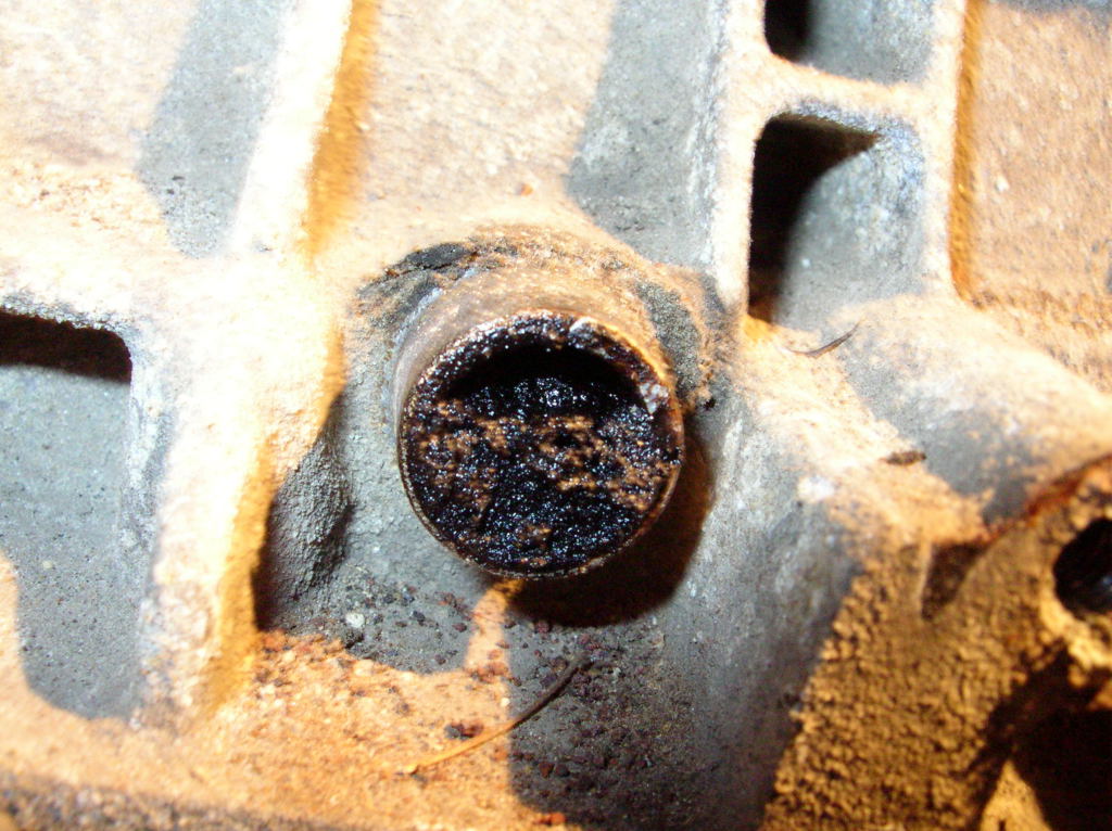

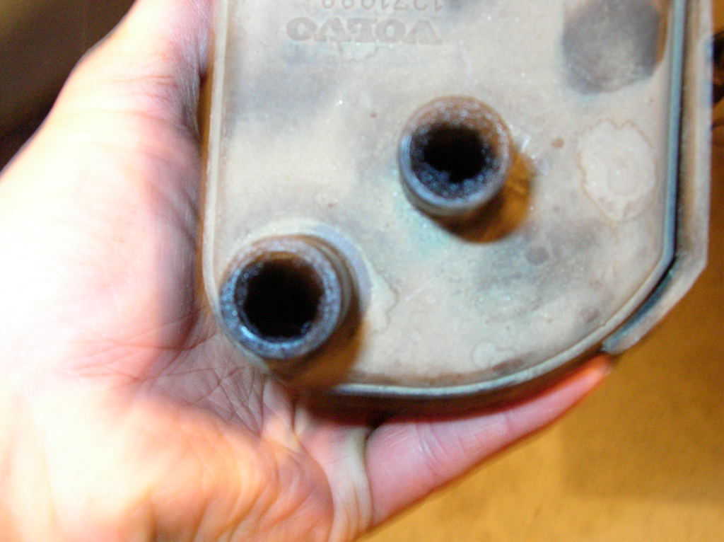

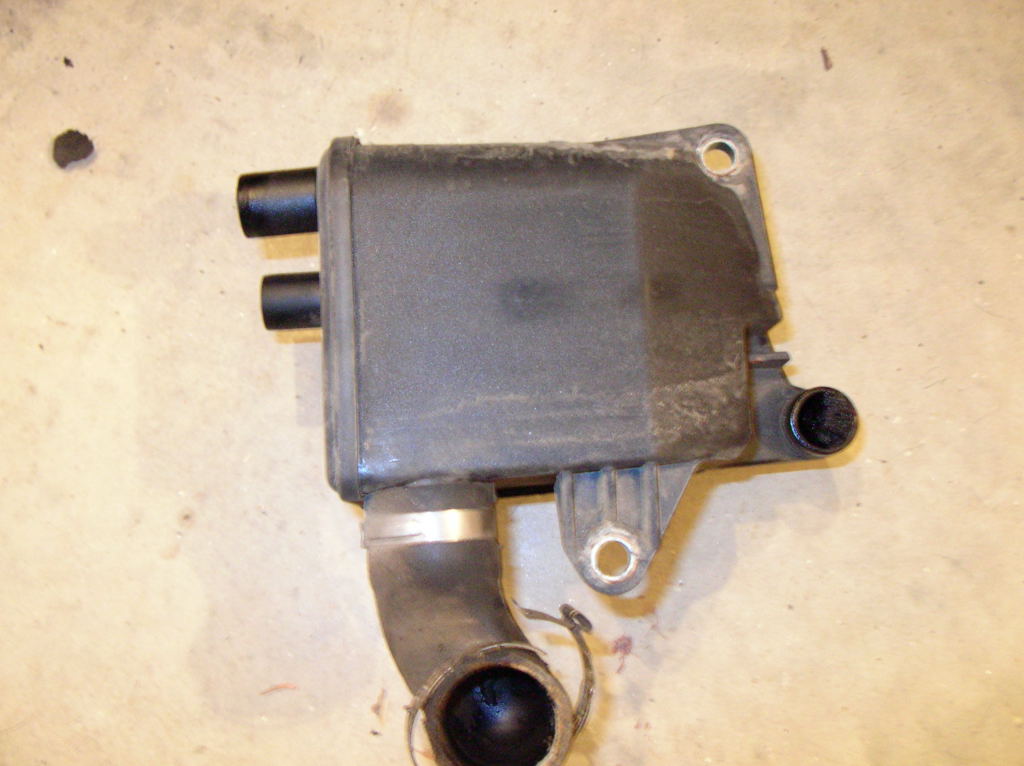

I got this done yesterday. Not a bad job but some things to watch for;
I broke the transmission dipstick off while removing the manifold, it was fun fishing the end out of the tube.
Also broke one of the tubes off the vacuum tree, no big deal, plugged the hole and used one of the spares.
The two screws that hold the fan housing in snapped right off in typical fashion.
Ordered the PCV kit from FCP for the late 95, 96-97 models. Found that mine has the early 95 setup where there is no vacuum line on the right side of the manifold. I ended up having to reuse the old line from the flame trap to the oil seperator as the new one was too short. I looked at my wife's car which is also a 96 and hers was the correct setup.
Anyway, here are some pics of what happens and why they need to be changed.
Also, not sure how or why Volvo found it necessary to take what should be simple $5, 5 minute job and turn it in to a $160, 4 hour procedure. PCV is a simple concept...
