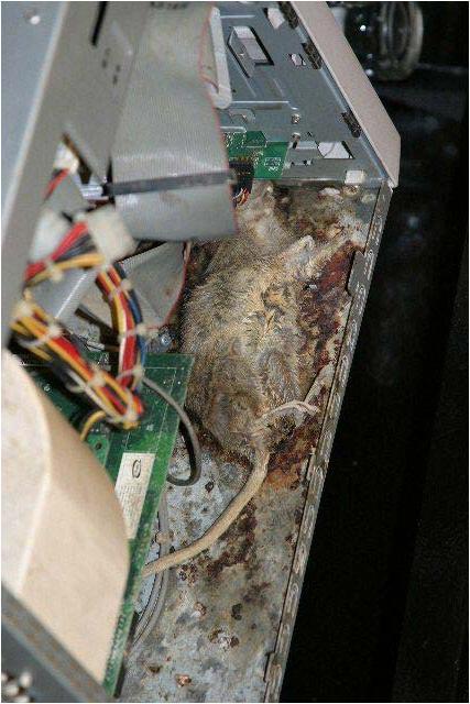

Speaking of problems with rats, I found out why my PC wouldn't work:
