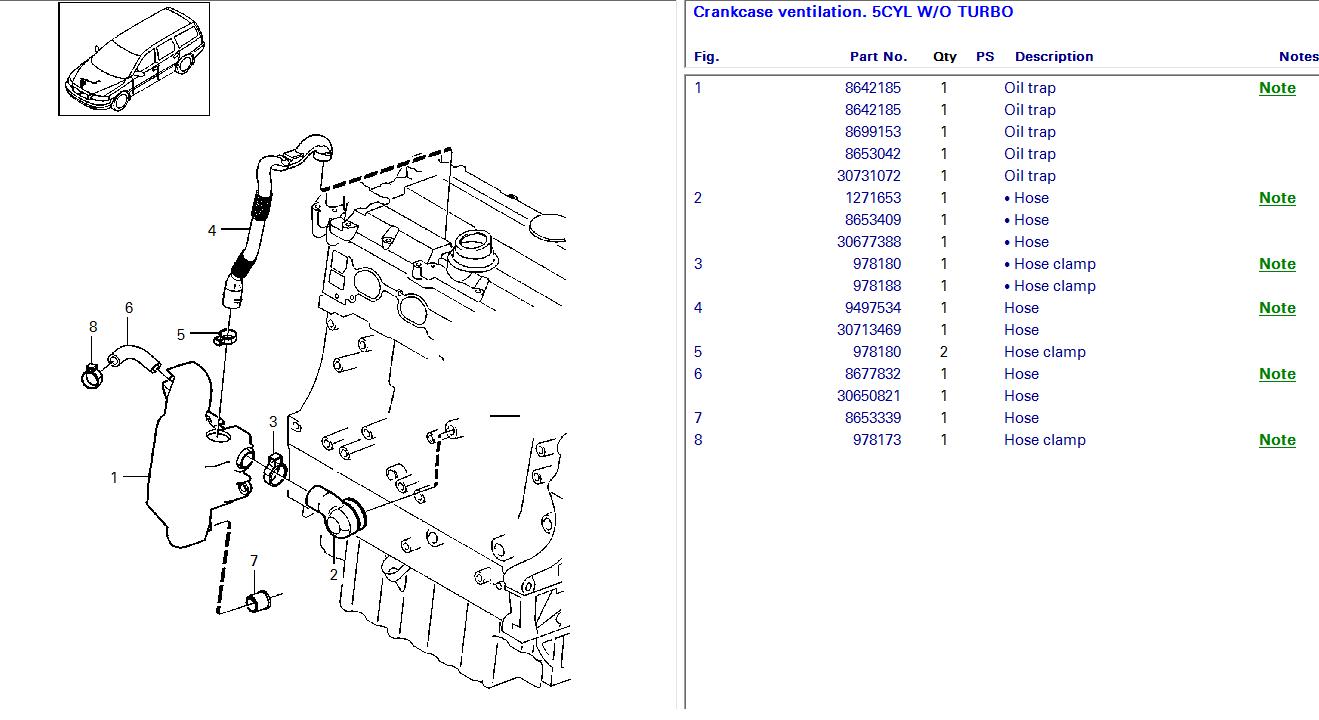

Is there a site which has a drawing of these engine parts and their location on the engine? I am sure that it sound basic, but it would resolve my issue.

No. The throttle body does not need to be removed, but the intake manifold (that the throttle body is bolted to), does, and Volvo recomends that you use a new gasket for that, but I reused mine.The dealer claims the throttle must be removed in order to perform the oil trap repair. Therefore, the need for the new gasket. IS THIS ACCURATE?
This shows the oil trap in the area under the intake manifold:

Although it's for a different car, this link will give you an idea of what's involved in cleaning/replacing the oil trap: http://lakesidedp.com/uploadpics/pcv/
