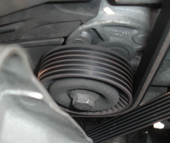

Hi I have a Volvo S40 1.9 turbo 2001, I would like you to help me to identify by means of the picture or video that I am attaching you if this shaking and noise is normal by this spare which I do not know if it is a tensioner of the alternator double sided belt. The shaking and noise intensifies once I turn on the A/C.

That looks like the tensioner. Your video didn't post up. :?:

Thanks you are right is the tensioner... the video I can not load it cause is to big.... the main problem is that this belt tensioner is giving noise and shaking is there any way I could give it some maintenance or do you think I have to replace it..... in that case can you give me a link where to find it and the instructions to replace it?

Are you sure the tensioner is your problem? It could be that one of the other bearings are going out and that variation in tension on the belt is causing the tensioner to shake back and forth. When the AC is engaged additional load is placed on the belt, which causes the bad bearing to "stick" more, causing additional shake.
