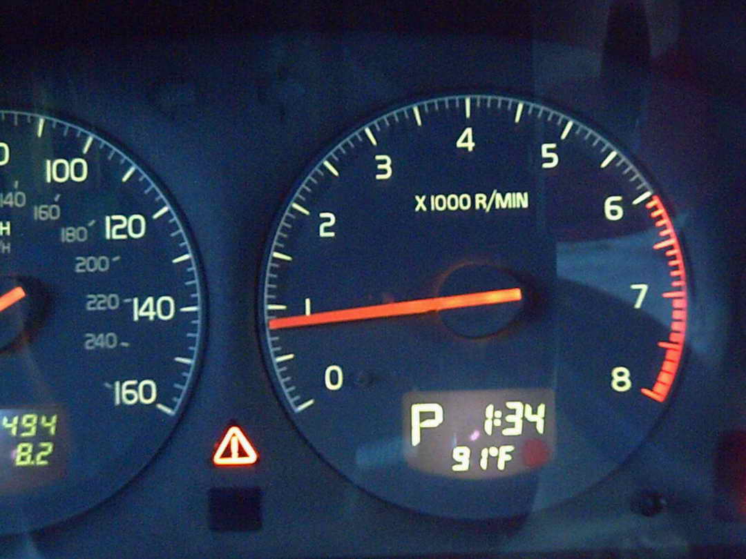

There are 6 bulbs that light up different areas. There is one directly behind the clock display. The bulb assembly is around $6.50. On the S80, there are 2 screws that hold the black plastic shroud around the display. Then there are 4 T20 screws that hold the instrument module in. It pulls right out and the bulb assembly twists out. It took me 30 min for the entire job.
Good Luck
Here is a picture after the repair. The newer bulbs actual look brighter that the stock ones.
Repaired clock light
