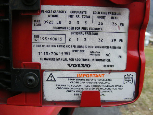

You can also find it printed on the inside of the fuel filler door. Like so. Odd how my car has 16"rims...
