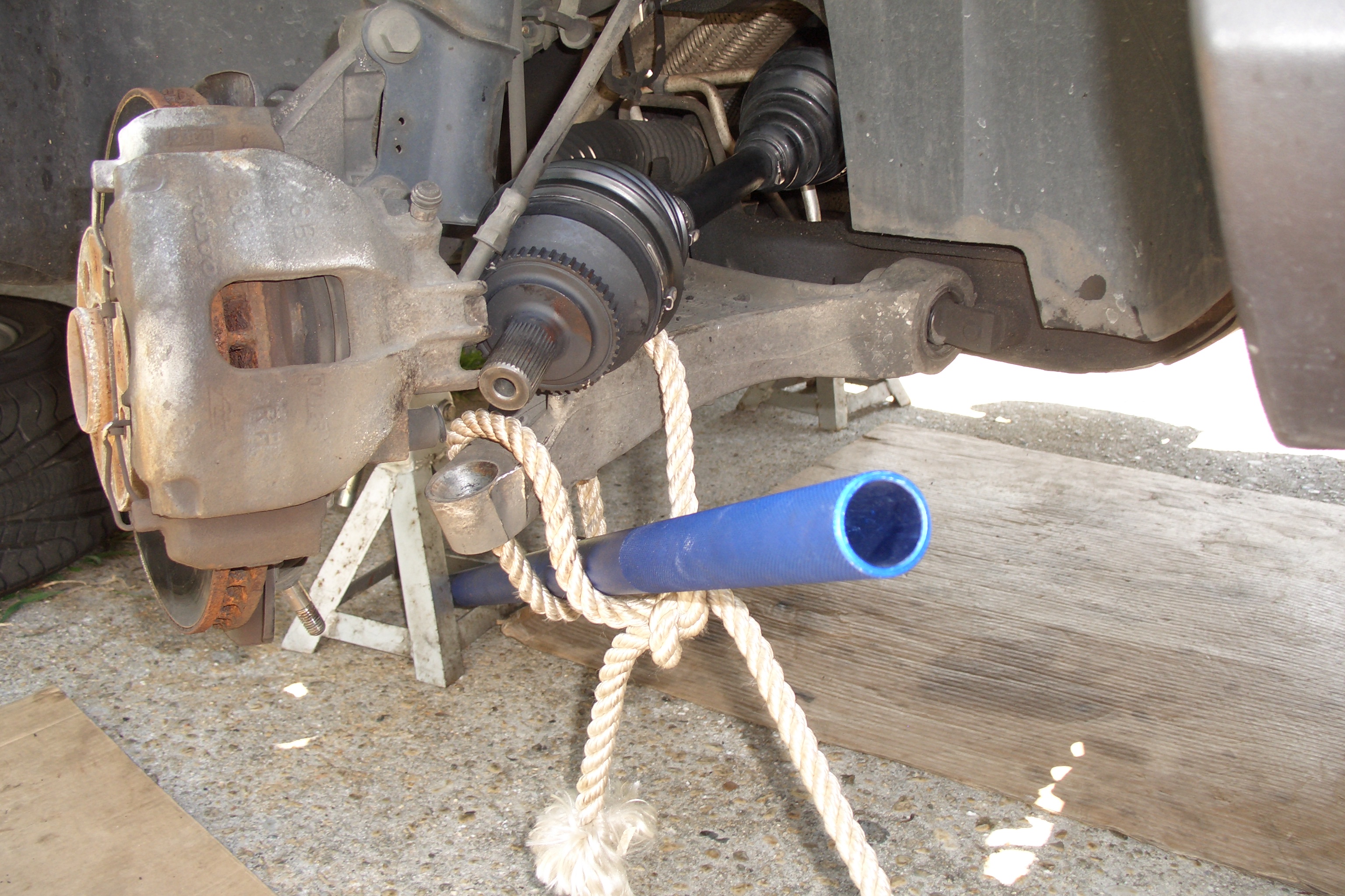

Just replaced both front axles of our 2003 XC70, here is my experience:
First things first: I loosened the lug nuts and the drive shaft bolt with the car on all 4's, safety first. Than jack up the car.
I did not take anything off, but the tire, than loosened the lower ball joints and that gave me enough play to swing the strut out of the way to remove the drive shaft!
The trick is to separate the ball joint from the lower control arm: Thanks to the Haynes manual: Tie a rope or chain around the lower control arm so you can put a long bar through it which slides through it below the arm. Fixate the arm on one side and step on the other side so you pull the arm down. That's the trick the rest is peanuts.
In my setup(see pictures) it ended up being an easy fixation with the end of the jack handle that I use in the frame of the jack stands.
Again, I did not have to take the brake caliper or ABS sensor off or whatever else, it worked like a charm.
The axles I used are also from Axles Unlimited, phone: 704-399-1003. Seems to be a good product and you get rebuild, original Volvo axles. No problem getting them out as with the 'China' stuff!
On a note for all folks that have ft lbs and not Nm indicated on there torque wrench: Torque axle nut at 26 ft lbs, than an additional 90 degrees. For my own torque wrench I used 312 inch pounds(26*12).
And as you might have guessed, I torqued everything with the car back on it's wheels.
Since a picture is worth a thousand words:
Fixation is in the jack stand.
