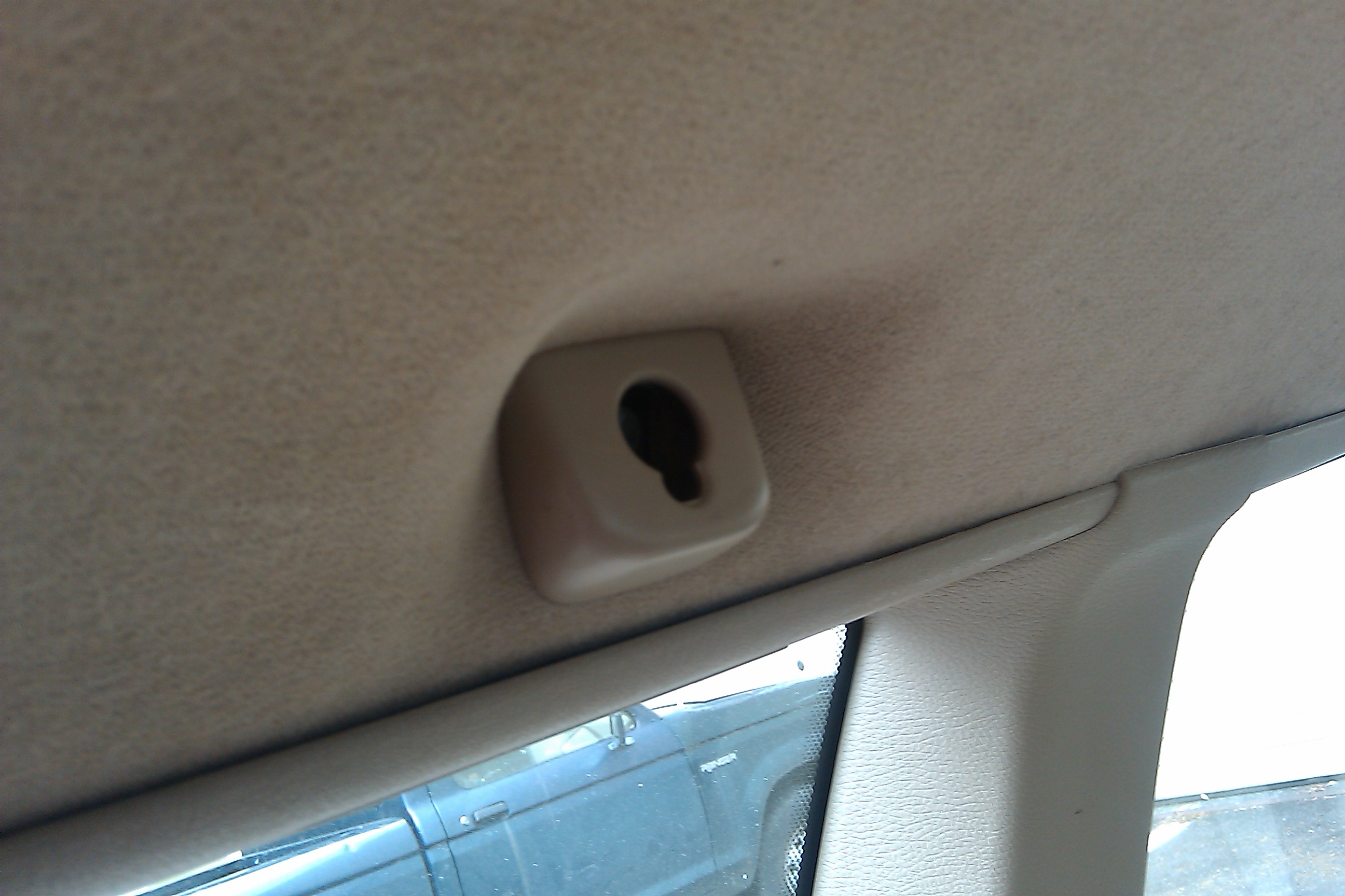

Hello, I decided to change out the seats in my V70 with some leather ones and found that the new rear seat has a net that comes out of it.
Now this net works as a divider and would be great for travel with my dogs, or just to fill up the back with stuff without it spilling over.
However, I can't find the hooks, hangers or brackets, or whatever you call them that install in the roof of the car where the bar from this net would hang.
I bought these seats online from a junkyard in maine, so I called them back and sent them a pic and they told me they couldn't help me, which was pretty s(edited), considering I just bought these seats from them.
I've looked all over junkyards and the internet and can't even find a picture of them.
Can anyone know what this part is called? How about posting a picture of theirs so I can see at least what I'm looking for?
Any help is appreciated.
thanks!

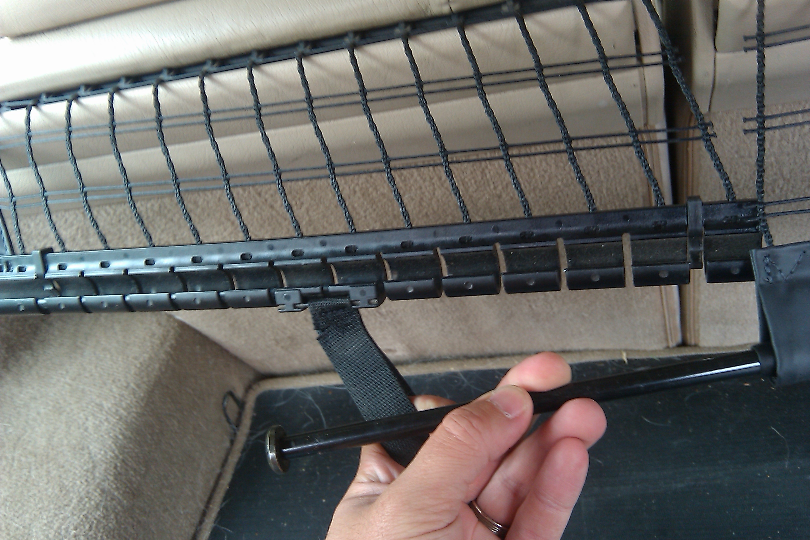

Glad I read this post. I had no idea how to attached the cargo net. I assumed some pieces were either broken or missing when I bought the car. I was wrong I just didn't look up to see the hooks. Anyways I attached some photos for you. There are two sets of hooks, one set above the rear seats and another set above the front seats for when the rear seats are folded down. On the passenger side cargo net a bar will extend out and attach to the driver side cargo net and then attach to the hooks. Hope that helps.

nice pic. one extends out the other kinda clips on to the bar the you insert it into the hook mount on the roof liner. :mrgreen:

Indeed the larger one holds a telescopic bar which can be pulled out.
