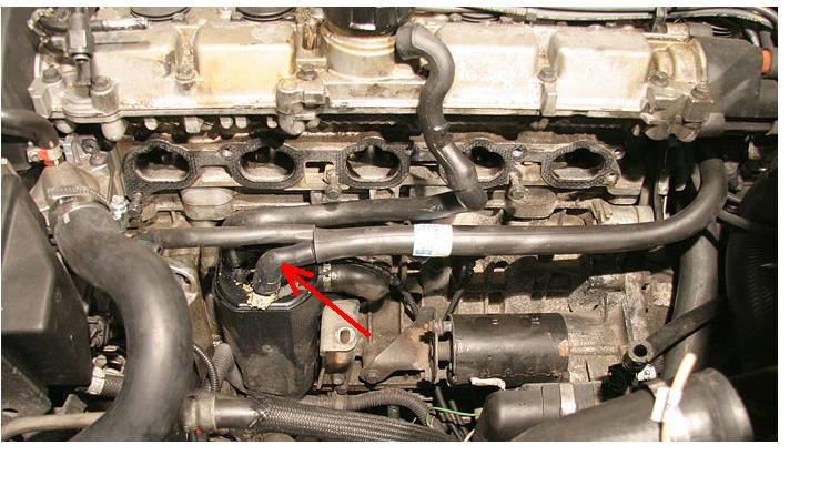

So you mean this Hose here:

That small one on the right side, if I'm not mistaken.

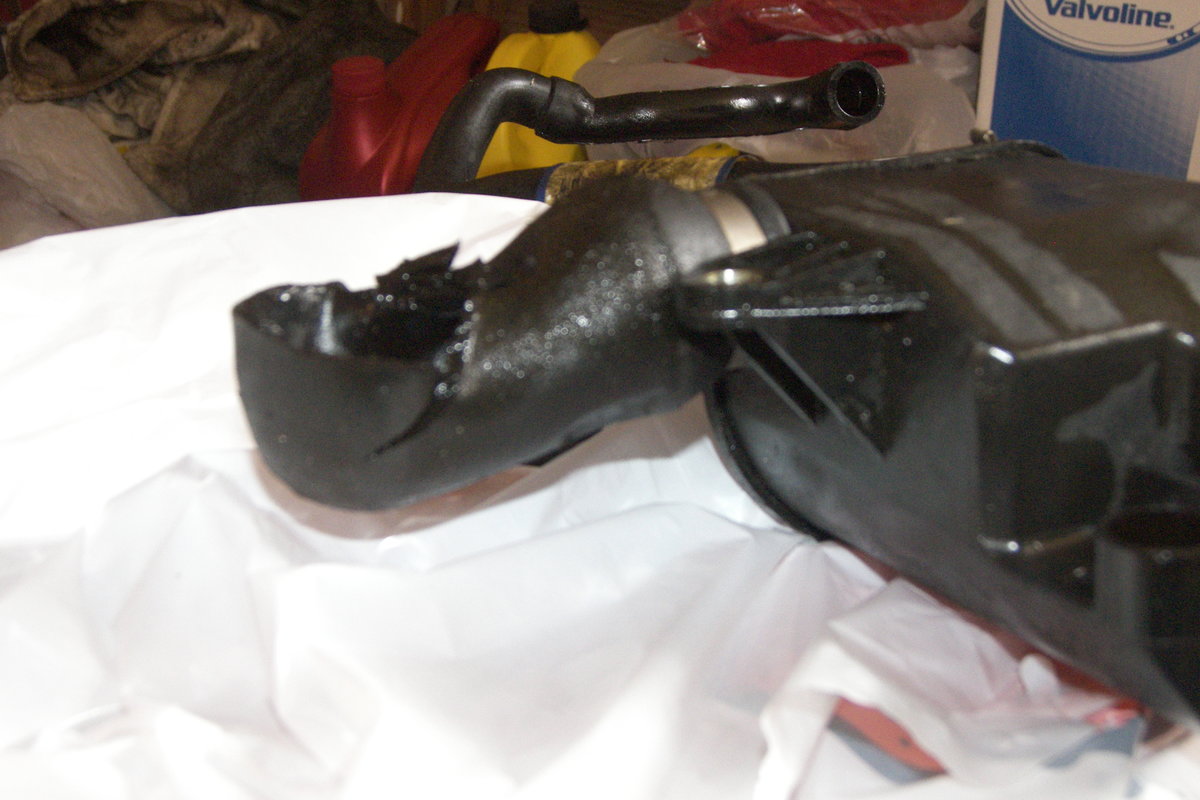

Front of oil trap, as viewed once intake is removed.
Let me try to upload some photos -

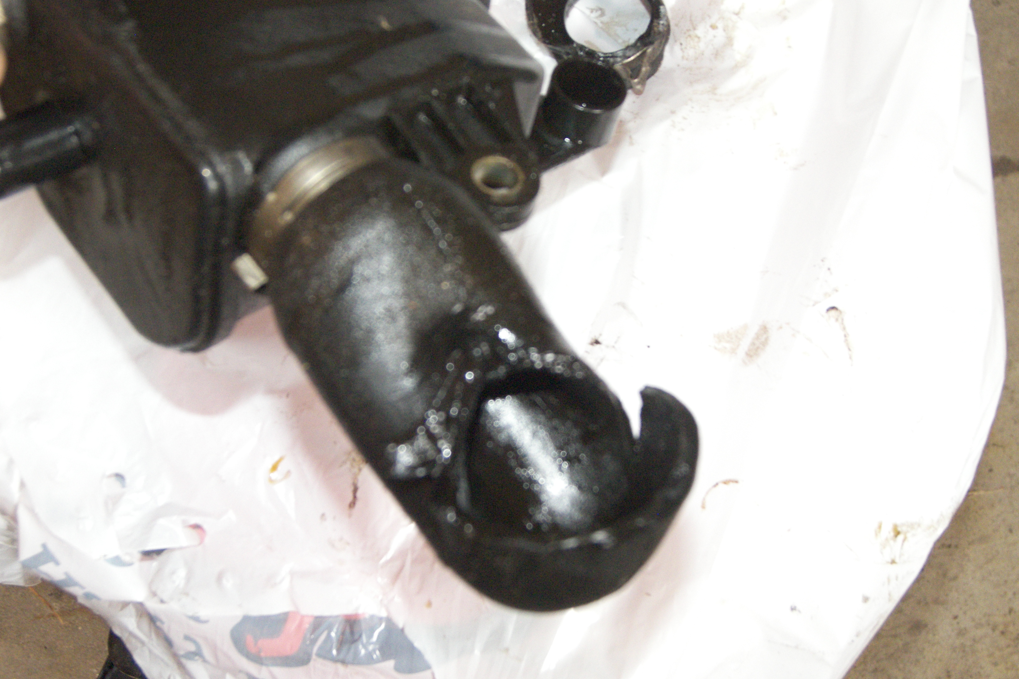

Post by newowner »
One more shot.
Notice enlarged hose and tearing.

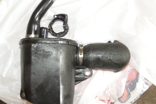

Post by newowner »
I think you get the idea. Please any thoughts as I used the same URO hose again, it was part of the kit I ordered. I hope it makes through the winter.
Enough said - pictures are worth thousand words...

Use ONLY Volvo parts for PCV, They last longer than URO!

You even had the Oetiker clamps on there, didn't you? I doubt it was from them being too tight - that thing just swelled up real good.
That one hose must take a lot of pressure - mine blew a big hole in the middle of it before.
I'd have to agree, for something as hidden as this is, I would only use OEM hoses if I did it again. I used a URO lower radiator hose, and it was leaking after just 3 months of being on there. It swelled up real big right before the clamp and pushed it off the radiator a little bit.
