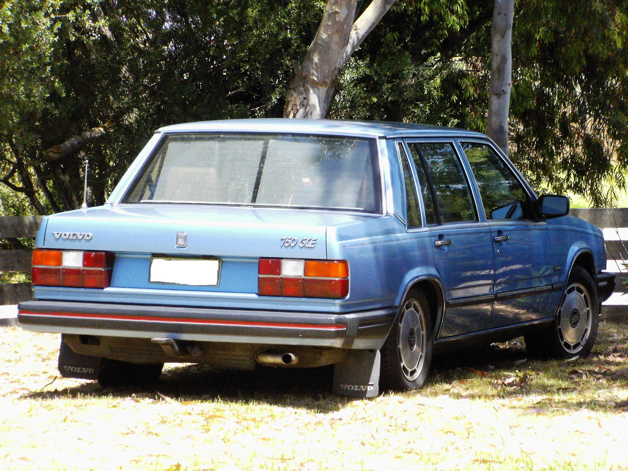

My wife had a beautiful Volvo '85 760 V6 (240K miles) whose only problem was a leaky radiator and a sagging rooflining.
One day my wife neglected her daily top-up duty and presto we had a massive overheat and a blown head gasket.
I miss her awfully even with the Douvrin V6 :
