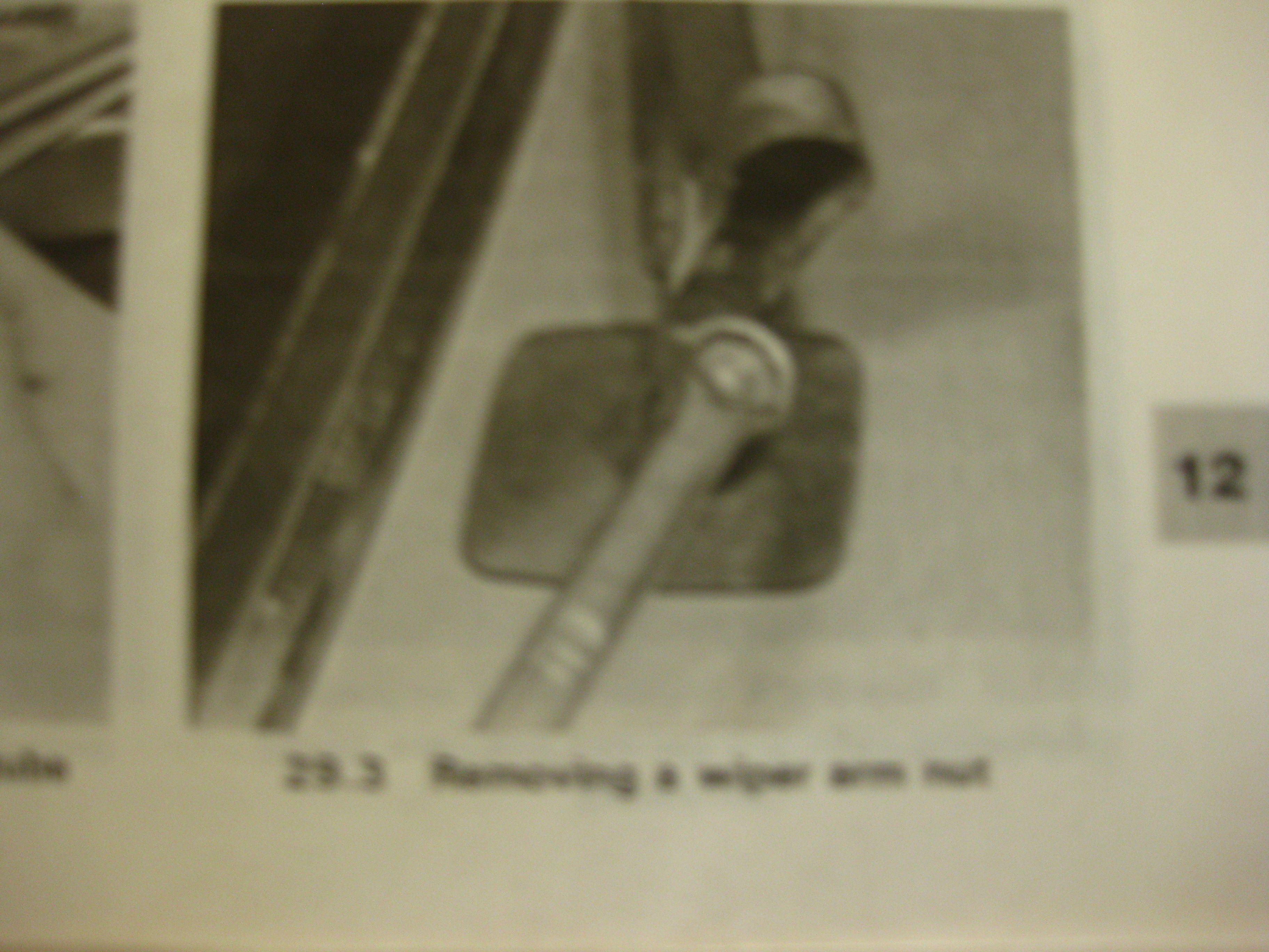

You should have a single nut nut on your wiper arm that may be hidden by a trim piece on the arm itself. Once the arm is removed, you should reinstall the wiper arm in the correct orientation. The splines should be the teeth all around the shaft from the wiper motor that the arm slides onto.
