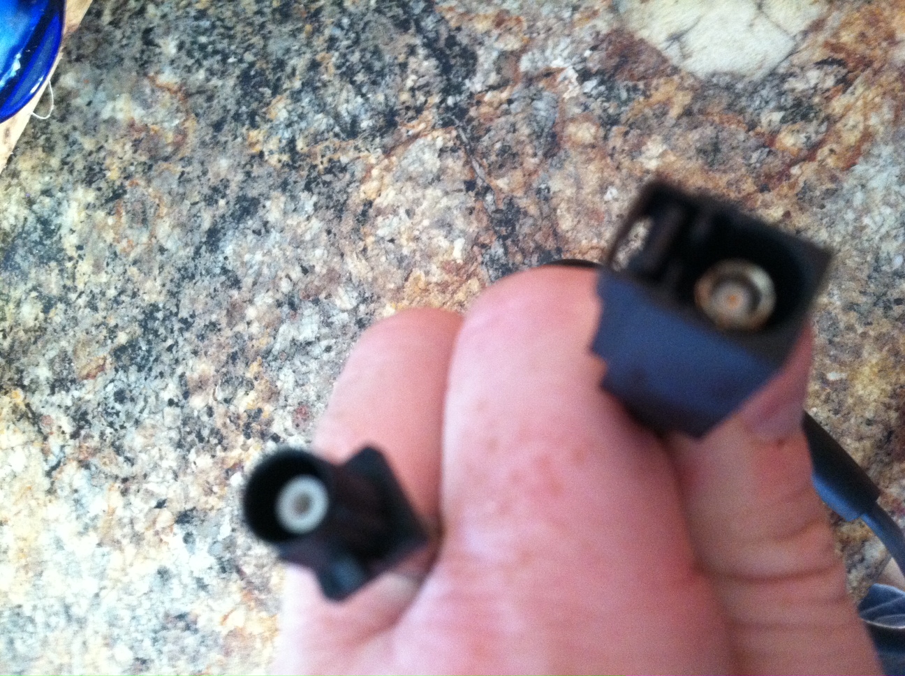

Thanks Jimmy57,
I have attached a photo of the cables I have. I hope to do a full write up with pics, for future reference.
Does the head unit have to be pulled? Do the newer cars have a radio code like the older 70 series cars. I finally mastered the older 98-99 70 series cars. Now were onto the 05 S50 and a 04 V70r. Im sure ill have to wire the ipod to the 70R after the S40 is done.
