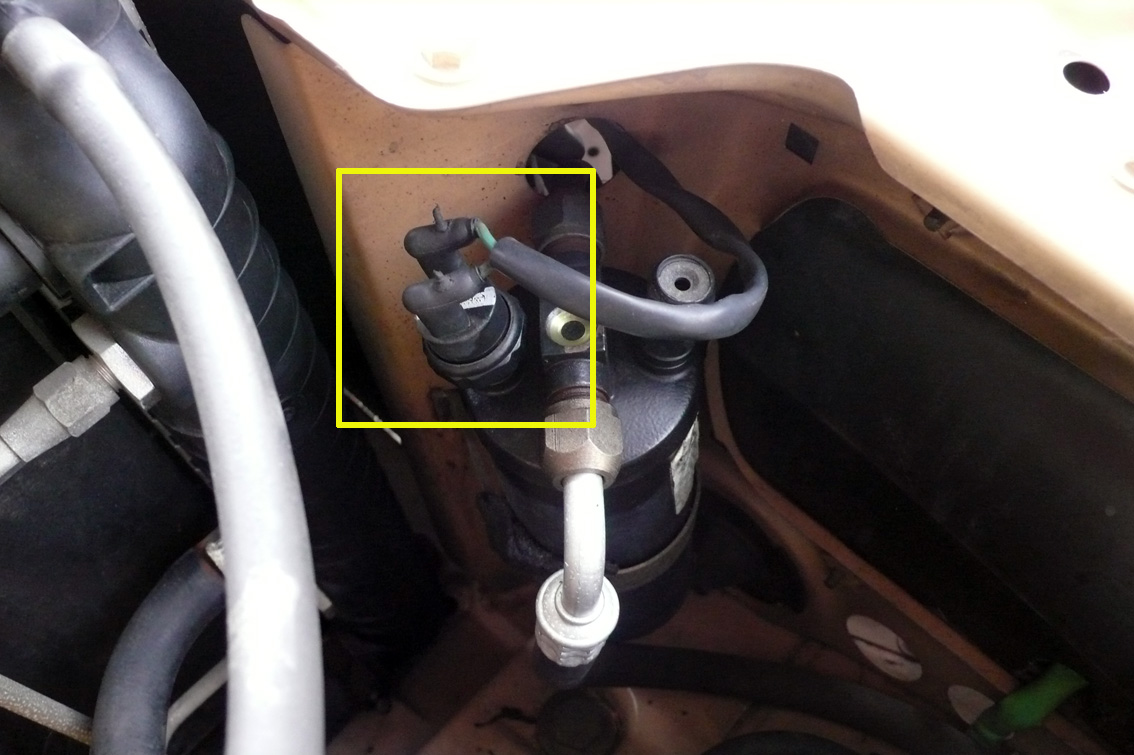

I believe one needs to bypass low pressure switch which I am thinking is on the receiver drier as photographed?

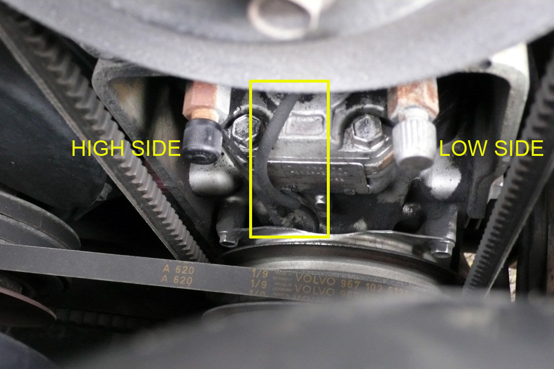

Photo taken from front of car. This image also shows the high side (small diameter hose) and the low side (large diameter hose) of the compressor on my 242DL as there are so many posts asking for this information. See hoses behind compressor in the picture above.

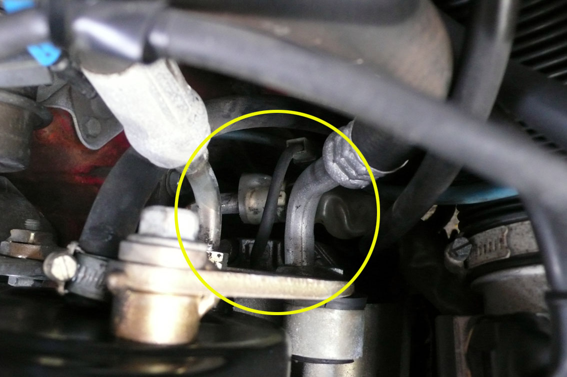

Behind compressor
Behind compressor
volvo242dl_behind compressor.jpg (144.89 KiB) Viewed 410 times
Receiver drier. This is the low pressure switch.

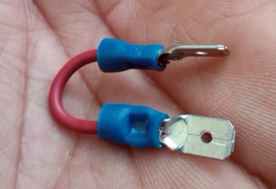

From some research the pressure switch basically needs to be bypassed. The pressure switch is protecting the system so the refrigerant needs to be filling one the pressure switch wiring is jumpered of bridged. I assume I would just bridge the wires that connect to the pressure switch to run the compressor to pump the refrigerant / oil through.
Simple relay jumper.
