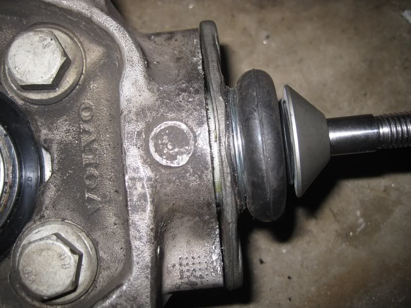

So after reading may threads on how to install lower ball joints I got all the require stuff and started the task. Well everything went well with getting the old ones out but when it came to getting the new ones in I could not get them totally down all the way on the one side. Even after tapping them back out and trying again it would stop at the same spot and would go no further.

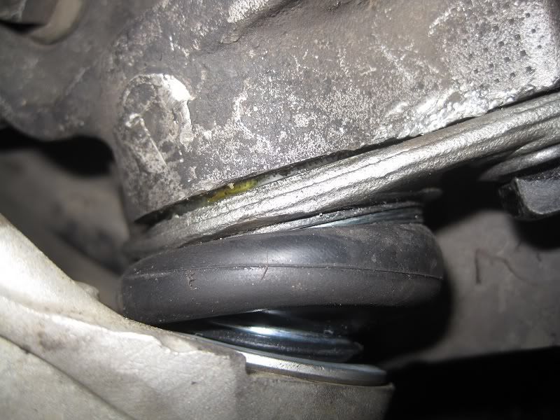

Here are some pics of the drivers side which I reinstalled and the passanger side which I still have out. I was wondering if they will work themselves the rest of the way flush or should I just take them somewhere with a press?
They are snug little buggers, that's for sure. Good photos by the way.
I recently did this task and know exactly what you're talking about. One thing I noticed when installing them is that when you first start them into the hole, it helps to rotate the ball joint one way or the other just a tiny bit so that you feel the knurls align with the grooves that were left by the old ball joint's knurls. You just have to be sure you don't rotate it to the point that the bolts holes won't align.
Also, the mistake I made was to assume I could use the bolts to pull the ball joint home. But the "ears" are too soft and will bend up as you tighten the bolts. It appears from your photos that that is what's going on in your case - the ears are bent and hitting home before the center part is all the way home. Either you tried as I did to pull it together with the bolts, or you wailed on the ears with a hammer. Once I realized what was happening, I pulled the ball joint out and with the aid of my bench vise I bent the ears back to where they belonged. Then I re-installed them (aligning the knurls and grooves) tapped them home using a hammer and an old deep socket that I didn't care about any more. I placed the socket in numerous different spots around the base of the ball joint as close to center as I could get, yet being careful not to damage the rubber bladder. Be patient, working around and around different spots on the base. Once it's home, THEN install the bolts.
Well I finally figured out the main reason why . The grease I put on them was causing it to hydraulically lock and not allow it to go any further. Once I tapped it back out and cleaned out all the grease it went right in with no issues. I did decide based on advice from a few others that I didn't redo the on the drivers side since it was pretty much down but only a very tiny bit and pretty much flush.
