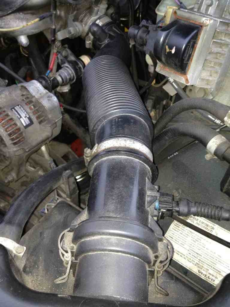

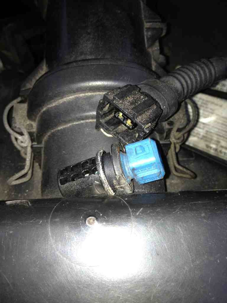

Thanks for the info! I really ought to take my idle air control out and clean it. I notice that I don't really have what looks to be the normal MAF sensor though. Mine is very small and looks to be a standard intake air temp sensor. Kind of weird. Anyone know anything about this? Please let me know. Thanks again. What a great forum!!

There should be a MAF meter to provide the air mass and air temp signals to the fuel CTRL system; it is usually located on or after the air box. There is also a Manifold Pressure Sensor on the intake.

Yea, my car is kind of different from all the pics I see. The only thing in the entire air boot is a small two wire sensor. Nothing like the MAFs I've seen on other cars?? Trying to attach a pic. Took the IAC off and cleaned it out. We'll see tomorrow if that fixed the cold idle searching.

Take that back. It is a temp sensor.
