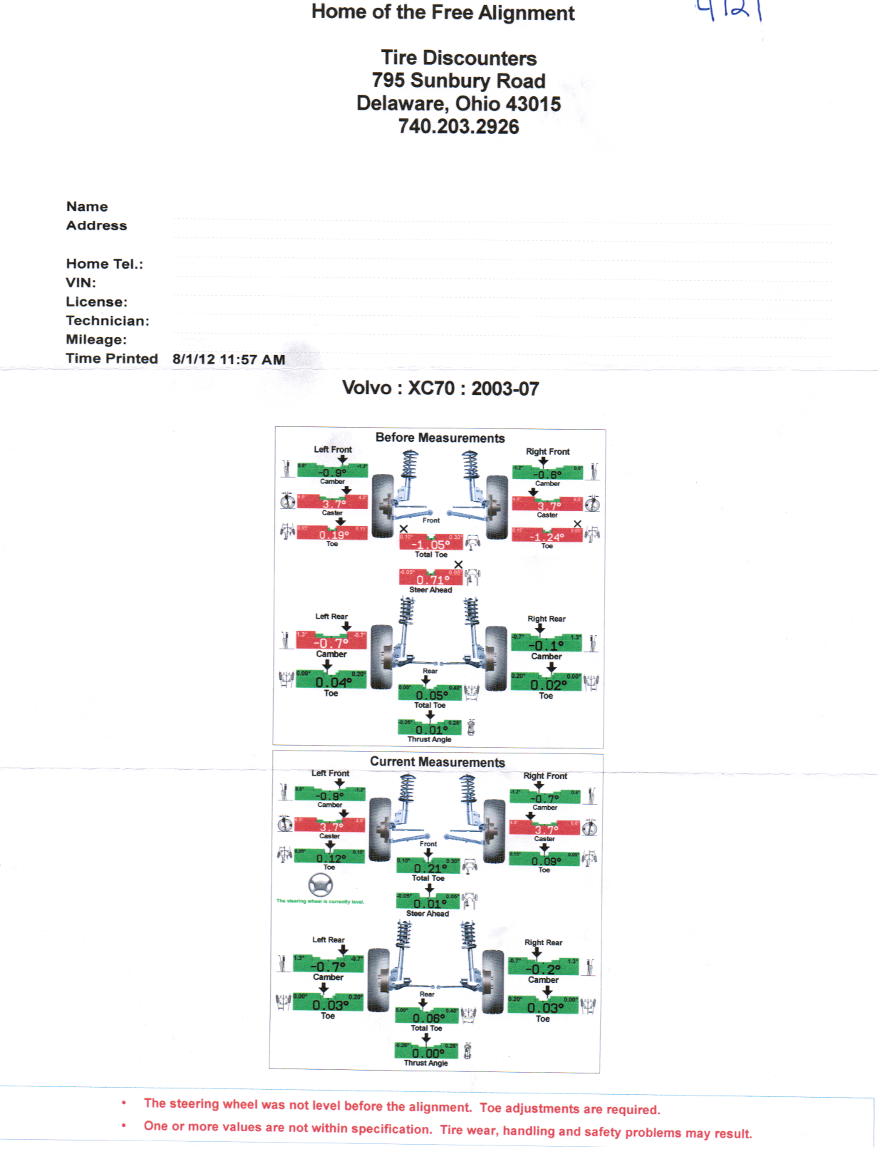

Can you Post the before and after Specs? Tread pictures would be helpful also.

I've attached the alignment values, let me know what you think.
We are going to rotate the tires (front to back) after lunch to see if this has any impact on improving the front end, and the goal was to inspect the tread but again (the alignment guys) said they saw no concern with the tread.
