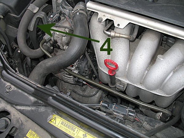

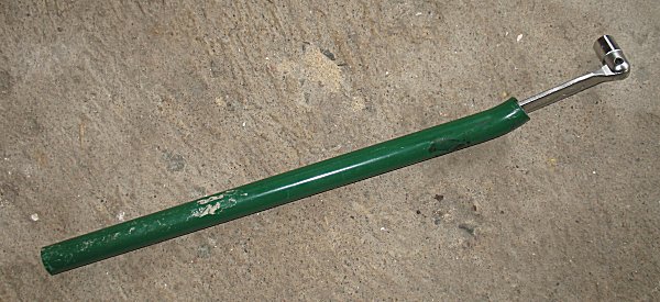

Hi,
I got a red battery light and the 'El. system service urgent' message a few days ago. When idling the battery voltage showed 11 volts, indicating a problem with the alternator. After searching this forum I concluded that it would be worthwhile to try and resolve the issue by replacing the voltage regulator alone, before going through the trouble and cost of replacing the complete alternator.
In my model 2001 V70 (150k miles) I didn't find the space to easily remove the whole alternator, so I changed the VR module with the alternator in the car. I unscrewed it though, just to make access to the VR easier. It's probably wise to put a piece of wood on the AC compressor (located below the alternator), to have a gentle surface for the alternator pulley to rest on. In addition I unscrewed the power steering pump (but kept all tubes attached) to get better manoeuvring space. The broken regulator was Bosch F00MA45229, the replacement module F00MA45211. I also got a new auxiliary belt.
Most difficult part was to put back this belt. I managed as follows:
Remount and tighten PS pump and alternator, and route the auxiliary belt (see Haynes) but leave the top pulley (PS pump) free.
I made an extended #14 hinged socket wrench by removing the #15 socket and putting that end in a steel pipe: Unhook the tube to the PS pump (1), and move it to the side (2): You can now insert the wrench down from the PS fluid reservoir side and fit it over the tensioner pulley bolt (3). (this picture is from after the work was done: the auxiliary belt is already in place)
By pulling the wrench all the way towards you there will be enough clearance to work the belt over the PS pulley. You can hold down the wrench with your elbow and still have 1 1/2 hands available to work on the belt - no further tools required.
Check that the auxiliary belt is routed correctly and fits correctly over each pulley. Also check the clearance of the PS tube guide over the belt (4). It can easily have bended downwards while working on the belt: Everything works fine again on my vehicle! 14+ volts when idling. I hope this can help someone else in the same way this forum helps me in keeping my car alive.
Frank
