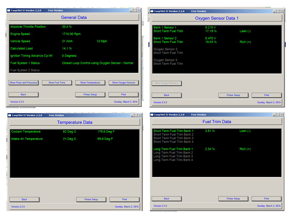

I had good luck connecting the Dell laptop with the Interfuse USB-OBD2 ELM327 interface cable that I bought on eBay. I used the free Easy OBD2 software that came with the cable. It was easy to set up and connect. I used COM port 3.
I took some screenshots of the live data that I was able to capture while connected to the running car (wife was driving).
Live data screens available with EasyOBDII and the Interfuse ELM327 USB cable
Screenshots of EOB2.png (162.09 KiB) Viewed 3248 times
Overall, it was a great deal (only $10 delivered) and it seems to work pretty well for reading codes and live data.
