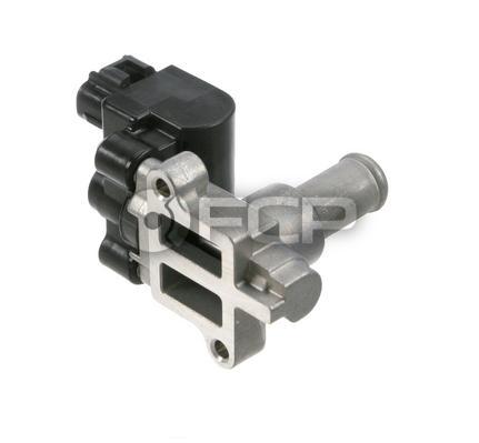

You're talking about the Idle Control Valve. Photo from FCP below. Other than standard cleaning I'm not certain how it comes apart.

Oh. I meant unscrewing it from the hose looks like it requires a 5 lobed torx, T17? But I can't find anything with a T17 sized head.

In that link the poster refers to security torx...5 lobed torx that require you to purchase yet another special tool.
The poster also simply ground a slot into the head to take a standard screwdriver, btw. 10 minutes work with a Dremel.

5 sided security torx are usually sold by Snap-On dealers. That's where I bought my Toledo set from for around $20. Call one in your area and they will let you know if they stock one.
