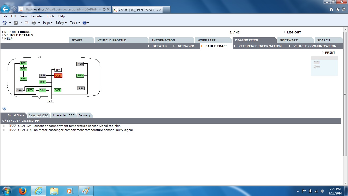

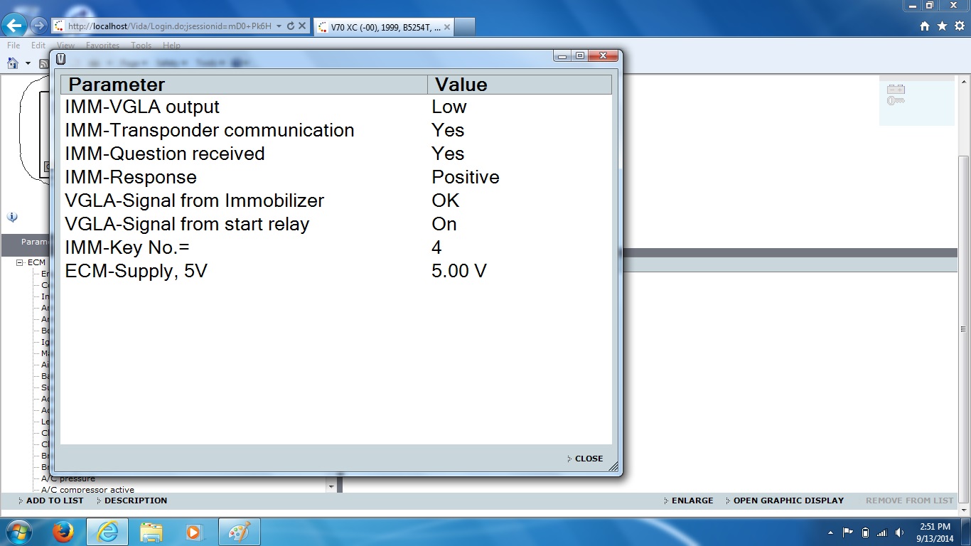

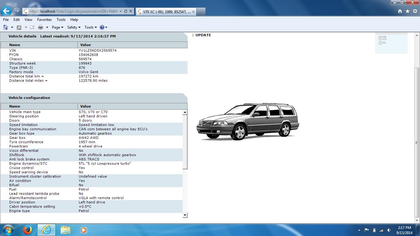

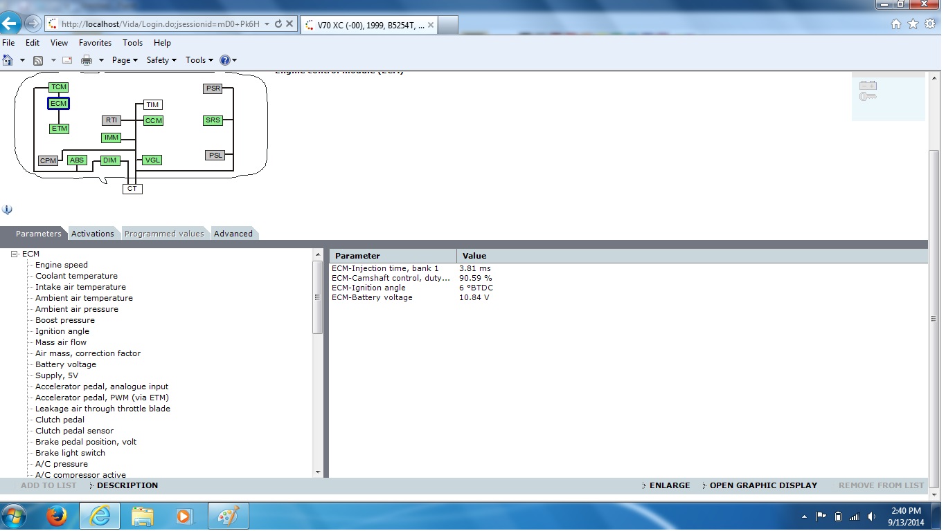

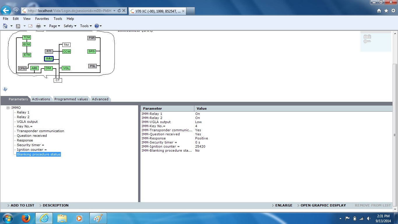

I have some screen grabs of the VIDA diagnostics as they apply to the IMM, the VLGA, and some information from the ECM.
The injection and ignition timing screen was snagged while the car was cranking but not starting.
I noticed one other odd thing that was not consistent. After some time (as in 20 or 30 minutes) with the door open the relays on the VGLA modules start to click and the dome lights cycle from off to bright through a dimming cycle. This happens (both the relays and the light) at about 1.5 second intervals.
The antenna ring is brand new, the connections look clean on both the antenna ring end and on the IMM module end, and I gave both ends a shot with CRC contact cleaner. On several occasions though the car does act exactly like it has a bad antenna ring in that it will fire and immediately die.
The car always cranks, at least until I manage to run the battery down and then I put it back on the charger overnight.
Once again, it seems when I pull a spark plug and lay it on the head with the coil, and it doesn't seem to matter which one, the car will start pretty reliably. I did find some solder globs around coil number 2 but I think it was some sloppiness from splicing the wires to the CVVT valve which looks like it was recently changed. Recent is somewhat relative as I think this car had been parked for over a year at the repair shop where I bought it.
I have changed both the number 1 and 2 coils with known good replacements. The spark is orangish rather than blue with the spark plug laying on the cam cover.
I never could hear the deadlocks engage after the door was closed and locked.
As far as the signal and relay states and signal states go I don't know if some of them should be opened or closed, low or high. They don't seem to change between the starting and not starting conditions.
If anyone sees something on the screen grabs that stands out please let me know.
