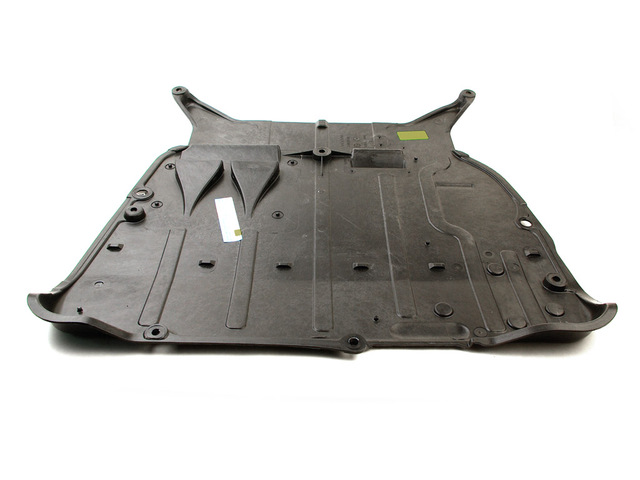

- The new under engine protection pan I ordered from RMeuropean for $135.
- engine_pan.jpg (66.39 KiB) Viewed 1199 times

Sometimes people just take them off and never put them back on. They're pretty durable, mine (from a 2000 also) doesn't seem to have cracks or anything, but it is plastic so I'm sure it's possible to just rip it off accidentally
Don't quote me on this but I *believe* IPD might have an aluminum pan that bolts right on
And the fuses/relays are at the back of the engine bay nearest to the driver, they don't typically have issues with moisture but it's probably worth at least opening the cover to see what it looks like
I'd spray the starter, alternator, and ETM connections with a bit of wd-40 just to displace the water

It's a good idea to let the alternator dry for a while (if weather permits).
The plastic shield is good in situations when going over debris on the street, so components such as power steering lines don't get damaged.
