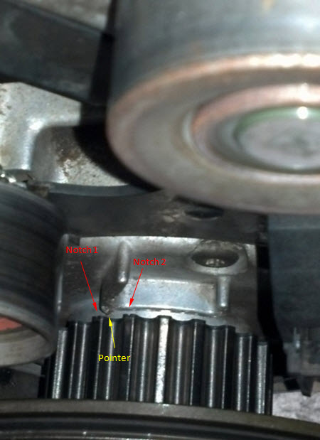

Just removed the old timing belt and found the crank is off by one tooth. Crank is rotated clockwise too far. Both camshafts line up correctly in the notches on the cover. Anyone know if I can rotate the crank back (counterclockwise) one tooth to get all marks to line up? Re-install the timing belt and test? Do I need to step through some procedure to make sure everything is correct?

I want to know the answer to this question too. Is the relationship between crank gear and piston positions one to one. By that I mean, it does not matter how you turn your crank, once the crank gear get back to the same spot, the piston positions should be exactly as they were before.

#1 The timing was off. Turned the crank counterclockwise one tooth and installed new timing belt. This time I made double sure the 2 indents on the teeth were on each side of the pointer after turning engine over 2 full revolutions. This is very difficult to see if the crank pulley is left on. Attached picture shows what it should look like
