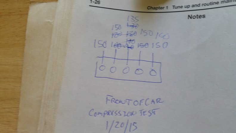

I also have this thread going on "1997 850 glt Serious Engine Smoking Upon Deceleration", which is what lead me to turbo replacement. Which has lead me to this, I Think at this point I have done nothing to the motor or the turbo......Hum.....
The good, it so much fun to drive, it looks great and handles well. The interior is good, I replaced all the parts that didn't work, the auto claimant control, all buttons, knobs and lights. I've replaced the PVC kit, Radiator, Transmission,both drive axles, lower a-arm. Alot of new stuff over the last year.
But all is saved! If I get a motor and turbo out of a pick a part car!
I think I should be looking for a turbo/2.3 liter now,does anyone know which cars had these? or is there a better combo.
I think I could get both of these and rebuild a little better and really have a great car.

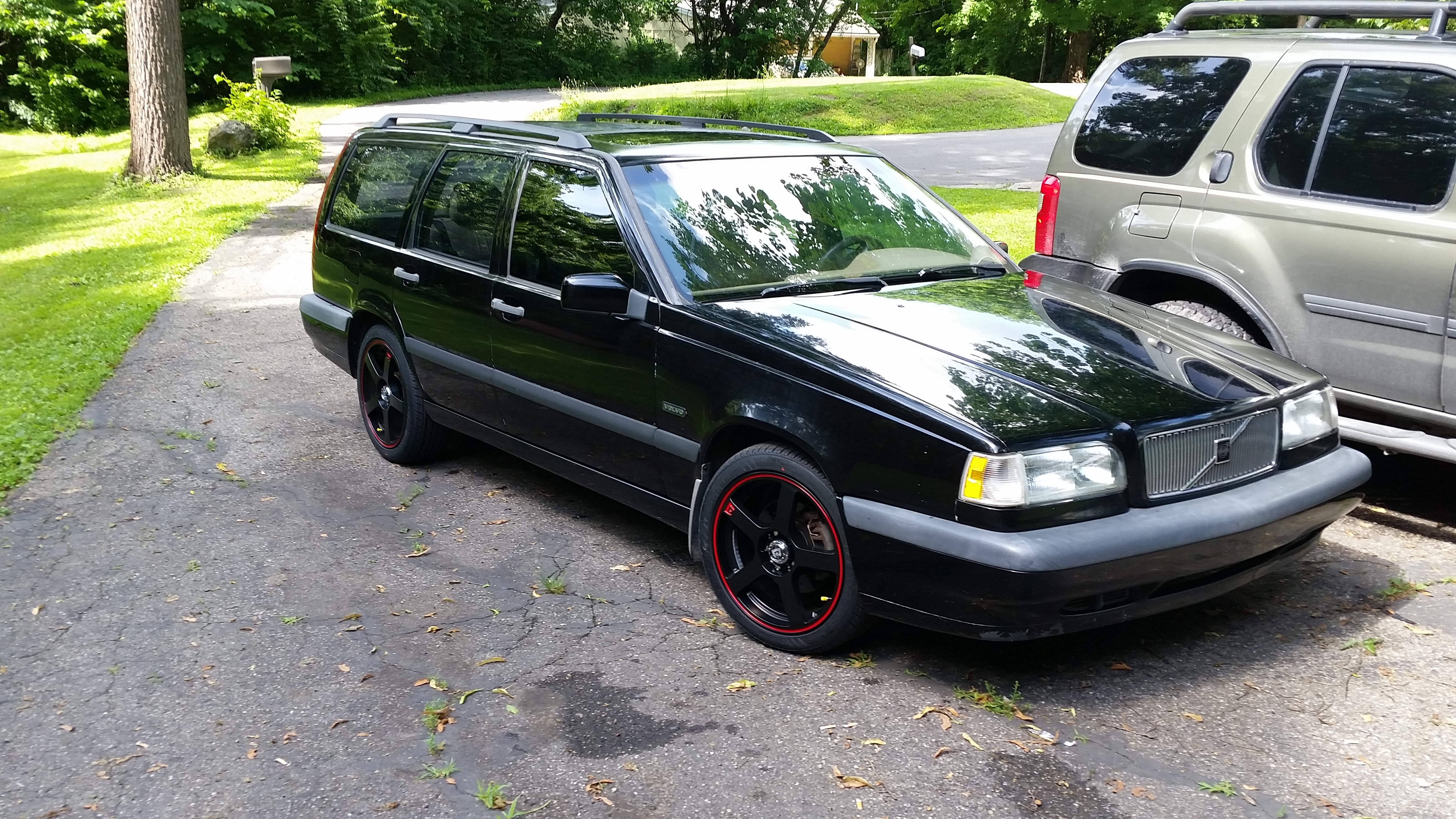

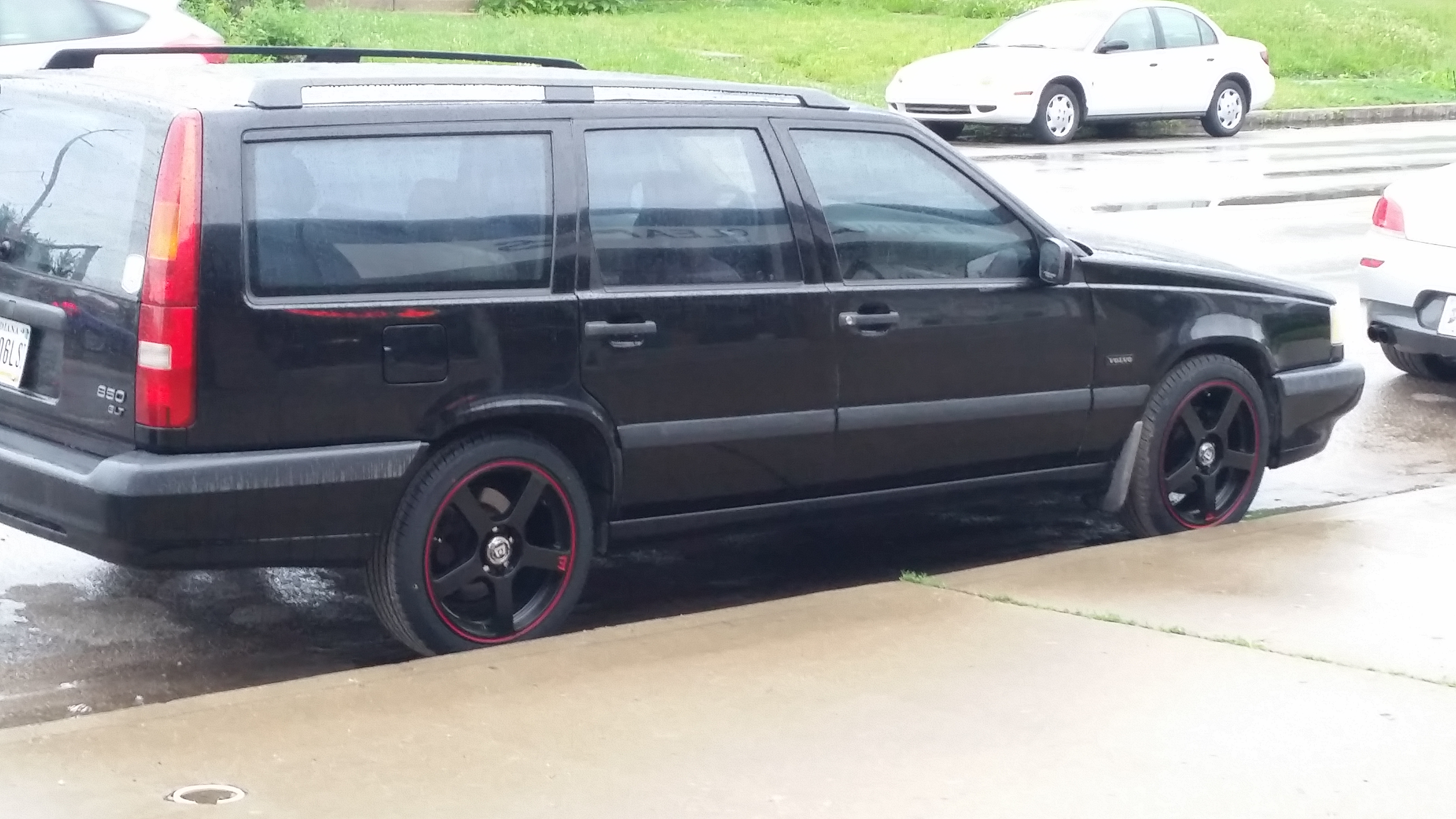

You and I need to be friends! I also own a 1997 850 GLT Wagon (but mine is red), and I've been debating a turbo swap and the exact rims that you bought...1ezliving4ume wrote:I'll check that thread out, thanks. Here a couple of picture with her new shoes on. I need new shocks and struts so I think I'm going to purchase the lowering kit from IPD. 1.5 in the front and 1.0 in the back.
