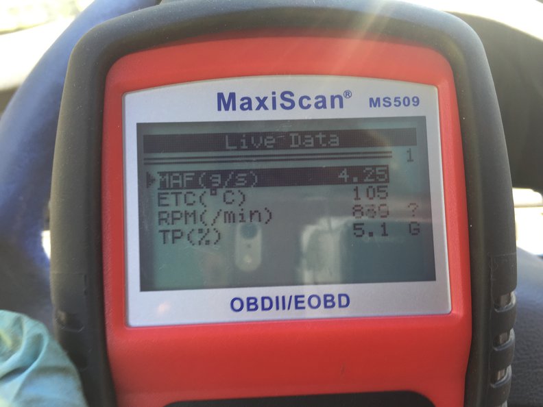

- Posts: 36148
Here is some data from my T5 2.3 liter turbo engine. I think 2 g per sec is low... I recorded 4-4.25 g per sec
