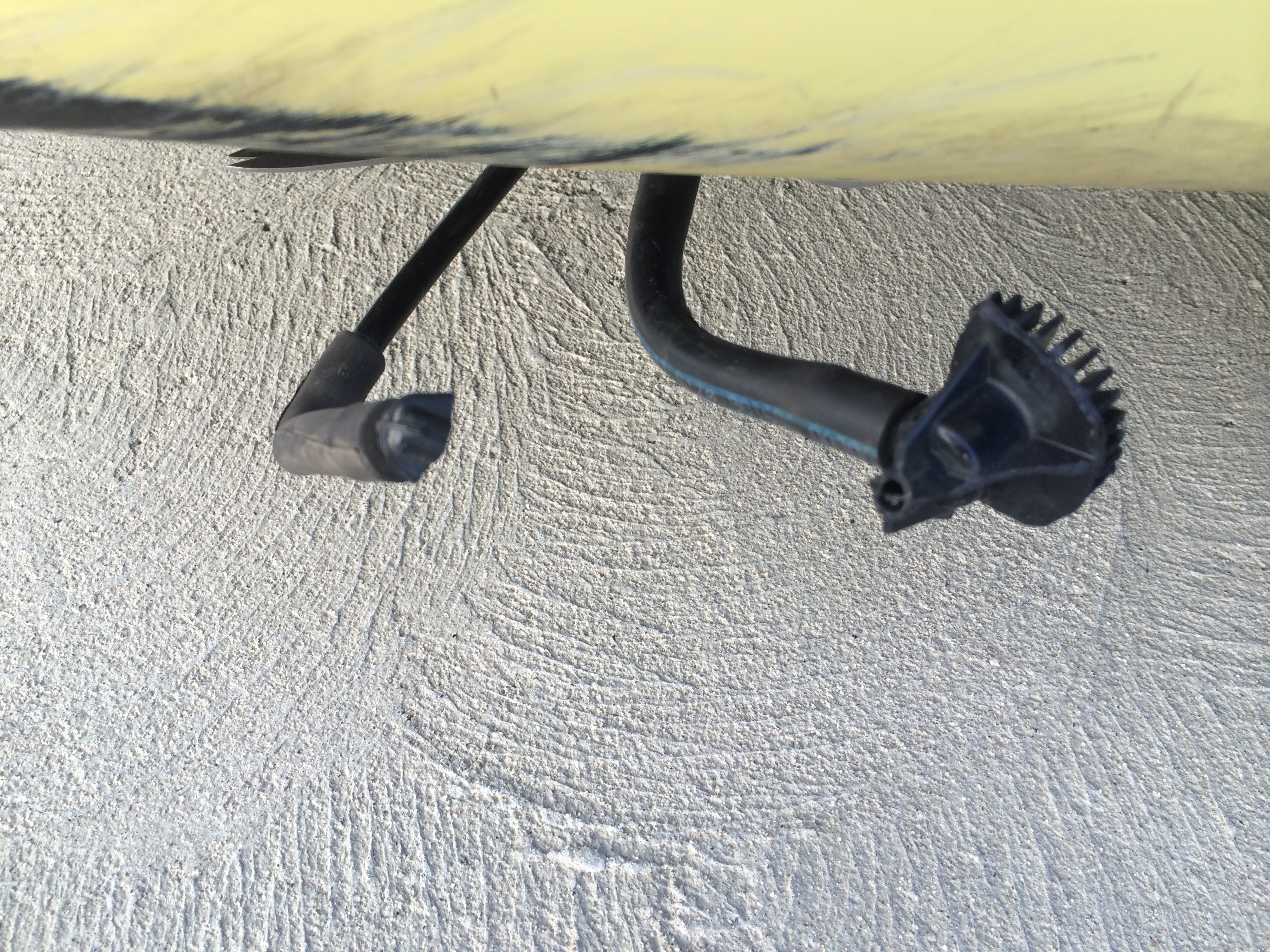

The evap canister has fallen off our car. The photo shows what was hanging just above the ground. I don'y want to replace with new if possible but whether new or not, I'm having trouble determining which canister is a correct replacement because there isn't much left to go on and because of the emissions code on the vin #. The code is "1".
Does anyone have any idea how important the emissions designation is? There are several: 0, 1, 2, 4, 5 & 6.
Would anyone have a part number for the canister that belongs on this car?

The best I can tell from Vida for a 1995 T5R running a B5234FT motor there is only one choice of canister and its part # is: 9135101. This looks like it was used on most turbo 850's from 95-97. I'm not 100% on this as it shows it fits my 2000 'R' and that is rubbish as my car and all AWD S/V70's I believe have their filters fitter at the rear. Certainly mine does and it is rectangular and not round. Part number should be correct, but to be 100%, check using the VIN# and ask your dealer to confirm the part #.

The emissions designation is the 8th character in your car's VIN:
