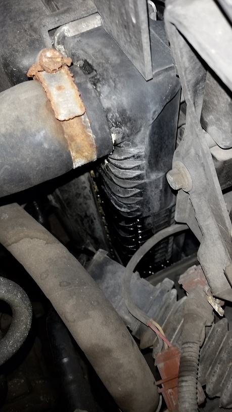

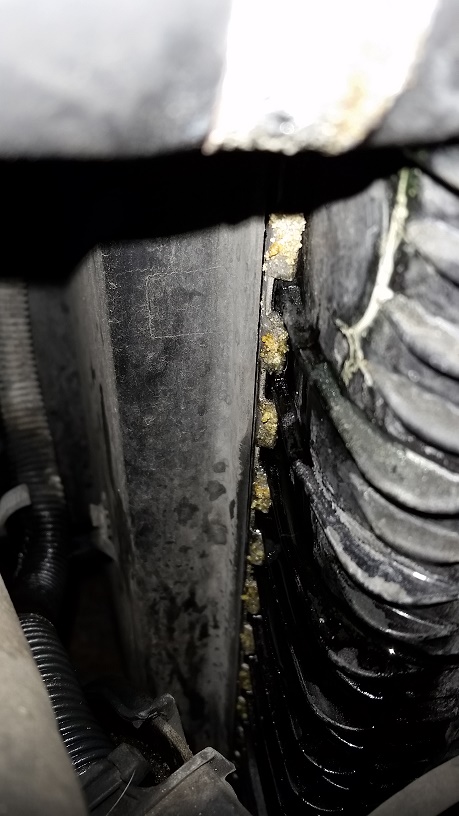

Does this look like I need to replace the radiator?

My research says this is a common leak on 850s. Going to be ordering a new rad and transmission clips now I guess...

Unfortunately yes. The radiator takes more strain at the top as the engine torque puts more strain on the top hose area and the plastic/metal portion fails.
First check it isn't just a failing/hard top hose.
If it is the radiator, change the top hose with a good quality item (NOT URO/APA), especially if using a none OE radiator as they don't have the metal insert in the upper outlet and tend to not seal 'round' so an old pipe will not deform to make up the gap.

Seems to be seeping out between the plastic and metal portions. Top hose is sealed up. Will I need a new bottom hose as well or just the top one? Was going with the nissens brand radiator from fcp.

Make sure you replace those rusty clamps.

I would also take a look at the motor mounts. The engine sinking puts pressure on that upper radiator hose cracking the plastic radiator. I used Volvo brand on the radiator and the hoses.
