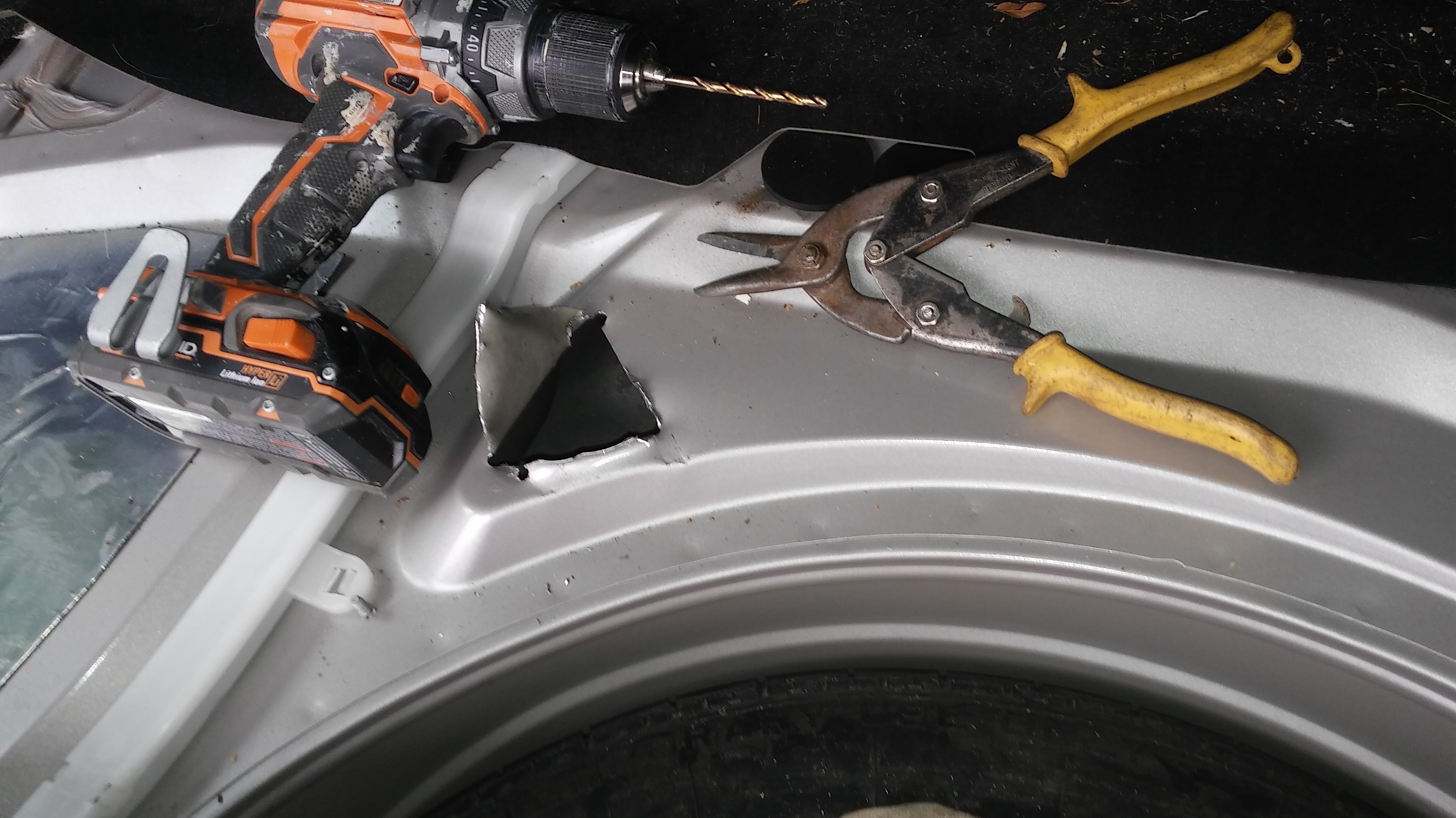

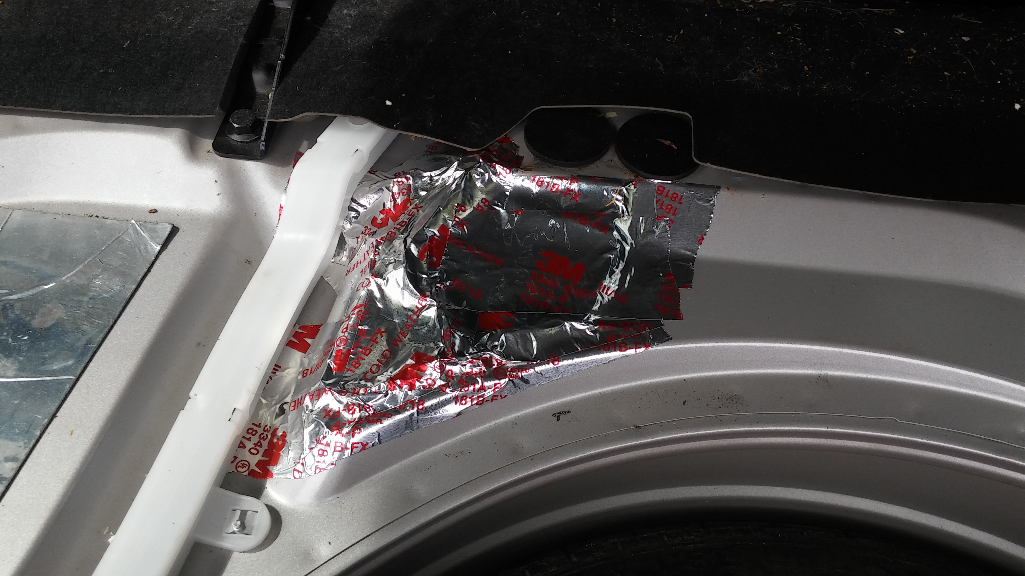

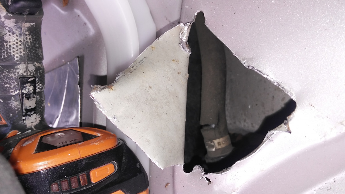

I had the pleasure of changing my J-hose today on my 2001 XC70...After I read the post about cutting a hole above the rear axle, I kind of freaked out. But after weighing all options it was the only way to do it without dropping the rear-end. I only made one hole ( it was bigger then pic, in folds), and with patience I was able to pull off the hooked end (using a bent flat head screwdriver) of the hose tastefully from the underneath. Attaching the new j-hose by using wd-40 as a lube, I slid on the hose from underneath then snaked it to my opening . It took me an hour and 1/2 for the total job. I cut my hole with tin snips, it was so quick and easy (drilled a starter hole). After I was through, I used exterior window tinned exterior tape on my hole. ( I cut it in folds, so I could re-close the hole tastefully).
