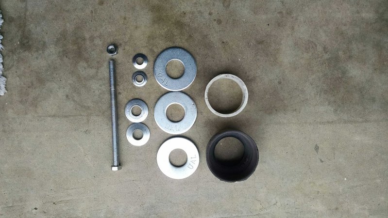

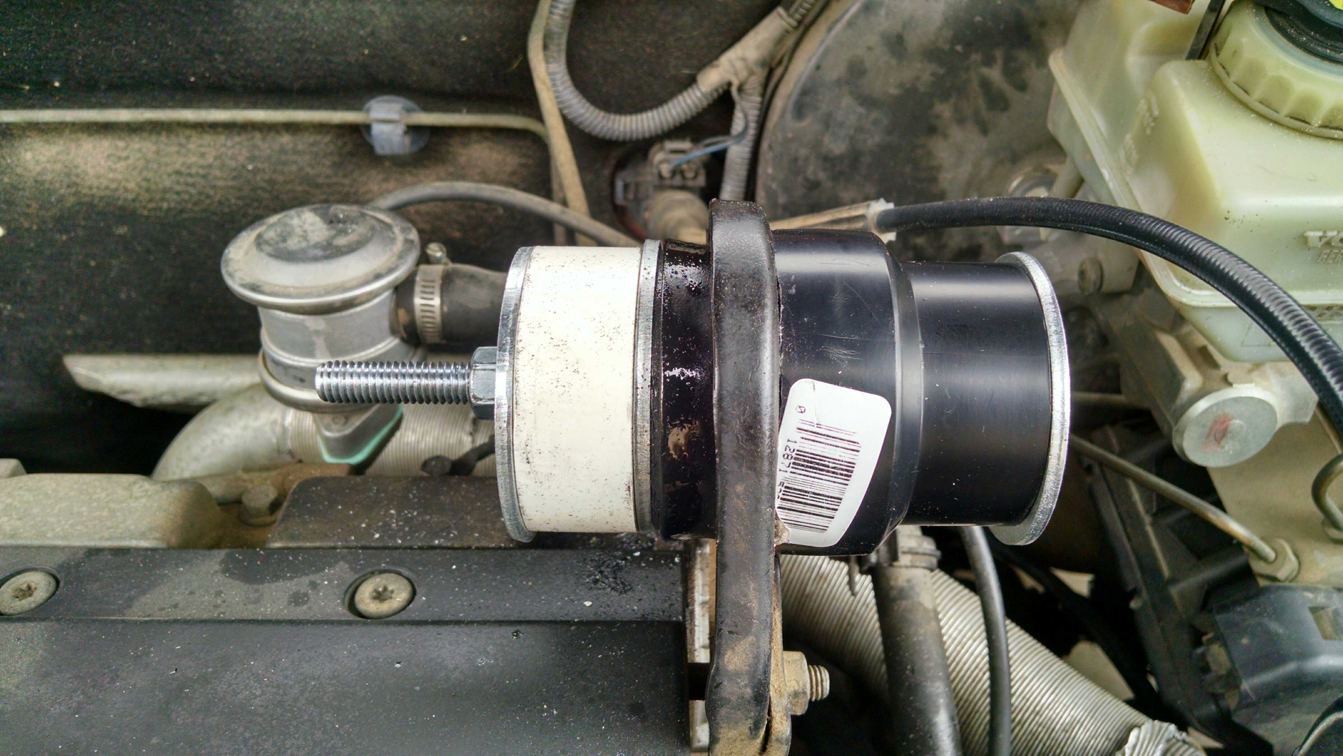

I made this tool from 2 inch pvc pipe, a two inch pvc reducer, 3/8 5inch bolt and washers. I pulled the busing in from the passenger side using a lubricant like wd40 as I slowly pressed it in. Worked great. I had to use my dremel with a round sander to make the opening large enough to fit over the upper mount as shown in the pic. I posted earlier - 96 850 engine mount question. Hope this helps someone else!
Volvo Upper engine mount installation tool I made Topic is solved

Yes, I put mine in for a couple of hours, not sure how much difference it made because by the time I had my tool made it was not cold. Good Luck and as long as you have a tool to press it in, it is and easy job. I did take the bracket completely off rather then forcing it out of the way. Just remove the bottom nut and pull out the bolt. Comes off easy.

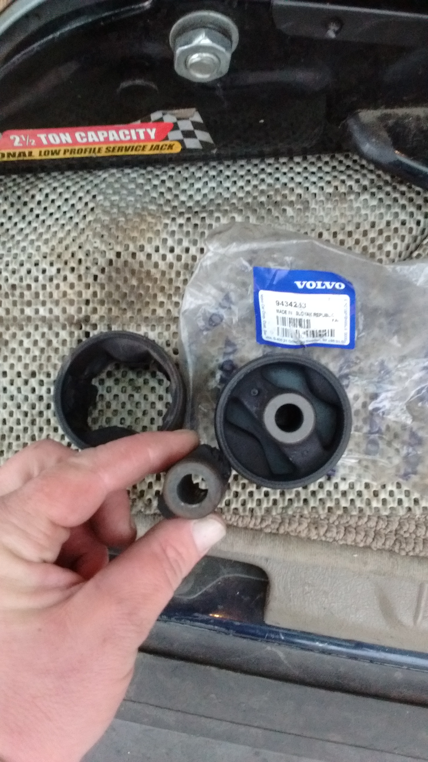

Here's my old torque mount next to new OEM mount
